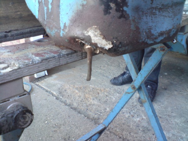

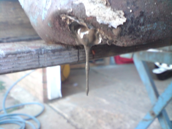

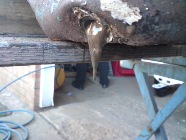

      Well the story with the engine is that it came out of the car today ready for the bay to be painted and I remembered that it hadn't been drained, so we took the plug out and fantastic, absolutely clean, clear water. Unfortunately it was the sump we were draining and we were looking for oil and not water
      After a couple of minutes of the engine p**sing all over the drive the water stopped, and what can only be described as 30 minutes of gut wrenching diarrhea ensued

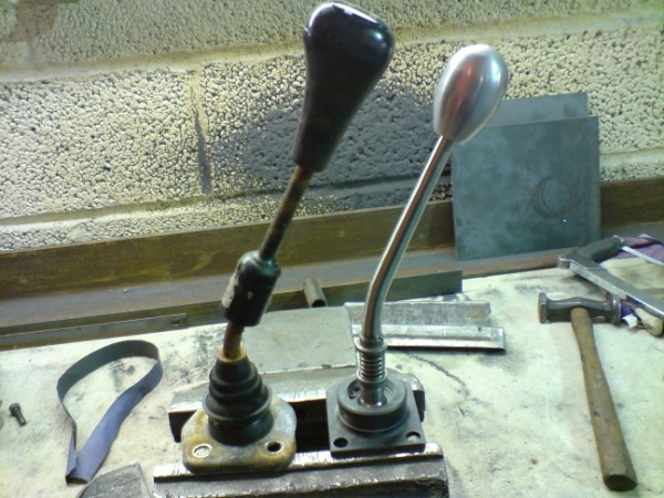

                  Right after modifying the seat mount to get a nice driving position the other day we noticed that with the wheel, pedals and seat all working nicely together the straight 'escort' quickshift was a bit of a long reach for me. The std type 9 and t5 sticks in a sierra are angled backwards and not straight like the quaife stick.
                  Luckily i know someone who is always more than willing to 'bend for a friend' so after a quick trip to Harlow and a couple of cups of coffee we managed to get it like this.
                  Std sierra type 9 stick on left to compare the angles

                          The stick is simply a quaife item. It was stripped down and then bent with several tonnes of force in a press with grimaces on the faces of those within a metre radius of the action
