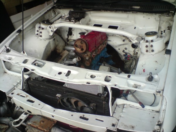

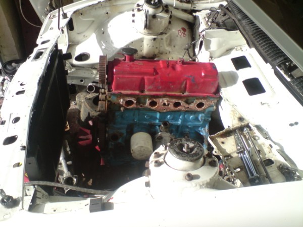

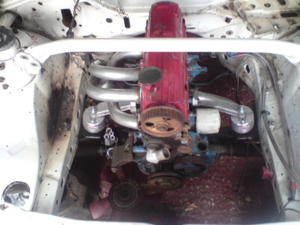

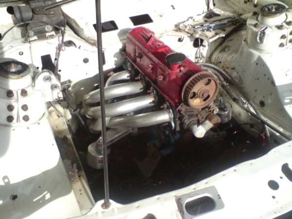

            I found that the type 9 I'm fitting is around an inch and a half shorter than the T5 but I want to use the cossie prop.
            I therefore set about moving the engine back the 1.5" to compensate and by happy coincidence the engine sat perfectly up to the bulkhead and the ashley manifold bought from burtons on saturday now 95% fits, which for an ashley manifold, meant for an escort, is feckin amazing
            The engine is all bolted down on its mounts in this position and apart from a couple of small dinks being needed in the manifold to clear the engine mount and the column its all happy. Hopefully the ally bellhousing will have enough space (once I get one) and its all sorted
            I also fitted the cossie rad which sits nice and low and where the std intercooler would go I have put a 13 row oil cooler. The remaining gap will be for induction and blanked off where not needed.
            My kenlow from the zetec install in the escort also fits lovely so all of these bits are now mocked in place. Should be loads of room for a dry sump tank to sit with minimal pipe runs to the pump

                    it just occured to me you might be able to gain clearance for the steering shaft by knocking the shaft further onto the rack
                      #25
                      I think 2 things I am doing will solve it. Firstly I will probably lower the angle of the column anyway as the seat will sit quite low and far back, and secondly even the thickness of a head gasket will make a difference as the manifold is only just touching the column and the head is sitting straight on the block atm.
                      I may have to make a little dink in the manifold just to clear the mount on that side though, its a tad tight now and is stopping the lower part of the manifold lining up with both top pieces
                        #26
                        sounds good, although there will probably be more than the thickness of a head gasket skimmed off your head and block
                        that said a simple washer under the O/S engine mount wil soon offset any problems there
