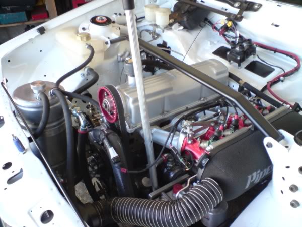

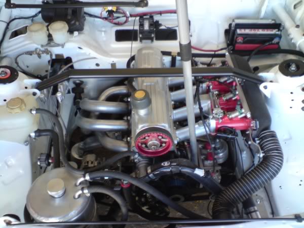

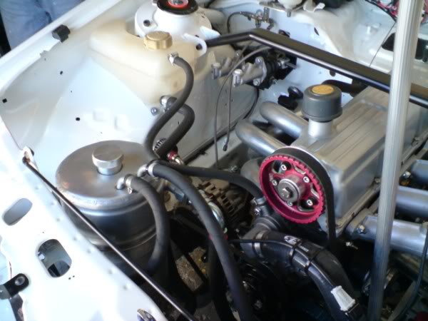

            right daves computer is still being stupid, so he has emailed me these pics and asked me to post them for him, i wasnt there when this work was done, but i will try to explain what is in each pic
            dry sump tank mounted, it is mounted at the front for shorter oil line runs and so that it gets airflow around it, preventing the need for and oil cooler and keeping cockpit temperatures down .

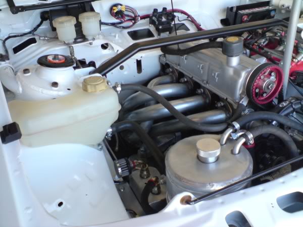

            header tank mounted up in position and plumbed in:
            another shot of the engine bay, showing where everything is, not the brake pots mounted.

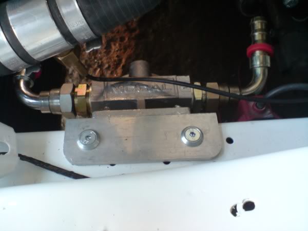

            remote oil filter mounted up:
            hope this is o.k dave?
            nice work lads
            thanks Guys !

              Wicked, cheers Antman. My computer just locks up as soon as I try to upload any pics, then if I close the uploader window the whole lot closes and is lost, load of bt s**t
              As Ant explained perfectly the oil system is plumbed in apart from the JIC fittings on the pump which are on their way from tweeks. The water system is all plumbed in and the brake lines are well under way. Whatever brake lines/fitttings we still need are coming this week
              we also have blanked above the rad so that the airflow isn't wasted.

                    Very nice install...I hope it all works ok
                    Is the bottom of your dry sump tank level with the bottom of the sump?
                      #340
                      Not quite but near enough

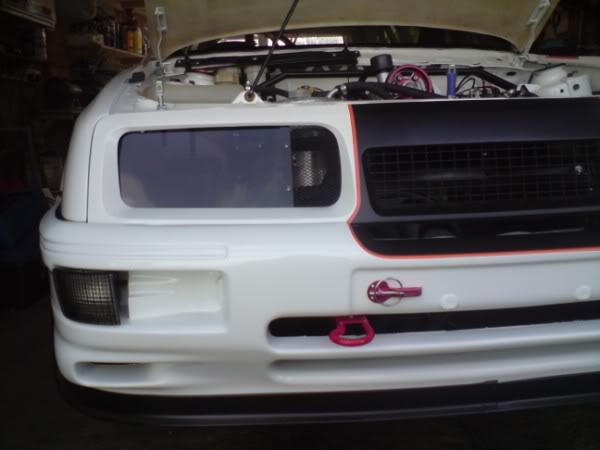

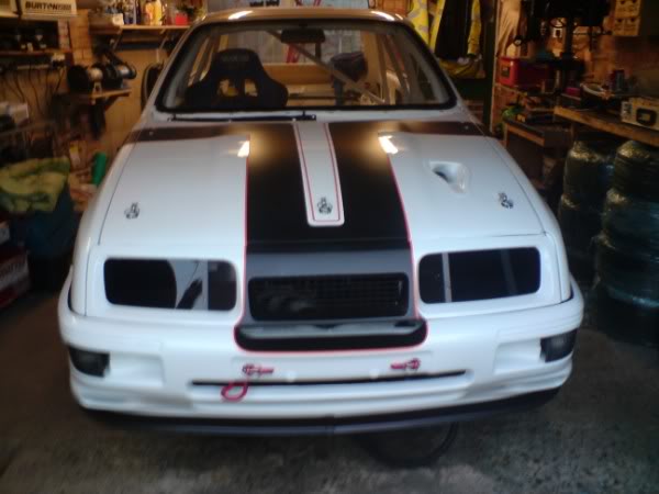

                          dave has asked me to post some more pics, here are the front light covers, they look nice i must say
                          they are black perspex, with a mesh part on the inner edge to allow for more airflow, on the driver side this will cool the dry sump tank and on the passenger side it will flow more air to those throttle bodies

                                NICE those headlight covers really look good dave much better than i thought they would be but i was wrong....
                                nearly there now
