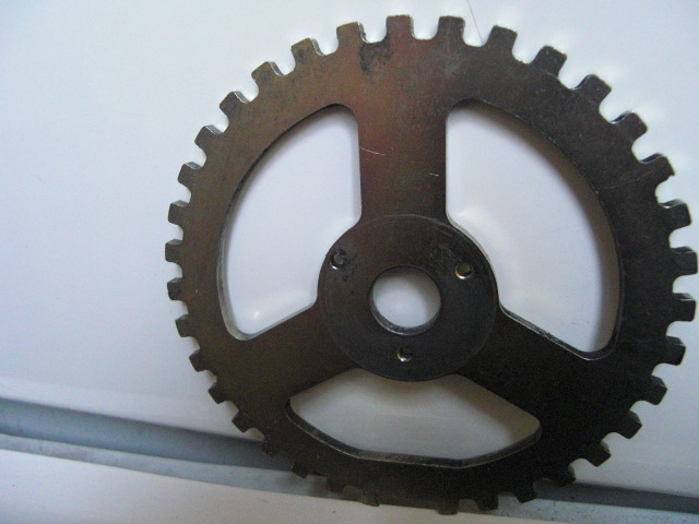

                    Next step before swapping the fuel pump was the crank sensor. It felt solid and hadn't appeared to have moved so a quick check of the trigger wheel and... oh s##t the thing turns around and the crank aint moving

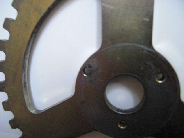

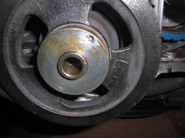

                    I whipped off the trigger wheel and found that the pin that locks the wheel to the crank was almost totally missing.
                    If you look at the pics you can see the small bit of it left on the engine and the damage marks on the wheel on the top left hole;

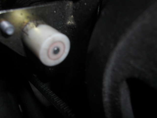

                    I poked the camera down by the crank sensor to check that it hadn't been fouling on the trigger wheel and all seems well. Looks like one problem solved
                    The fact that the wheel was just spinning around at will expains why every now and the then engine would try to fire as the timing would randomly be close to correct for a fraction of a second and then instantly wrong again.
                    The kit was a weber item and was fitted exactly as instructed but I guess its gonna need either two pins, one bigger one or a hole tapped for a small screw, I'll let Graham decide when the engine goes for its health check

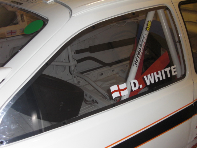

                      Back to less serious matters with the car I removed the o/s rear window to remove more tyre marks and have now refitted it using black vinyl on the window surround in place of the neoprene insulation tape (which wasn't waterproof anyway) so that it sits more flush.
                      I have also replaced the heavy M6 nuts, bolts and washers with nice black plastic number plate bolts and nuts. A few more grams saved
                      I think it looks ok so will do the other side tomorrow.

                        Right had a quick look at the car today to see what was stopping Linford from running. I clamped the fuel return hose first to see if the regulator had failed. Its a new part but apparently they can give up, so with the pipe clamped and probably double the necessary fuel presure I thought I'd give it a whirl. Lots of pops, bangs and flames later and although the engine seemed to want to start, nothing
                        AHEM,AHEM,isn't that what I said was wrong? How about using a diamond washer off of a zetec instead of pinning it?
                          Sorry Nick, I wasn't listening
                          I might use one of those washers and a pin to hold it in the right place while tightening it.

                            odd failure really the pin shouldnt take the drive, i guess the spacer/washer that clamps the trigger wheel isnt quite right so the pin was actually taking the load instead of the bolt clamping it all up, never mind, IT WILL NOT FAIL AGAIN!

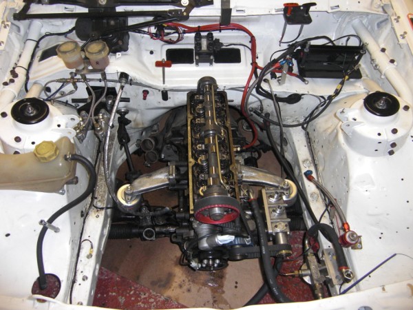

                              Oh well, months to build and a few hours to take apart
                              Inlet, TBs, battery, dry sump tank, exhaust manifold, plumbing and wiring etc all removed today.
                              Just the starter to remove now and then the prop, gearbox, clutch and diff can come out. Once that lot is out the engine can be lifted out with ease to go off for a freshen up
                                Well car is now minus an exhaust system, starter, gearbox, prop, clutch and a few more layers of grime.
                                Next is to borrow a good friends engine hoist and get the engine back to the guru's workshop for a refresh and maybe some light fettling
