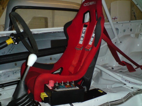

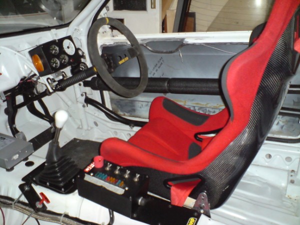

                    Concentrated on finishing the inside of the car today. Have now fitted my new carbon seat that was a TS bargain. Is a bit narrower than the sparco, a little lighter and looks much better in the car in red than the blue did imho
                    Also finished my new gear lever. It is the one Gary made for the TVR T5 that I had in the escort, so first I had to change the holes as the spacing was different on the tvr box and then I cut nearly half of it off to suit the driving position in the sierra. This is just a touch longer than the type 9 stick was I think.
                    I got a nylon gear knob from motorsport tools and turned the end of the stick down to 10mm. I have drilled the knob out to 10mm so that it is a tight fit and will glue it in place before I drive the car. Didn't see the need to thread it as it is only one more thing to work loose

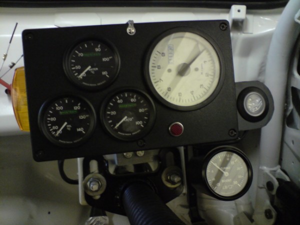

                    I have also fitted a gauge pod and boost gauge that I picked up from Burtons the other day. Is easily visible through the wheel
