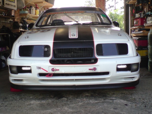

Got a bit done today, we spanner checked the whole car and I have now wire locked a few of the key bolts. much to everyones relief I also refitted the whaletail
Before Lydden i had cut out the spot lamp and indiator appatures. This left too big a hole either side for my liking so I fixed the indicators back in with tiger seal. Looking at it again today i realised that the led front lamps cold move to the spot lamp holes as this would brighten them up incase we have another dark/wet race before the end of the season. They are still bolted to the front panel so the bumper comes off without disturbing them. For next season we will run bigger lamps, either behind clear lenses or in pace of the leds in the bumper..

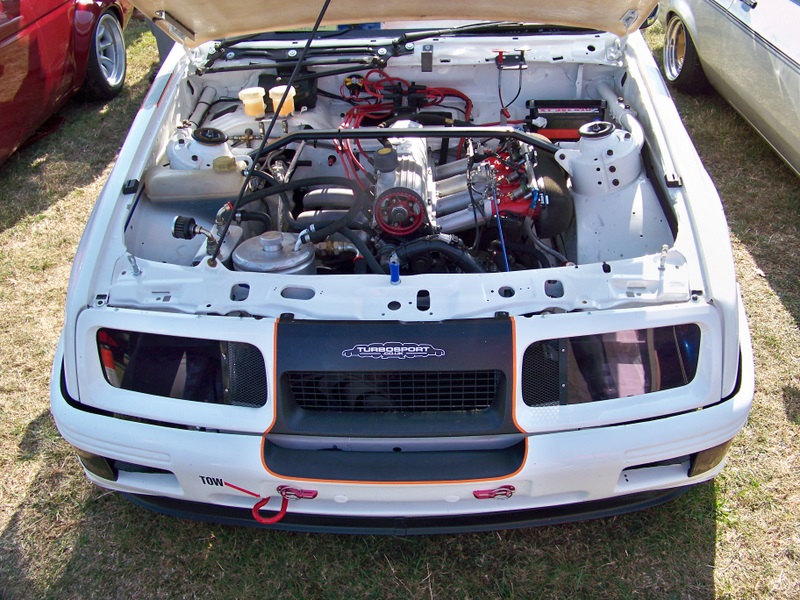

Andy fixed a broken wire on the alternator and i raised the catch tank a bit higher again as it had a little bit of oil in it after Lydden. Now the car is ready for silverstone and after a good wash next week it will be ready for battleridge
