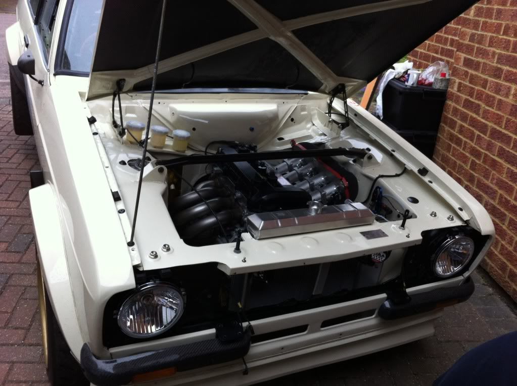

            Paul what are the two bolts on both sides of the slam panel ?

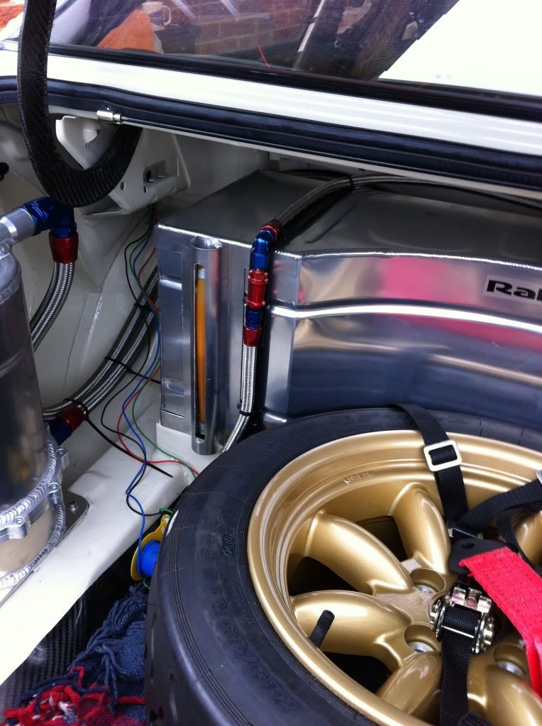

              A couple of pics, first up the funky sight gauge protector........I need it for Belgium events but can't believe that you don't see more on other cars
              And a shot of the nearly complete engine bay showing the new big header radiator. It might be the first clear shot of the removable front panel too....
              I've now got to do a few evenings or take day off to get the car ready for the first engine startup - but not giving up on doing the event in Belgium yet, despite the fact that it'll be over this time in two weeks time!!

              likin sight guage protector guess its some of garys handy work ,ive a similar one but slips around from the back ,less aloy so even lighter
              highlight is the tartan rug tho ,you,ll be making a carbon wicker basket holder next
              keep goin paul the end is in sight
                Whole front panel is now bolt on/off

                  They're part of what holds the removeable front panel on. There are also some dzus fasteners on the front spoiler, and some tags/bolts between the wings and front section.

                    Hi Rob - you should know that Gary is a steel man
                    Gauge was all my own spec - thats what happens when you're bored working away from home
                      Awesome Paul, please no more big changes, i want to see you pedal this again soon
                      Hi Joe.
                      Yes, front panel is lighter than standard, and removable
                      No more major changes scheduled now - I have plenty of dangerous (expensive!) ideas, but they're going to wait until it's done some competitive mileage during the summer. Realistically, I reckon the next big changes will be Sept/Oct before Tour of Mull and/or Killarney.
