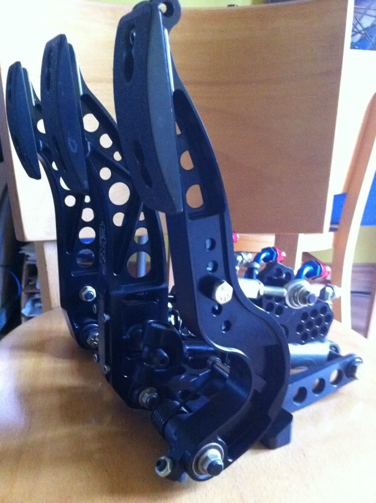

                      OK - some more pics will be on this weekend guys - its just that I've currently got the car to such a position at the moment that I can only get it out when there are a couple of us here.
                      The good news is that its all running again, and I havent been totally ignoring it during a busy December - as you can see by the latest Gucci offering below
                      The only downside to this and the funky new steering rack is thats its creating even more work!! (and a dent in the wallet obviously).
                      Plan is to have them both pretty much installed before Autosport Show, where I need to talk to a few people about suspension upgrades - then she's ready for the start of the season

                            Nice pedal box Paul ,looks slightly different to mine ,i had to use ap short cylinders on mine to get the pedals far enough forward, thats with Gary having moved the seat etc .I will look forward to see how you get on with the throttle cable as i havent tackled mine yet ,i think i will have to buy the linkage you have as mine didnt come with it

                              Looks very nice Paul. Are there advantages using the floor mounted pedals over the standard pedal box? I think Rob Dennis has got this in his car. I was speaking to one of his team at the Rally day and they said something about a different one is now available with angled cylinders so you can mount it further back. But i think he is quite a tall guy.
                              Whats your first event for the season then? Epynt?

                                I had a floor mounted pedal box in my Sunbeam when I put the BMW engine in, due to the bulkhead mods I had to do. To be honest, it turned out to be a proper pain in the arse, the fact that the cylinders were slightly lower than the Calipers, the fluid would tend to run back, and I ended up having to fit in-line residual pressure valves. It was a Tilton box too. The brakes never seemed just as good as they should have done after that (AP 6 pots front and 4 pots rear) and they took a dogs age to bleed. I hope that you don't encounter the same issues Paul.
                                Take care, Lee.
