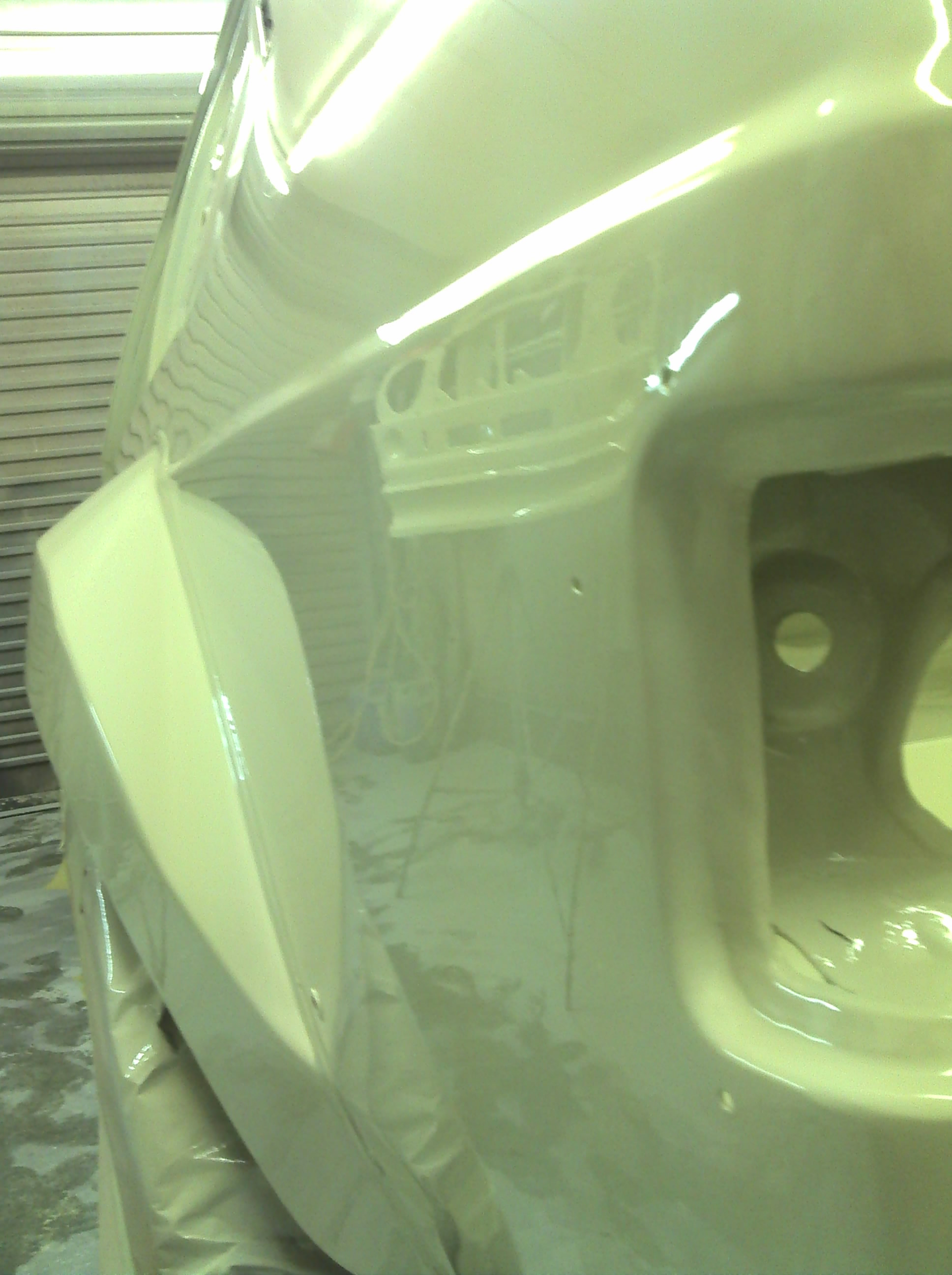

                              Ok, here's a teaser.........new drip rails fitted as the old ones were nasty underneath, and we wanted fresh/decent metal onto which the bolt-on wings will fit. One of the first jobs is to add rivnuts ready to accept the lightweight fixings for the wings....
                              The whole car shines like this

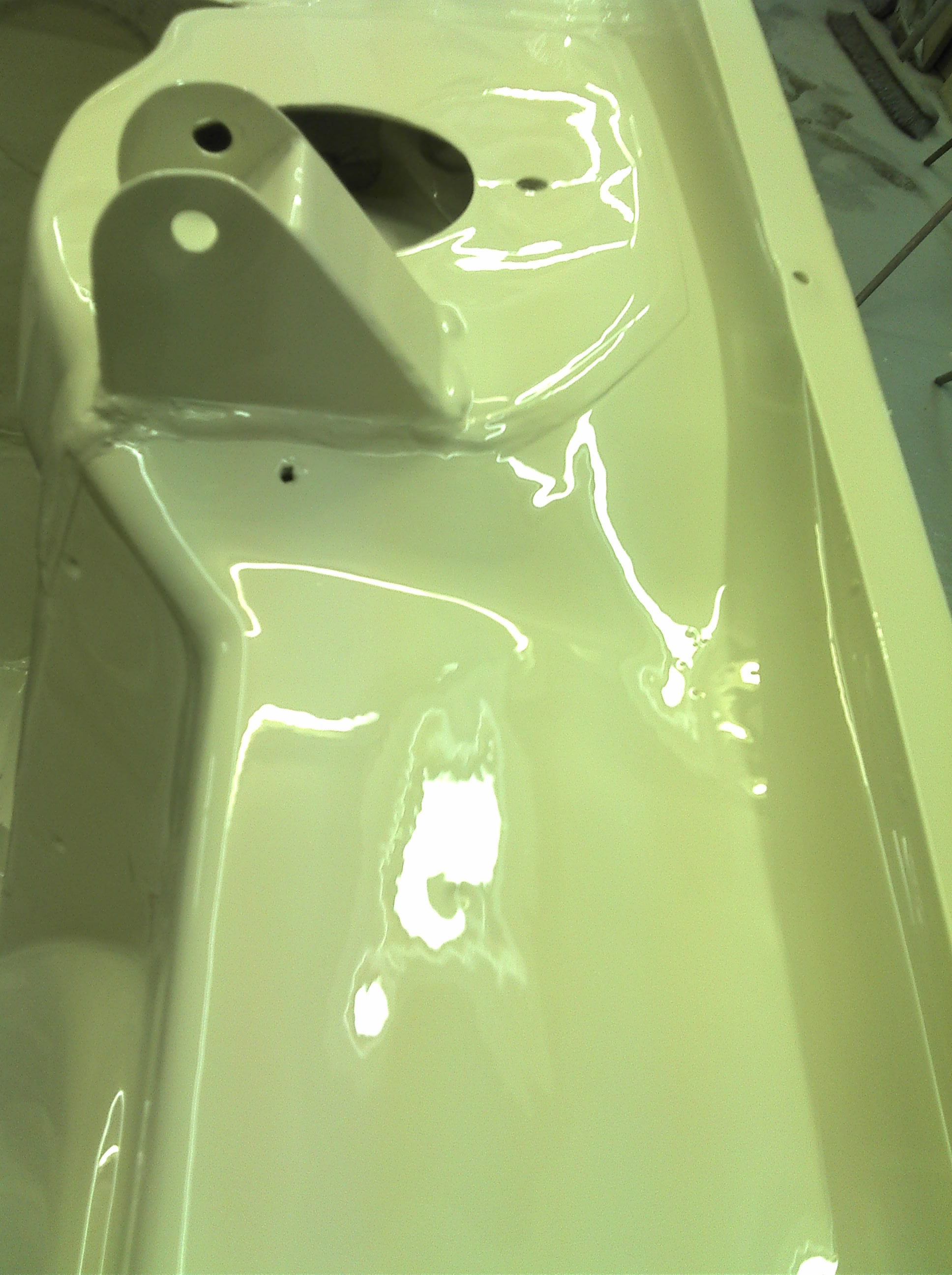

                                And here's the N/S rear quarter that I errr parked against a tree. This is all original, only benefitting from hour after hour of Shaun's panelbeating skills
