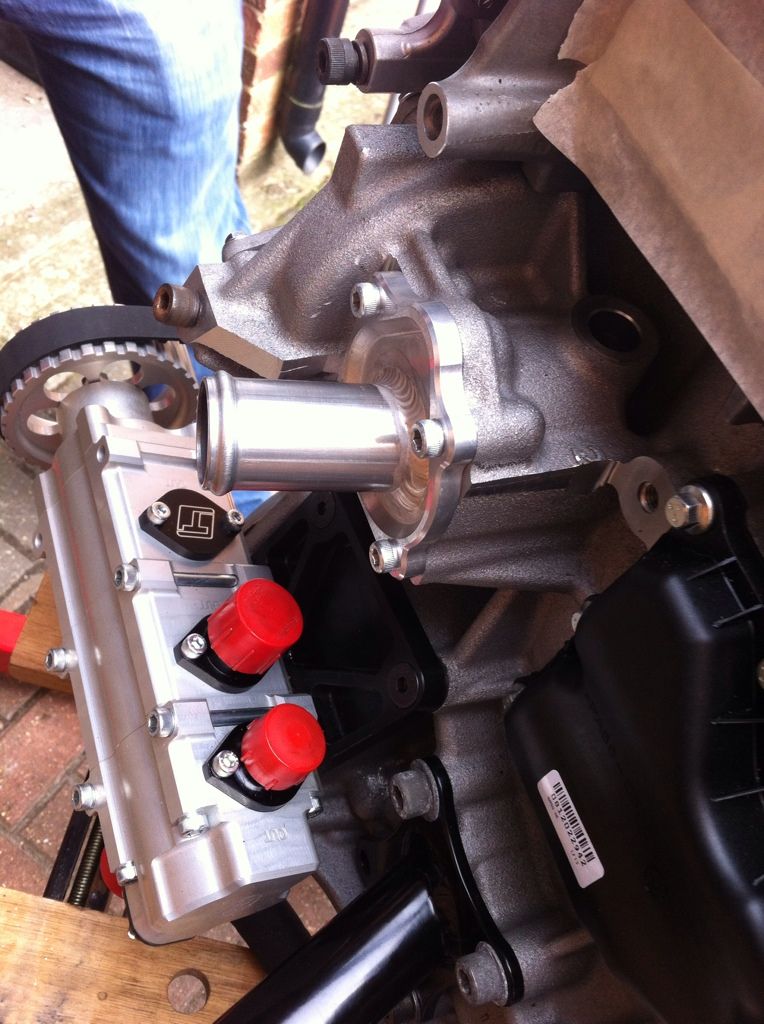

        Not many pics taken, but this one shows the water maniofold in place. I need to plumb from the front of this down to the laminova but am waiting on the silicon hose to arrive (special order because its red!? ) The manifold has a drain (for when its used in single seaters), a fitting for the ECU water temp sender, and two more for "user options". I'm using one for a small bleed pipe, and the other for my water temp gauge...

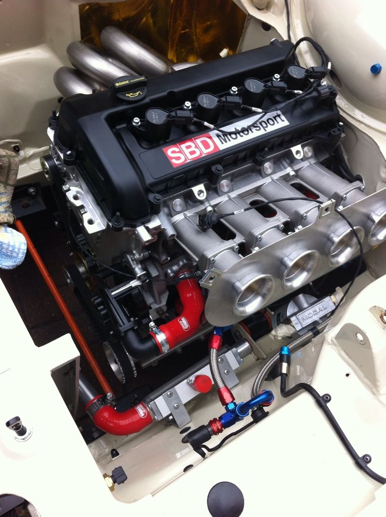

        Another shot of the 75% complete engine bay. You can see the air temp sender on the bottom left hand corner - and we've used a hole cutter in the front panel so its not reading engine bay air temp. We've also got the hose between the electric water pump and the inlet fitted...

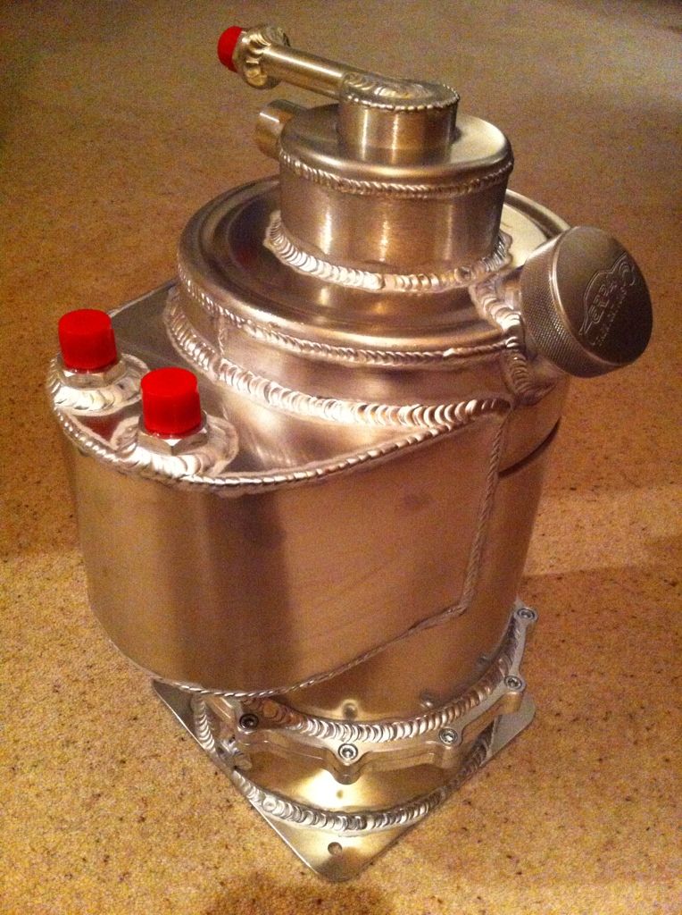

                        It seems this is a week for progress - look what arrived today...
                        I have to say a huge thanks to Torsten at Gp4 Fabrications in Ireland. The original tank I ordered fouled my bodywork, so they have had the tank back and managed to remove the old catch tank section and re-create a new slimmer/taller one for me
                        Also, as always seems to be the case with Gp4 Fab, it was posted on Friday and it was here this morning! I cant get a letter from down the road in that time often enough
                        I'll have it fitted and in-situ pics at the weekend.....
