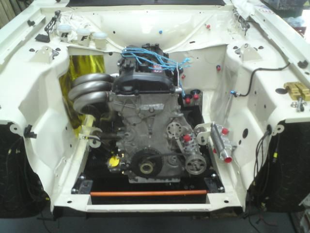

        A quick taster with a borrowed engine mocked-up in my car
        More soon,
        Paul

          More pics please let's see the real deal in there
            • 2437
            Re: Paul Alex's Honda-powered tarmac rally Escort
            Looks tiny in comparison
            And very familiar ?

              As soon as it's in here - next weekend maybe, but probably the weekend after.....
              And very familiar ?
              Remember the long inlet manifold and bodies will fill some space.
              Engine once lived in Matt D's flying machine
