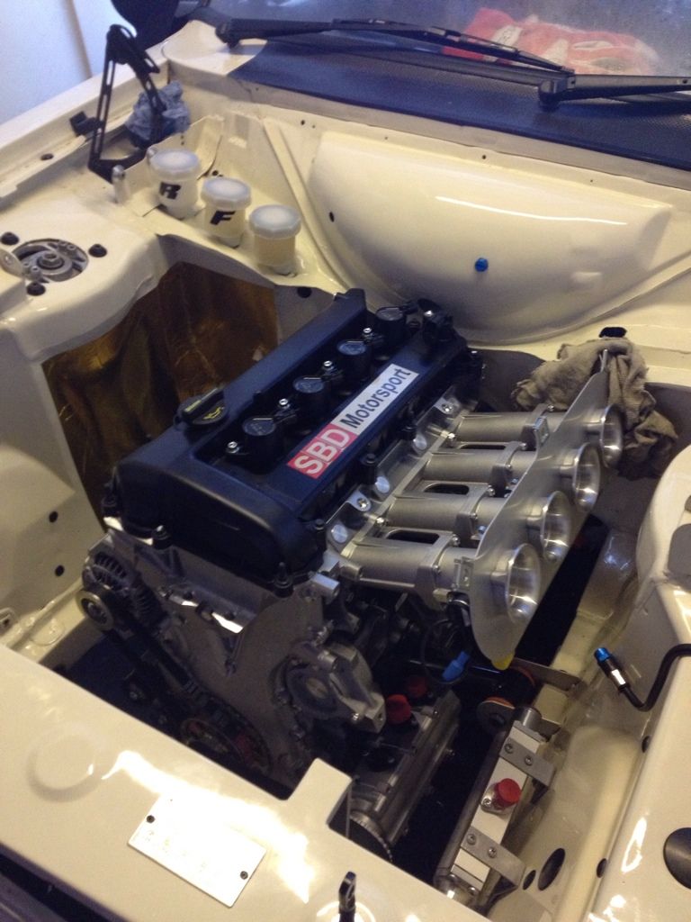

        Originally posted by PaulAlex
        Thanks for the kind comments guys
        I think the injectors underneath is purely an aesthetic thing - just keeping the loom and fuel lines out of sight. I guess it'll make the car look better, but its going to be congested under there by time we get the electric water pump and laminova plumbing in place.....
        Here's another shot - showing a little of the funky front panel:
        Cheers,
        Paul.
        Thanks very much indeed for posting this image as I am looking for inspiration on where to fit my Laminova cooler in my mk2 escort engine bay which has a duratec in it and a dry sump system. My car has the dry sump pump on the drivers side and the tank in the drivers side wing (ralloy). I should maybe post some images of the car rather than lurking.
        Question> The brackets you have made to hold the cooler onto the body, have you screwed them screws into the alloy body of the laminova as I didn't know the parent metal was thick enough there?
        Nigel

          Hello Nigel - yes, we took advice from an engine builder who has done the same thing with his laminovas previously. We've only run the car for a single event in this configuration, but had no issues. BTW I looked at your thread - lovely machine you're building there

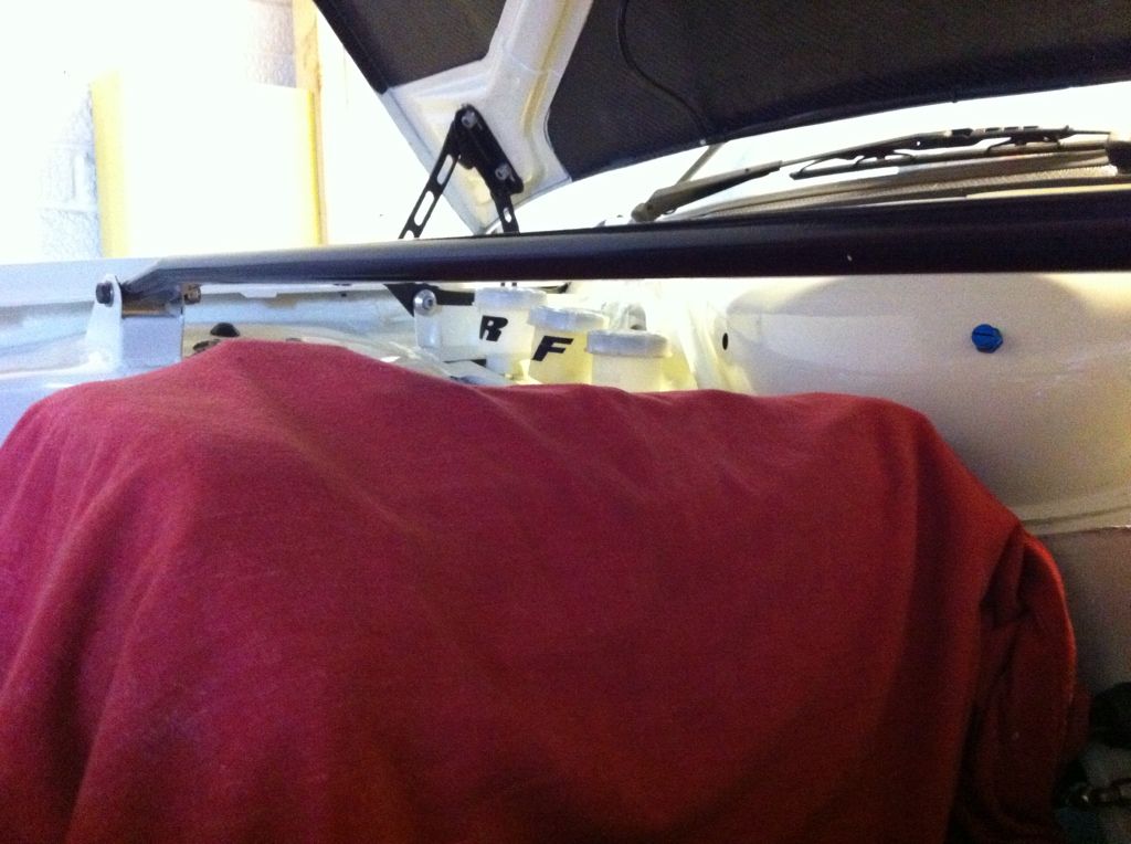

            Couldn't resist trying the old strut brace out - just to see how much lower the new engine install is. You couldn't get your little finger between the engine and brace previously.....

              Well, the electric water pump might fit beautifully - but we won't know until I get a new radiator and see how proud the core sits from the mounting face towards the engine
              Have managed to finish the mock-up oil lines, and do most of the fuel lines in the engine bay, including the sample valve. Even gave it a clean to get all the crud off it from being up/down the country recently....
              .....then, just when I was thinking how productive a weekend it had been, I found out that my lovely looking new dry sump tank won't fit!?!? Basically, the integrated catch tank fouls the bloody rear quarter, so it's back to the drawing board for that change I can move the tank inboard slightly, but then the boot hinge fouls where the unions will be - so I think I'm going to have to ask Torsten at Gp4 Fabrications to make me another with the catch tank facing forwards or backwards instead. Nothing's ever simple is it?
