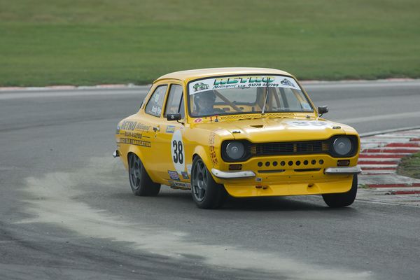

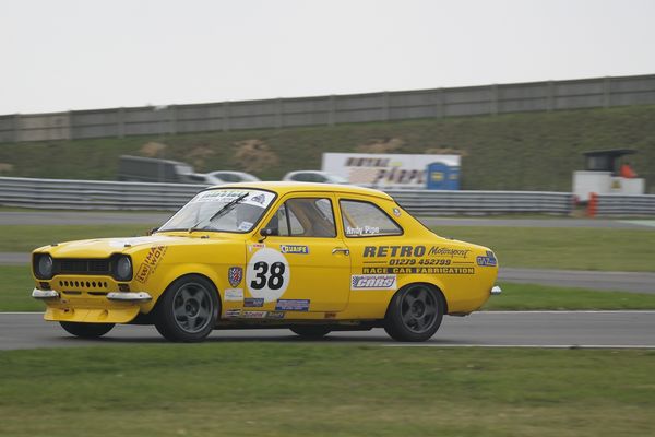

    You should all know my one by now. It was built in 1991-92 from a 1100 shell that was found in a scrap yard. The shell was prepared by Ray Donner of Preptech Racing and the 1600 X Flow short stroke built by Dave Wills and Steve Greenauld of the Lotus Servicentre in Ilford. The car uses a 2000e bullit box with Tran-X internals and an english axle. the rear suspension is a development 5 link system designed by Gary @ Retromotorsport. The car is currently being run in the BARC SEC TRC championship in association with Dunlop. Will post 2006 dates when i get them

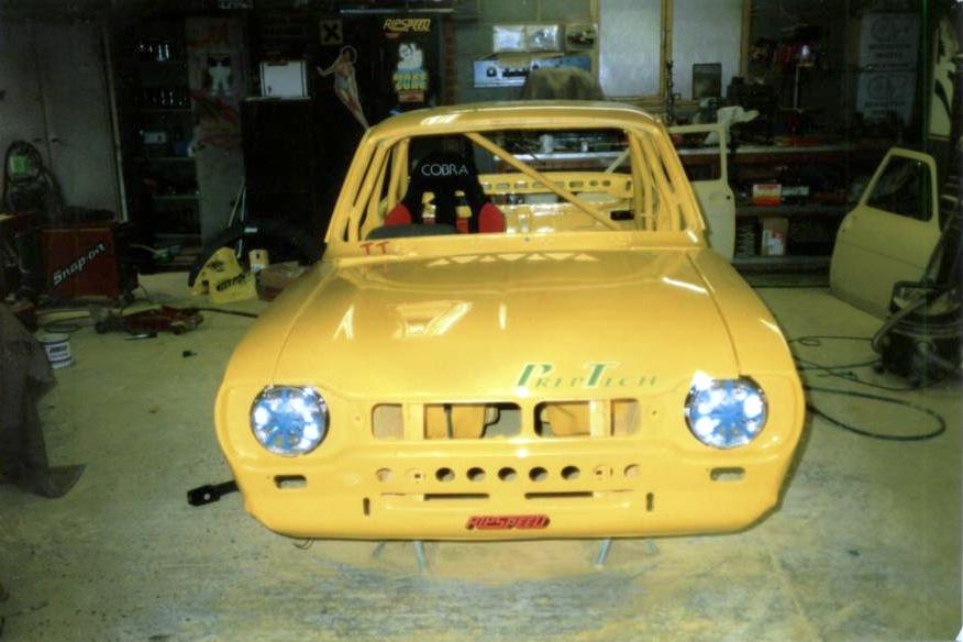

        The original build

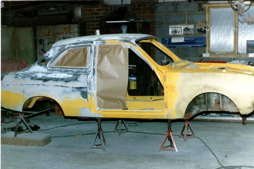

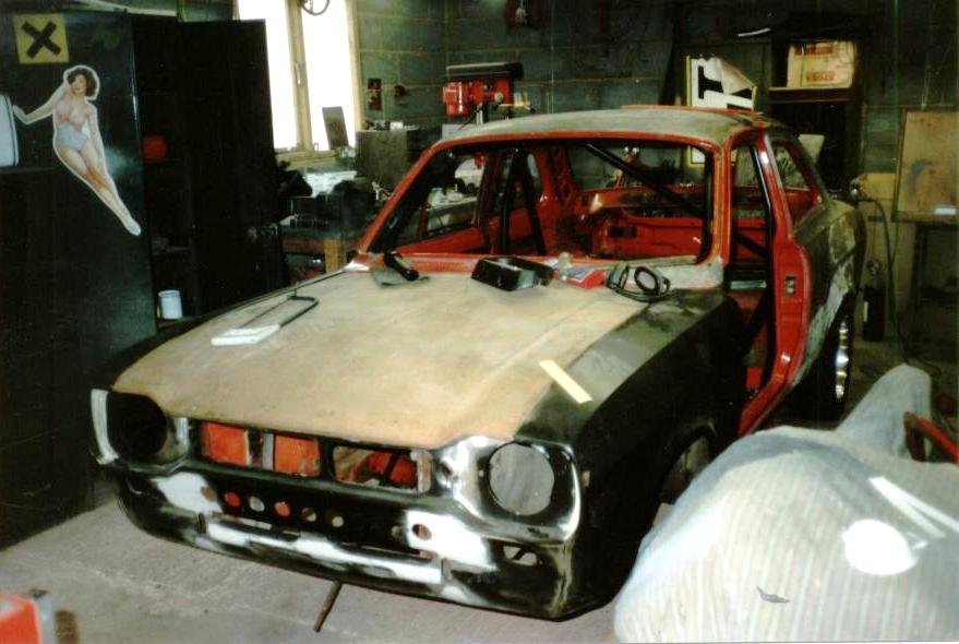

        One of the rebuild after the off

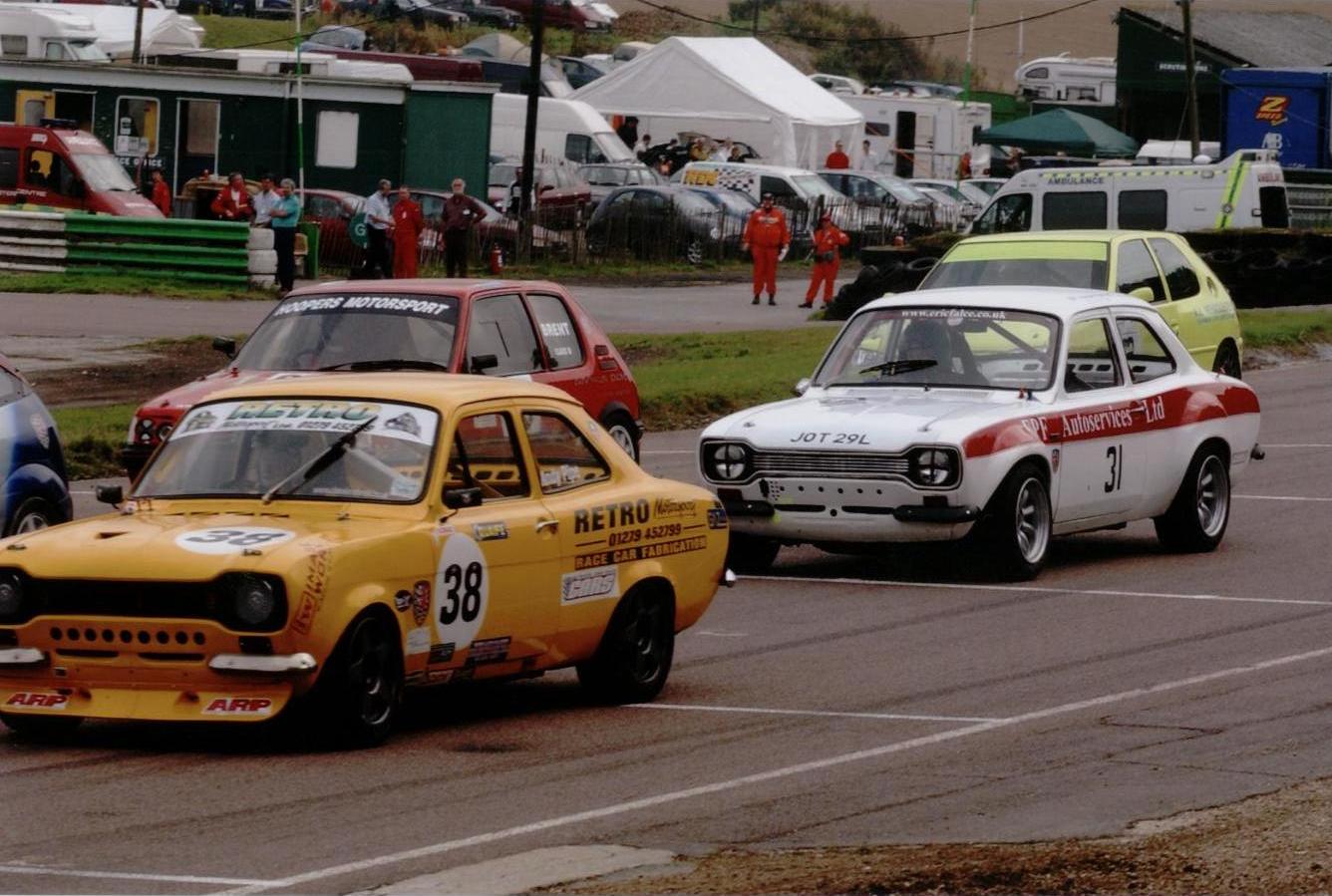

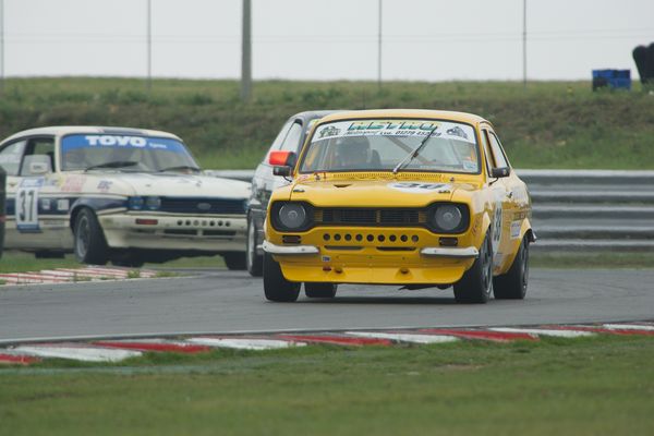

        And a few more action shots from the last 14 years

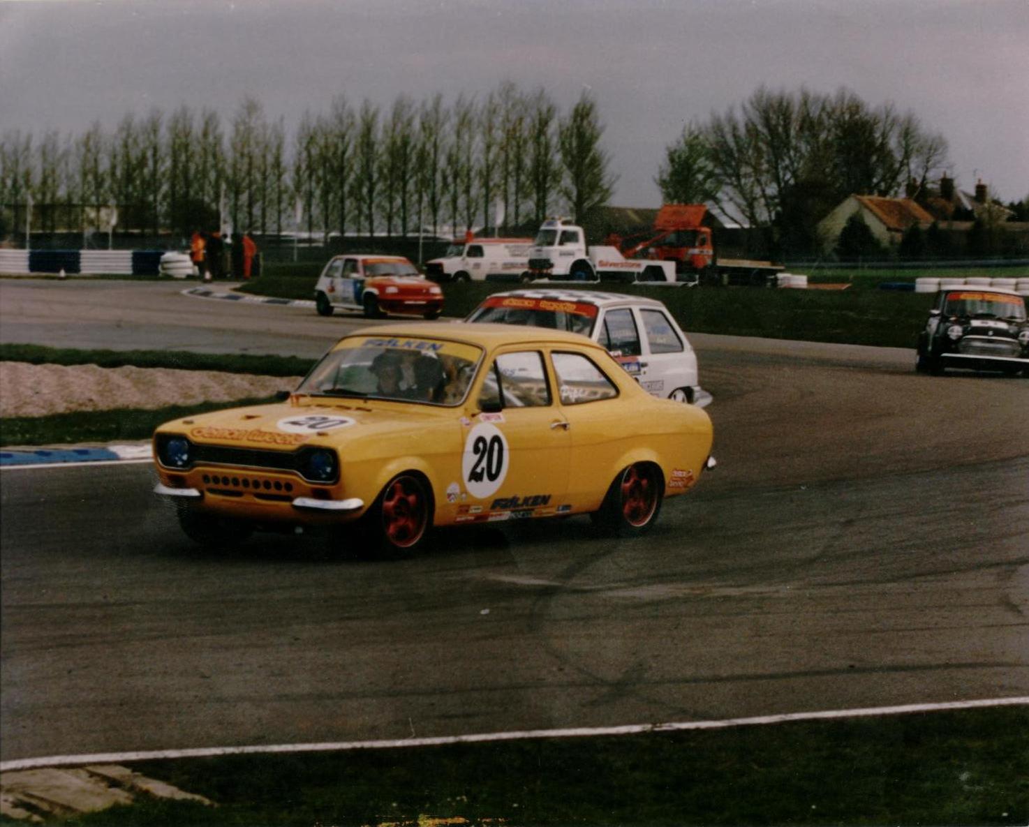

              Like that first race pic (4th one down)
              What series was that in, as I dont remember one that allowed trucks and
              vans to compete with the cars

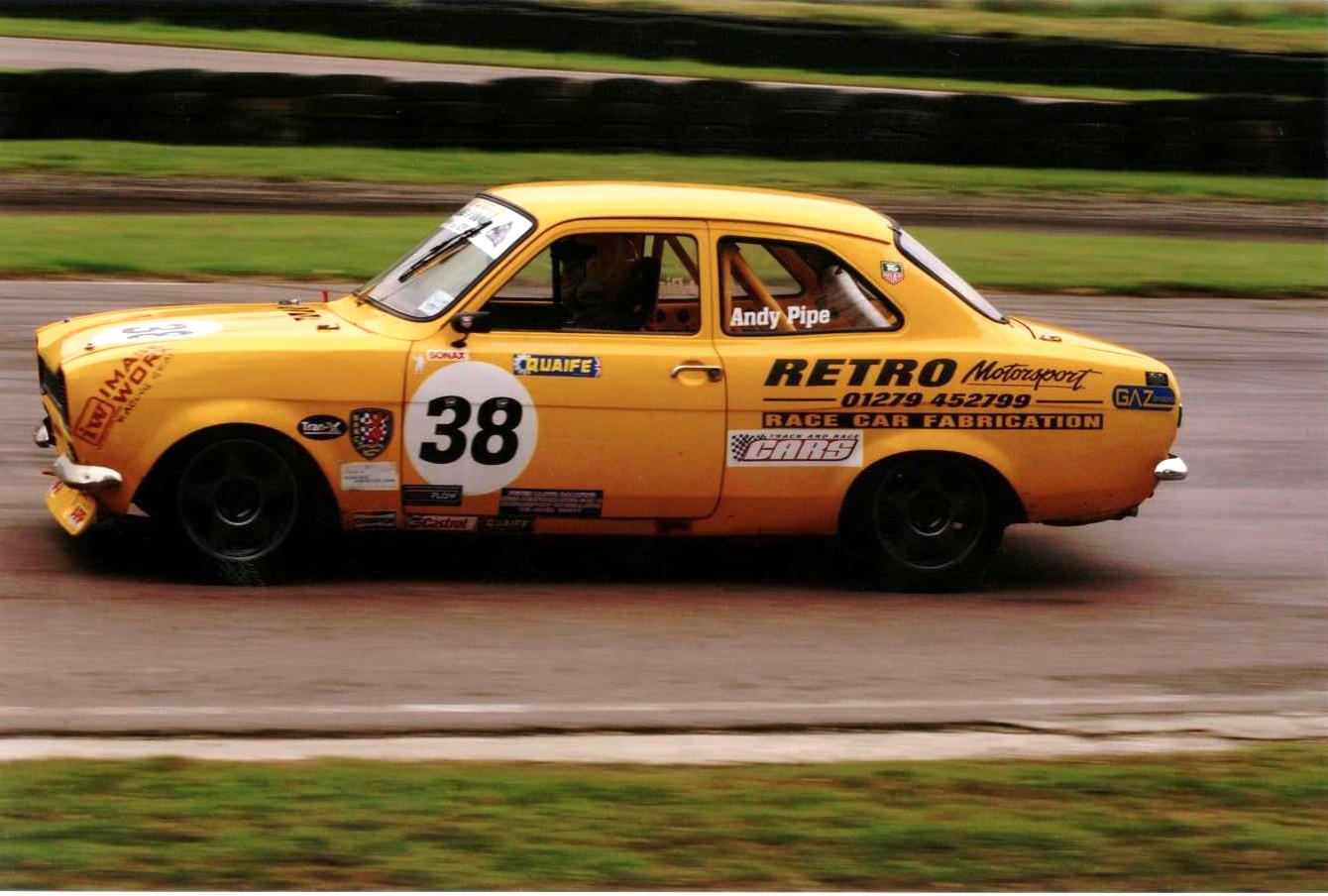

                That was silverstone 1994 in the Falken Tyres Chmpionship. That was the 1st race of the season and 4 months after the little off

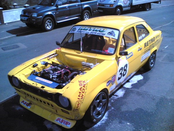

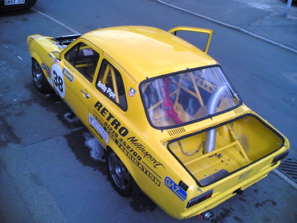

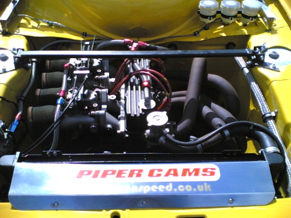

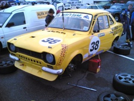

                      A few updates and mods have been done ready for the 06 season which were finished off today. All we are waiting on now is the painting of the new bonnet and boot. Overall the car should be a lot lighter this year

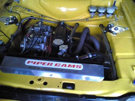

                      New breather lines and general tidy up in engine bay

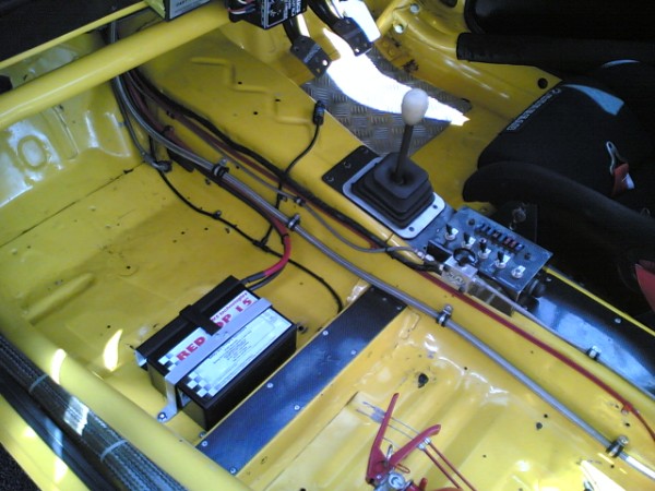

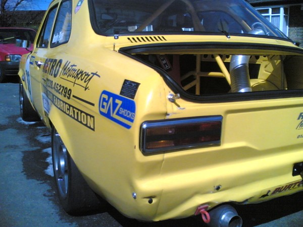

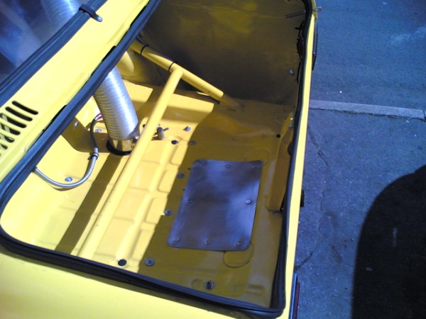

                      Big battery and box removed from boot....
                      ....and replaced with small race battery and a lot less cable

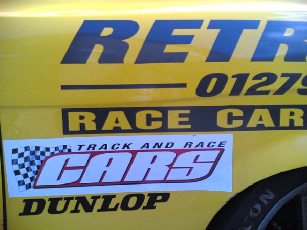

                      Race series sponsors
                        And a few more

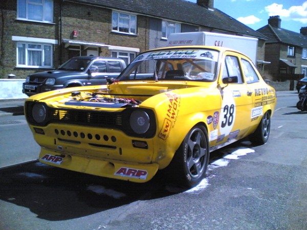

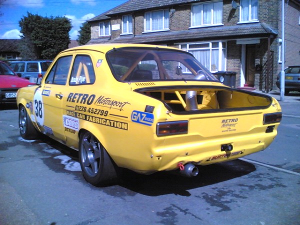

                        Rear bumper removed and hi vis rain light fitted
                        Front bumpers removed
                        All washed
                        Just waiting for bonnet and boot (being painted as I post this)
                          One more nice pic;
