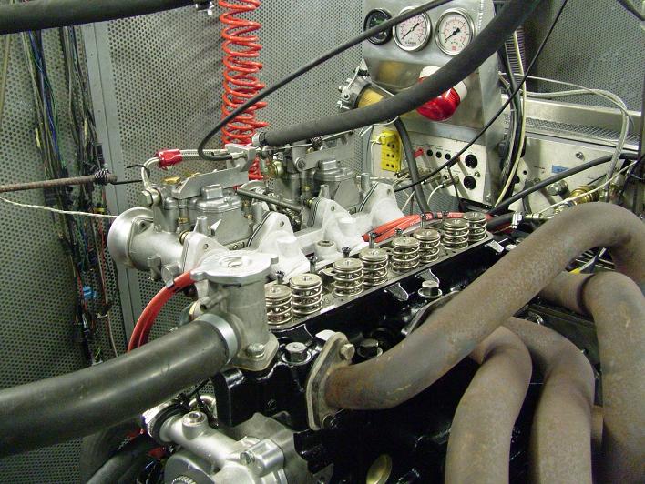

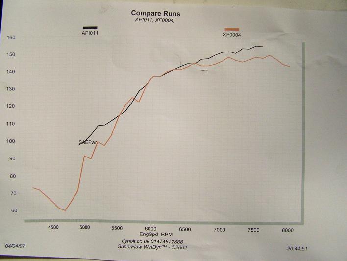

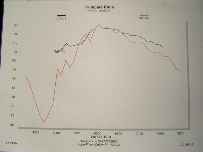

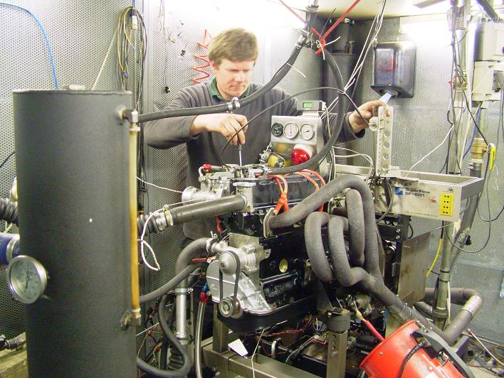

        Here are a couple of pics from Wednesdays dyno session and the resultant dyno plots (red=before:black=now), the main difference between the engine before and after is that a milder cam has now been fitted with less lift and less duration.
