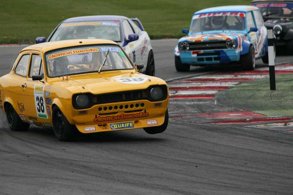

                    Just found this pic ...
                      Not lacking grip then
                        #356
                        excellent one wheel dangling, just as it should be! i know gary wont agree but it always used to work for me in the 02 and that used to beat most escorts
                          #357
                          Thats why ive got a massive crack top to bottom of my windscreen
                            #358
                            graham, did you ever work out the rear roll center on your 02?
                            I havnt actually measured Andy's (its as low as it can go with the set-up Andy's got)but i know its below the axle centerline, but yes your right, i would prefer to keep the car flatter.
                            The good news was that andy reported back that the car was neutral, so i can dial in some more rear end grip so he gets a touch of understeer, and make use of that extra grunt hes got now to shoot him out the corners.
                            Think maybe i'll be doing some moving of the original front cage attachment points too as i suspect they may be putting the screen is shear, allthough Andy does tend to be kind on screens and makes them last so we could just bond it in.
                              #359
                              i would say if his car is neutral then you should leave it alone and let andy push it harder until it does over or understeer THEN correct that
                              no need just attach the cage to the shell on teh A posts
                              nope too technical for me i prefer not to therise too much anyway and just drive/adjust/drive the car until the adjustments stop improving things
