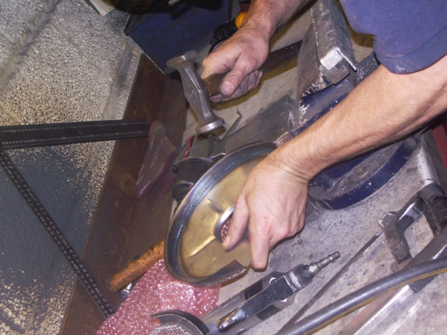

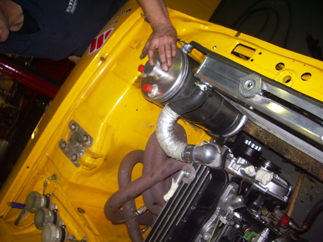

                                Saturday was spent at Retro's workshop, with the task of getting the drysump tank mounted in the engine bay.
                                Gary doing what he does best

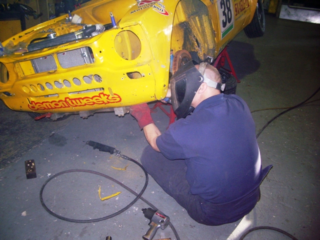

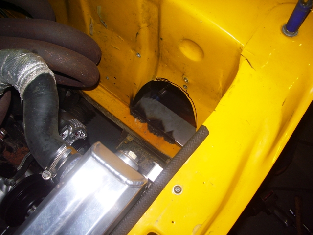

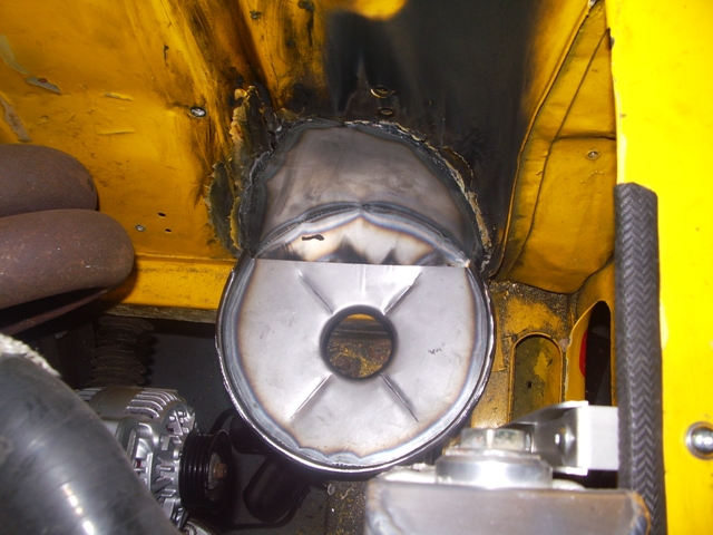

                                Slight notch in inner wing for tank clearance

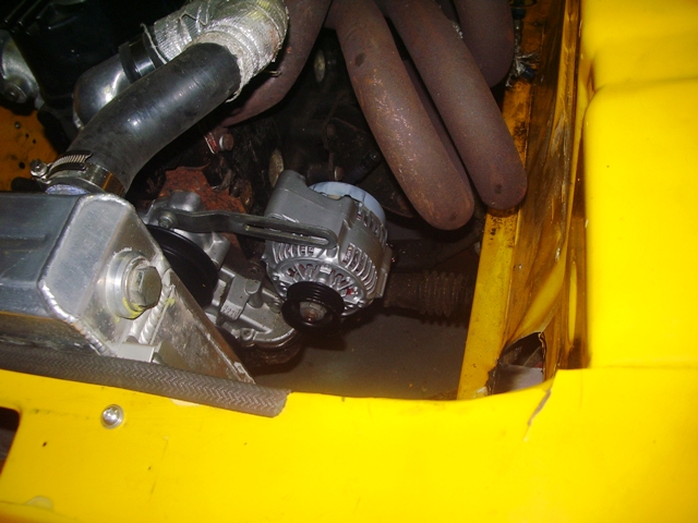

                                New 35a alternator in position to check for clearance

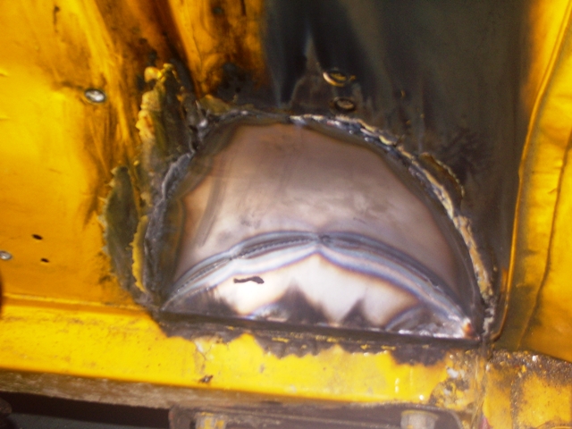

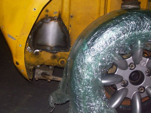

                                Inner wing notch filled in

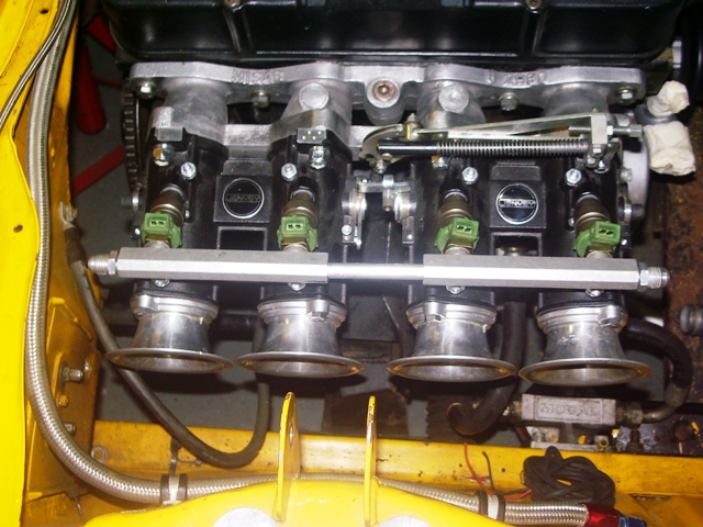

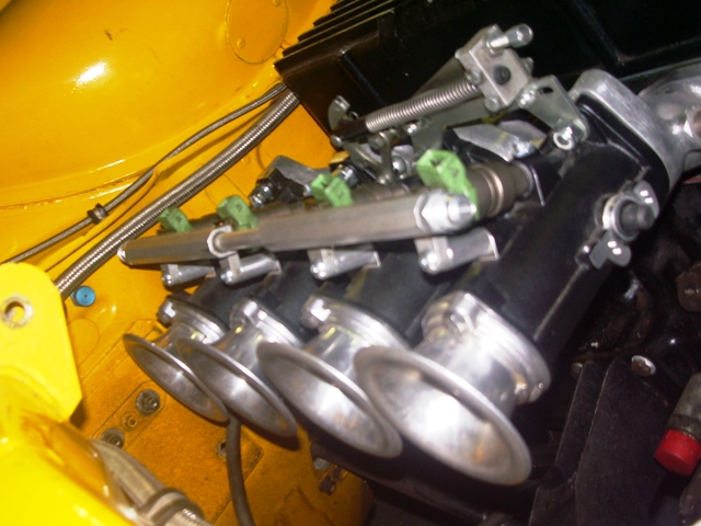

                                While Gary was messing about, i started getting the throttle bodies in place ready for the wiring loom to be created next weekend

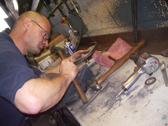

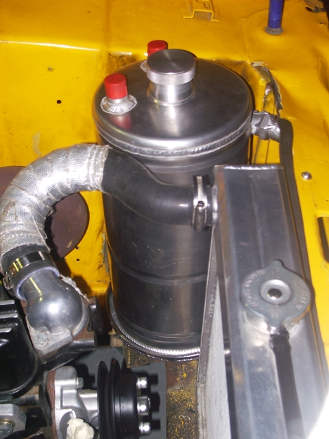

                                The dry sump tank base being made and installed
                                Tank in place
                                Plenty of clearance
