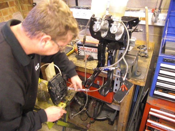

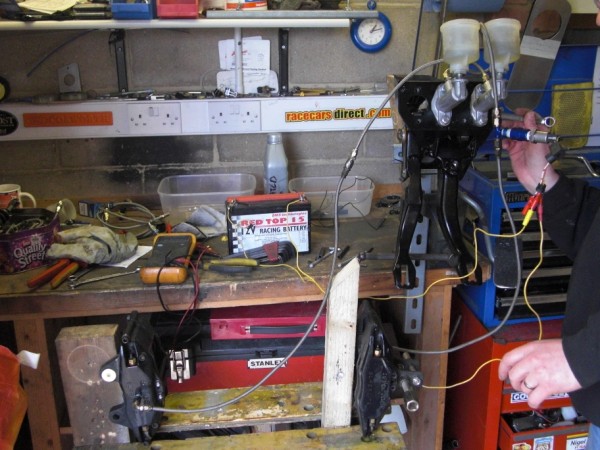

                            Right its about time for an update on the lil' yellow escort. After our brake problems at combe we then made various revisions to the brakes only to have the same problems at the brands DMN meeting. Through out the day we tried different set ups but could get very little front brakes so after an unsuccessful day of racing Andy decided that while we sorted the brake system in more depth it may as well be time to strip the car down so we can get it fully competitive for next season.
                            As I say the front brakes were the main concern so Andy has now fully stripped and rebuilt the calipers with new seals and a bit of a clean up of the pistons as one or two showed signs of binding. His dad also fully stripped the pedal box and got it powdercoated.
                            With all of the parts now in good shape and with new master cylinders it seamed like a good idea to test the system out of the car because as most of you know trying to sort out the pedal box in situ in an escort can be a real ball ache.
                            With that in mind a test rig was set up where front and rear systems could be checked and the bias assembly and pushrods could all be set without the need for contorting under the dash of the escort.
                            This all proved very successful in a number of ways, both in proving all of the parts we have are working and in setting everything up with plenty of bias adjustment and most importantly a nice big bias towards the front brakes. The pedal also had a good 'feel' which had been absent for some time. A couple of hours work but so much better than guessing if everything works and having to take it all out again.

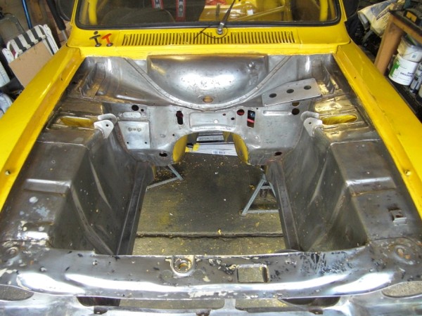

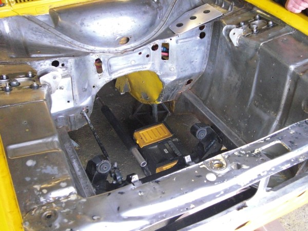

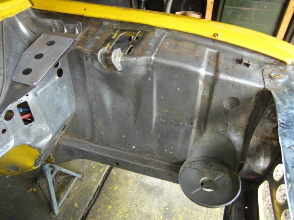

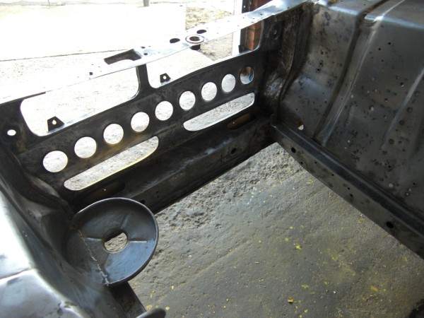

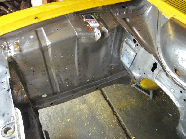

                              The next problem to address while the car was getting a bit of tidying was the engine bay. Due to a paint problem earlier in the year we were left with paint that remained tacky and crazed, basically it looked horrible compared to the rest of the car.
                              So with the engine out and awaiting a visit to HTs for a freshen up (a bit over due and its a little down on top end power) we thought it was time to attack the engine bay. Steve (Andys brother) has done an amazing job of bare metalling the whole bay and is also half way through stripping the front panel
                              How many people would kill for inner wings like these;
                              Bulkhead and front panels also devoid of rust
