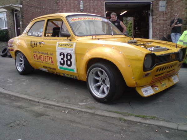

                I think i've just damped me pants
                Looking good there matey
                  #473
                  it sure looks faster
                  andys just got to remember how much wider it is now

                    Lovely car...looks soooooo..much better with those arches/wheels.

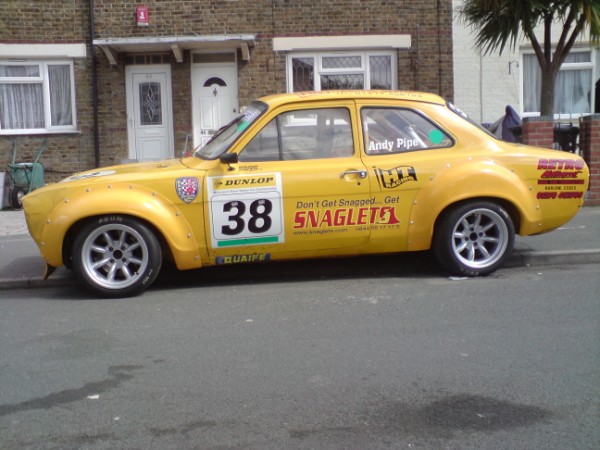

                          What d'ya reckon??
                          Thats proper!

                            What d'ya reckon??
                            I recon the paints a different colour
                            Aside from that looks hard as, cant wait til tomorrow
