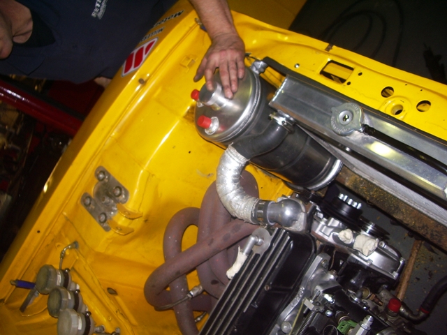

            lovely dry sump solution there, think I might just have to copy that if you don't mind.
            I ran one behind my radiator on the Caterham which was putting out about 270bhp and had no problems with oil temperature even in 45'c ambient conditions in Dubai.
            Which brand/model of tank did you use?
              Its from rally design, around £100 I think

                Certainly a cheap option, is it the 2 gallon one here by any chance
                www.gulfpetrolheads.com
                  #578
                  Yeah I think so. Its about 8"x16" overall

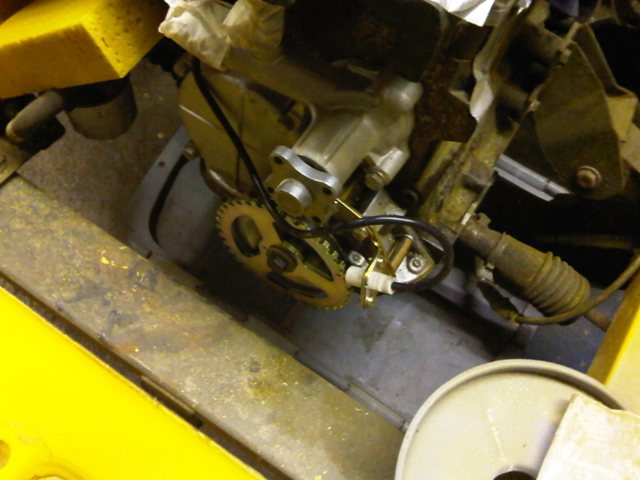

                    Not a lot to report this weekend. Due to other commitments, all i managed to do was get the crank trigger for the management fitted
                    Ordered all the plugs and cable for the managment so should be making the loom for it soon

                        Thats where i would like to mount my tank in the anglia but i'm not sure if i have enough room
                        Are you having a 1" drive pulley Andy ? I was hoping to keep mine. Is that the webber bracket and wheel you have fitted ?

                          Just checked, hmm could be impossible for me
                          Could you measure fron your front panel to the most forward part of your exhaust please so i can have a measure up at my end ?

                            I will have a measure over the weekend Craig. The trigger kit is an off the shelf webcon kit and to be honest, for the money, it aint worth messing about making your own. I have changed over to a vee belt now as we have to now run an alternator and i dont think the trigger wheel kit would fit a toothed belt and looking at it, it has been designed for the standard pulley

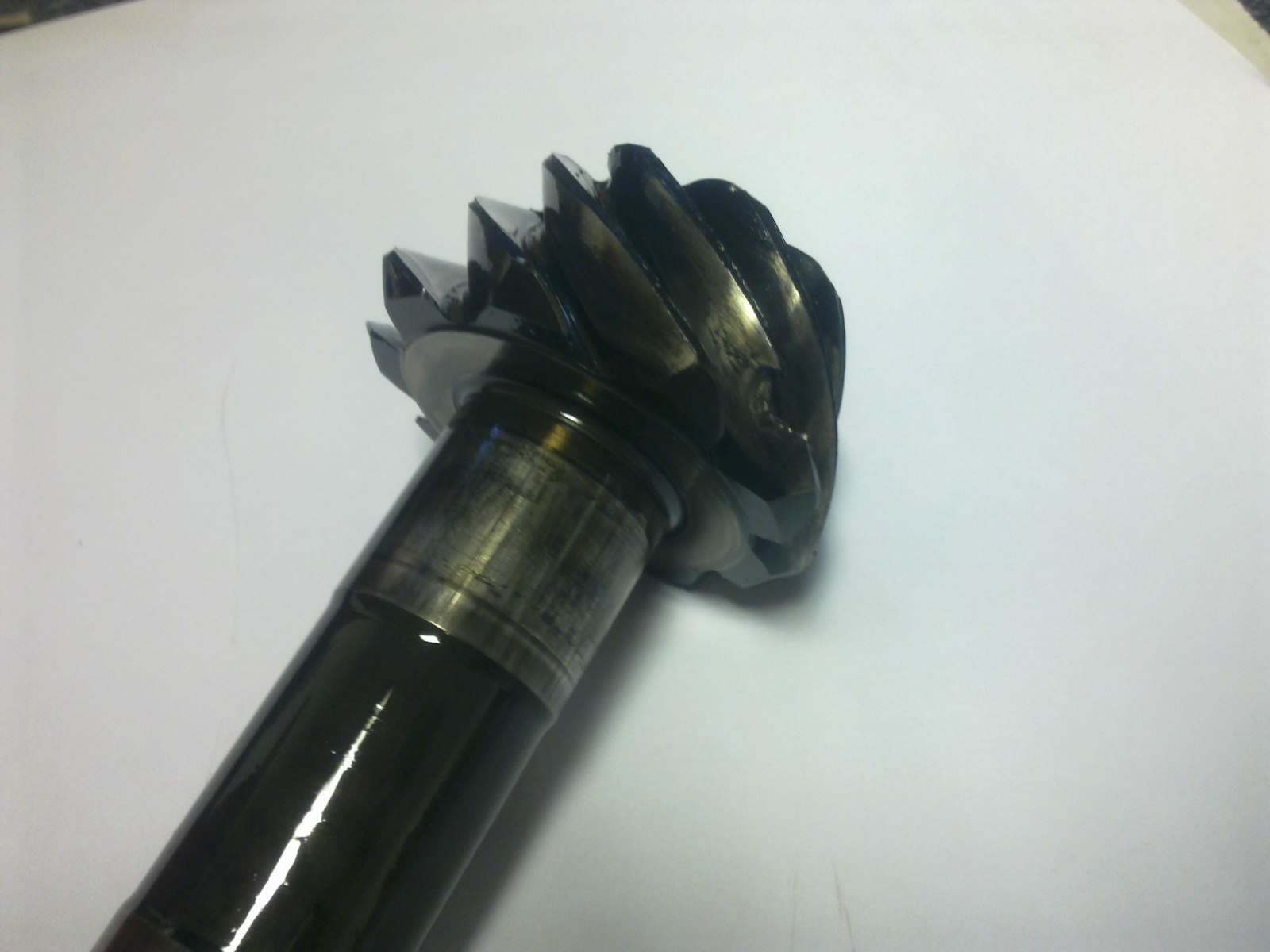

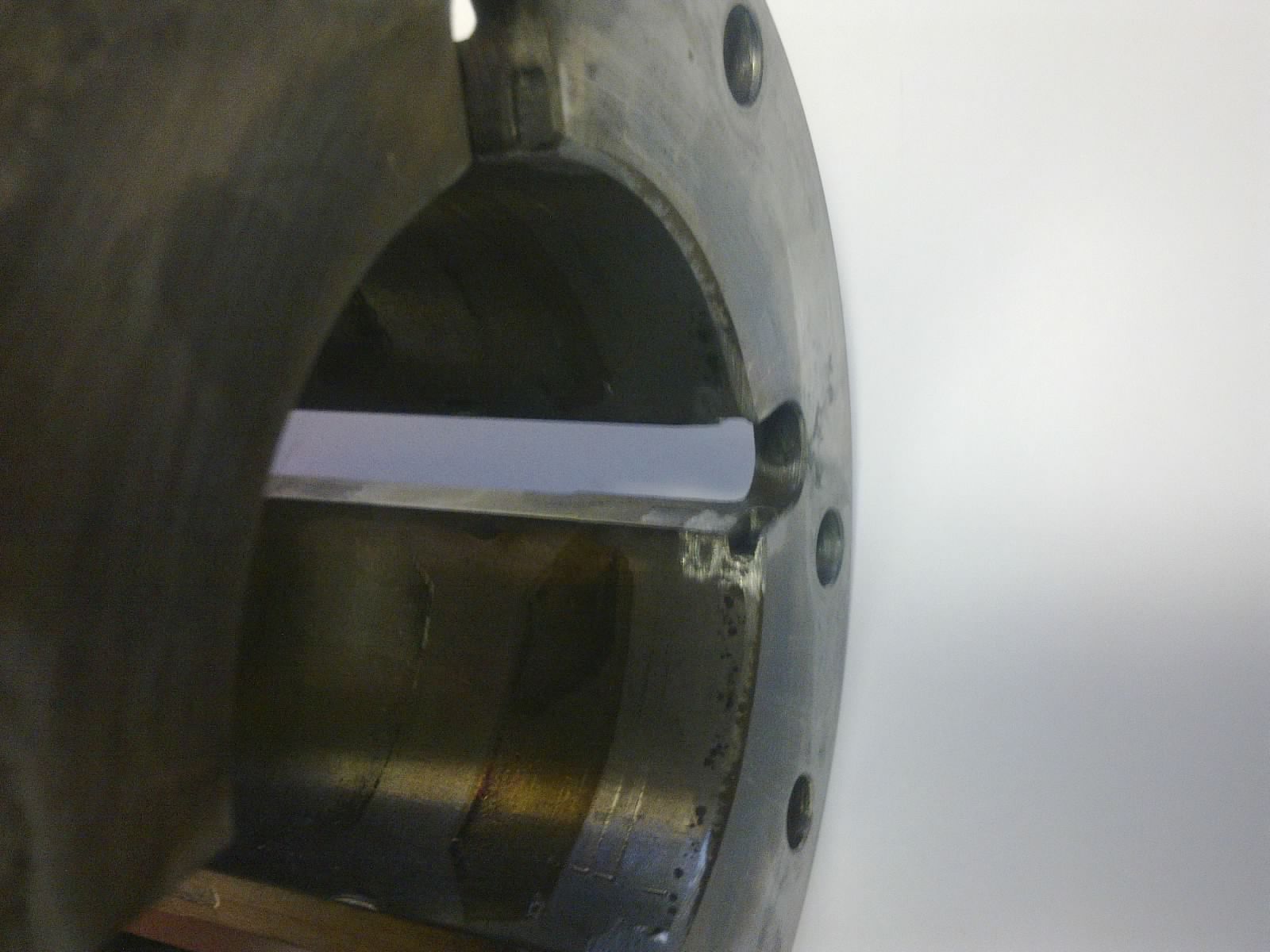

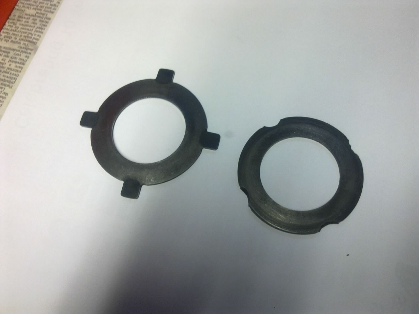

                              #584
                              Shipped the diff off up to Fostek and after the strip down he found it was shagged. More money to find
