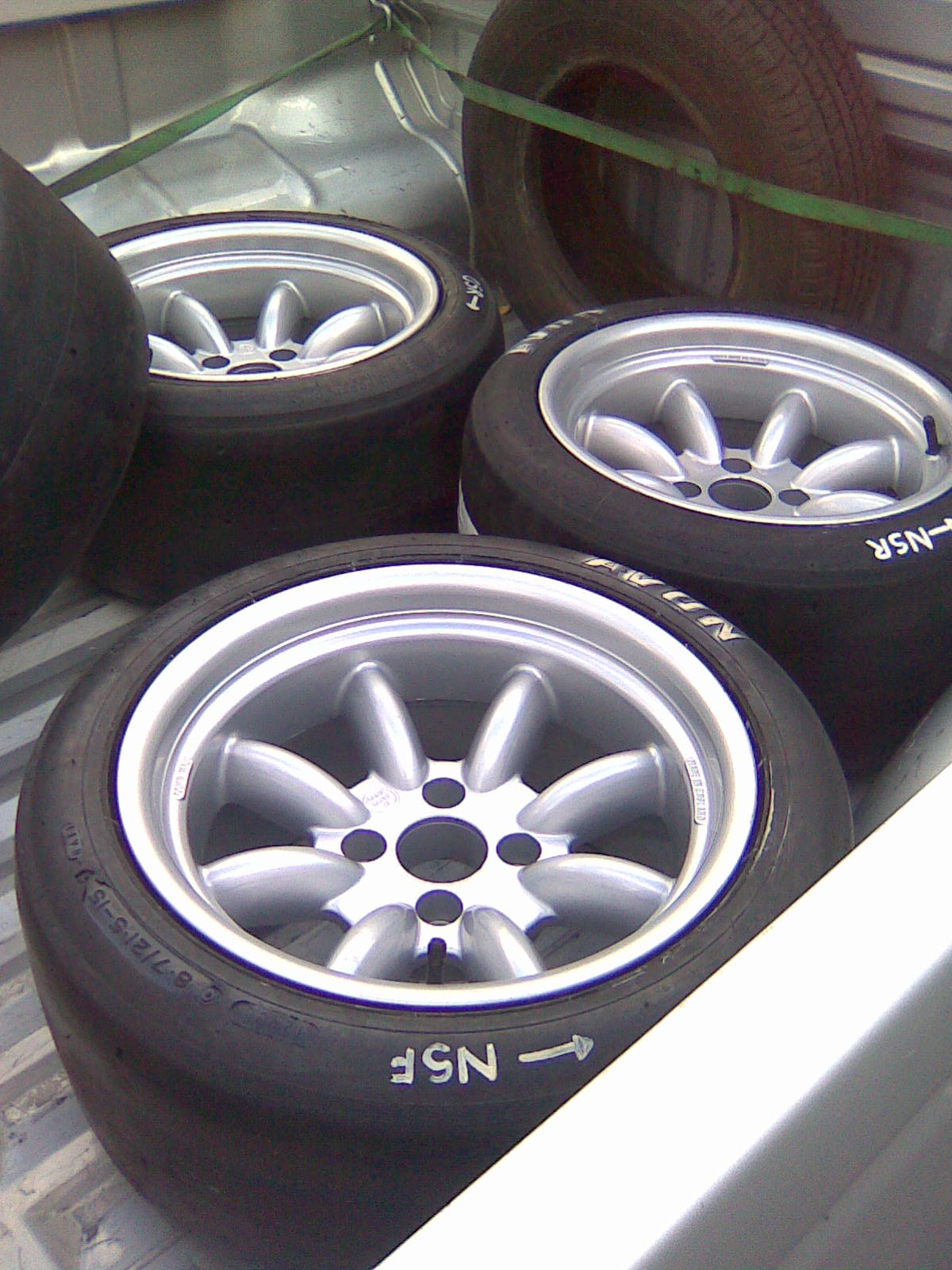

    Mmm nice wheels, keep them silver.
    I see a poll coming on

        Those look amazing Andy, if you don't mind me asking, how much has that lot cost you now?
          #424
          http://www.turbosport.co.uk/showthread.php?t=133080
            #425
            Wheels tyres and arches somewhere in the region of £1500

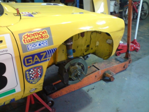

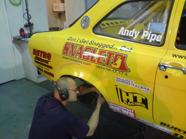

                                Heres a few picks from yesterdays marathon rebuild. The usual team of Gary, the Pipes and myself were helped by Anglia Ant and Cossie Matt
                                Gary marking out the first cuts on the rear

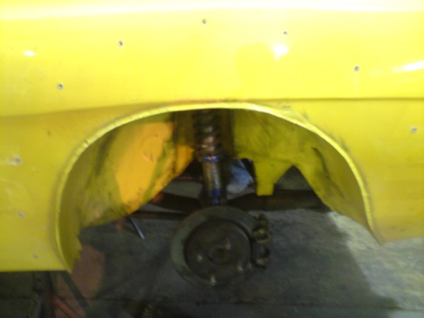

                                Cut made and no rot found so everythings nice and neat bar a little filler.

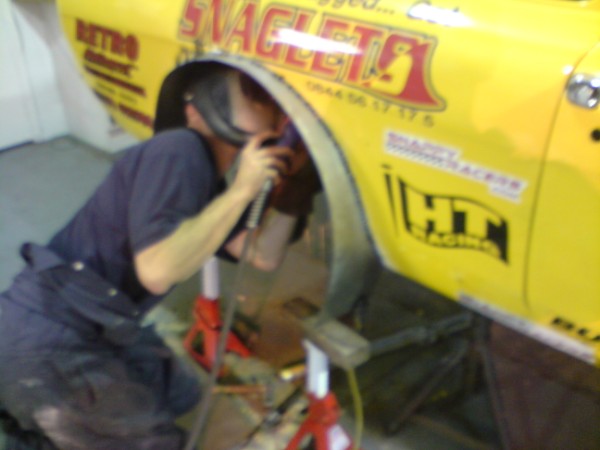

                                Front cut out ready to try a bubble in place. (at least escort mk1 wings aren't worth a lot these days )

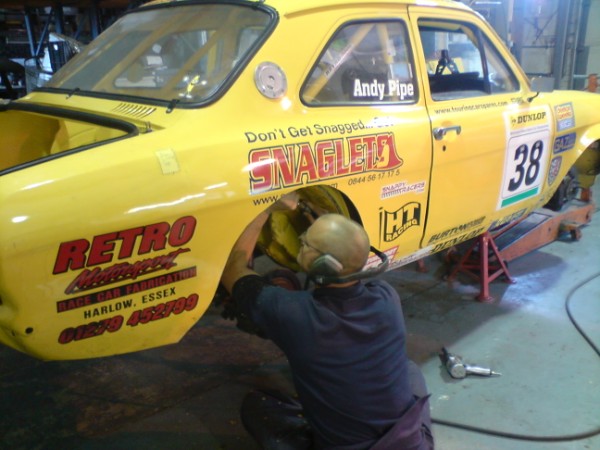

                                Rear inner infill section being laid in, probably the trickiest bit.

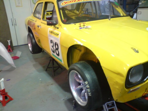

                                All cut out and its time to try the shiny 9x15s with their new avon crossplys
                                A rear inner finished and trimmed up, just dusted over with primer for now. Note the rivnuts in place to hold the arches on nicely
