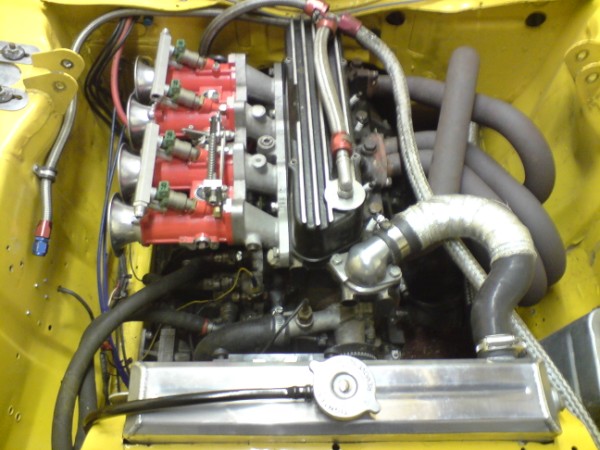

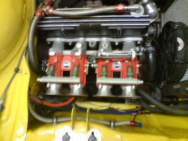

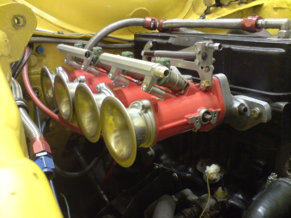

                            Quickly strapped these bad boys on today. 45mm Jenveys
                            They look and fit the nuts and are a credit to their previous owner as they are like brand new still
                            They are slightly shorter than the 50's too so we have a bit more space to play with..
