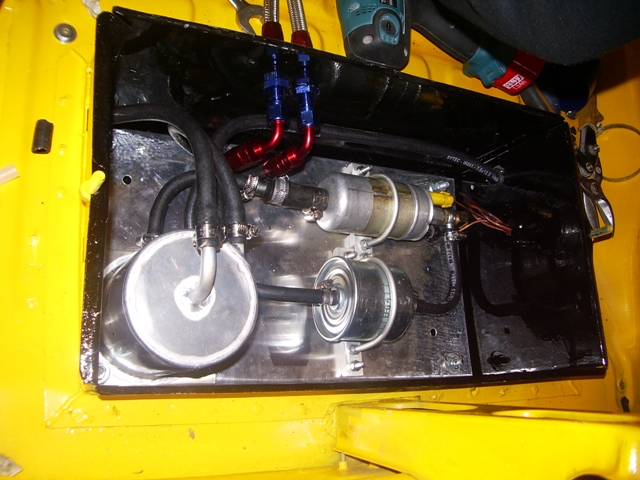

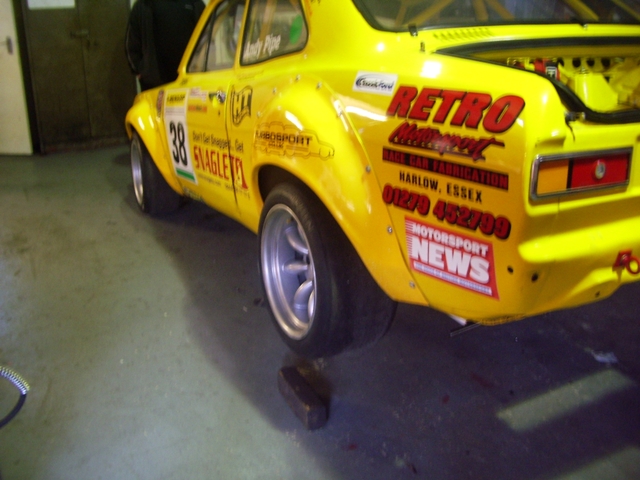

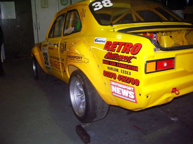

        Bit of an update from the last couple of Saturadys work.

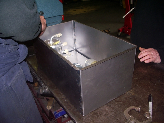

        Due to me not reading the rules properly we had tom replace the alloy box that my dad made to house the fuel pump swirl pot and filter with a welded steel one. so a trip to Retro's was the order of the day.
        The box being made
        and some more piccies just for the sake of it

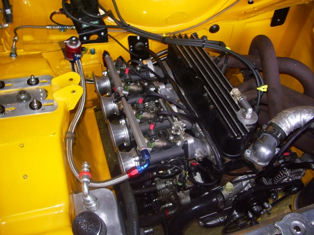

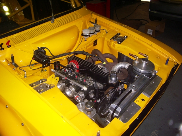

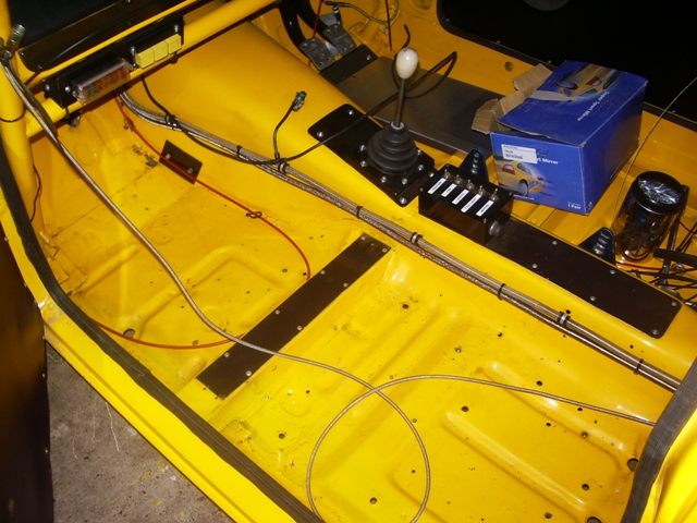

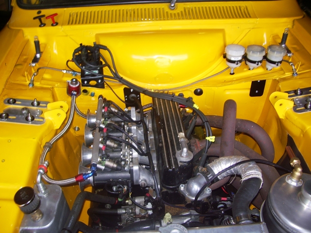

        Spent Yesterday plumbing in the fuel system
        Engine bay finished
        Lines inside the car
        The offending box all finnished
        Jobs left to do:
        New wiring loom
        finish plumbing in brakes and bleed
        mapping
        New diff
        Put in oils and fluids
        Then it ready to rumble
          #619
          And the best thing... using the same gauge steel as the boot floor, the new steel box actually weighed less that the heavier gauge alloy one .. allthough a lot of that may have been the fixing of the alloy one
