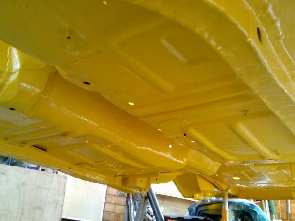

    Few more quick pics from today;
    We finished painting the bottom of the car and under the arches. Should be well protected for another ten years and looks pretty smart IMO

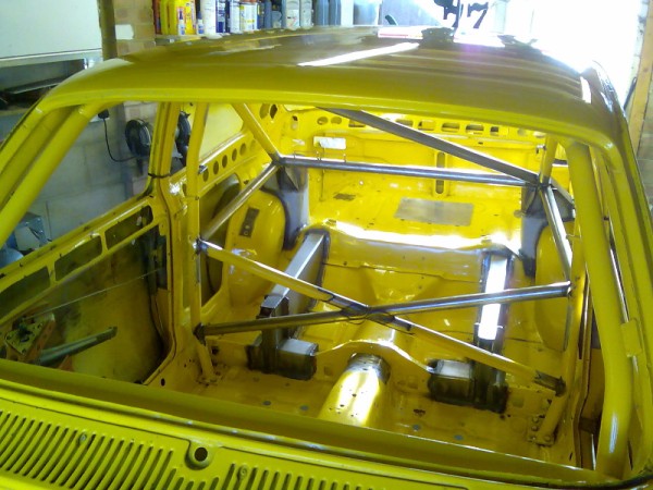

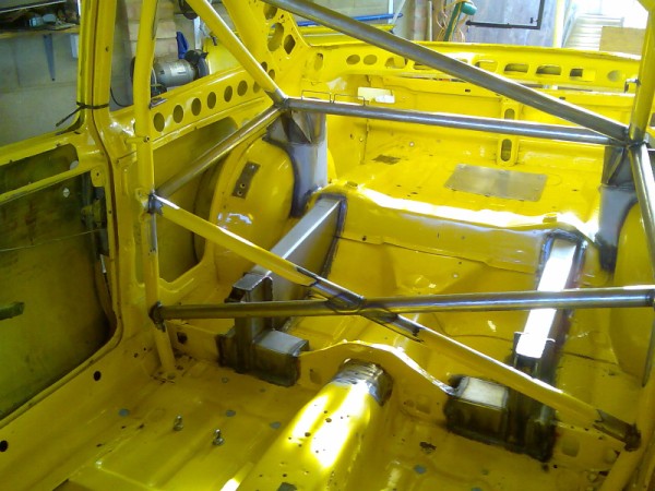

    Inside of the car totally cleaned out, the whole car is completely stripped now, even down to the last rivet

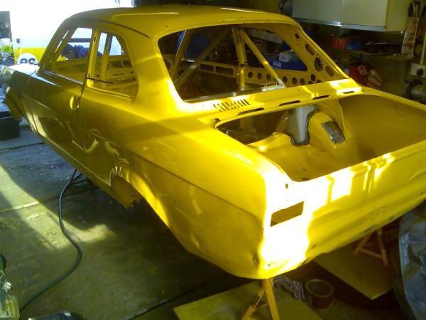

    Bodywork given a quick clean off now that all decals have been removed

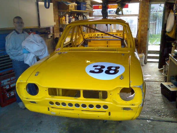

    Thats it, the car's all ready to go for its spell at the body shop tomorrow to give it a blow over and iron out the odd bit of battle damage

      Looking good mate,what paint did you use on the underneath?
        #108
        2 pack
          #109
          And yes.. this time Andy remembered to add 1 and 1 together to make 2 Pack this time... the last time he forgot one part...it was still wet'ish when these latest mods where done

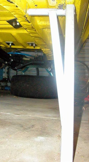

                                Those chassis rails look familiar..................
                                Look like mine
                                eg
                                Toooo many times its been jacked up with trolley jack under rails.
                                Take it Easy....
                                Roger Miller
                                Works-Escorts =
