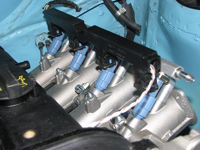

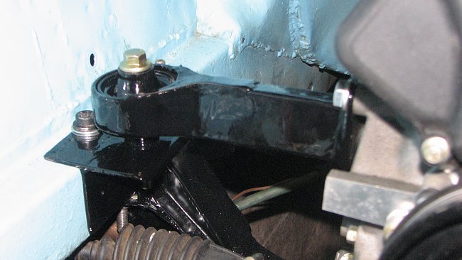

The engine was finally bolted on today. No clearance issues. The trick was to turn the oii inlet aroud. Facing forward. Just need to plumb it around the engine rather that under the engine. Could even lower the engine but the scavenge hoses would rub against the steering rack.

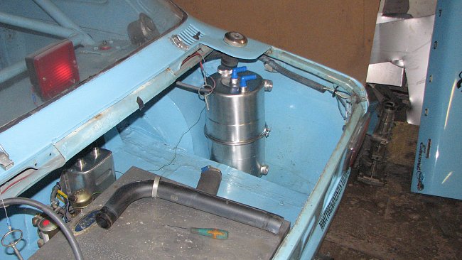

Also started to figure out where to put the oil tank.
Would love to hear some good arguments on whats the right or the best place for it. So far its going in the boot.
