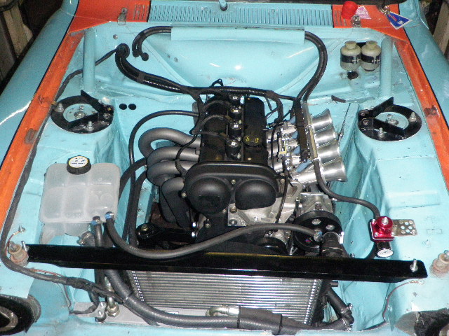

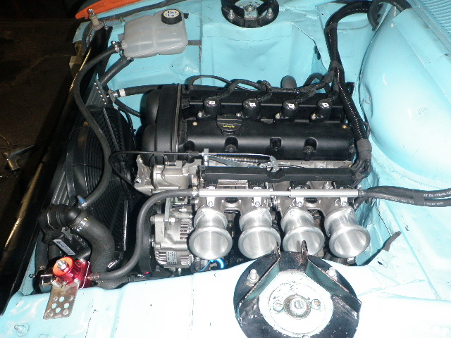

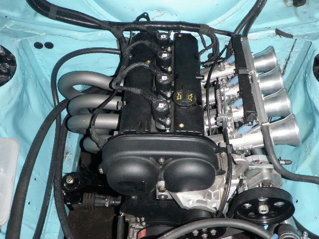

                There it is. All plumbed and wired (except the remote oil filter)
                The trumpets needed massive grinding on the flande to fit the Jenveys. And I made the take of for the machanical oil pressure gauge.
                Tinkered with the air filter but it just will not fit. Need to think of something else. Shorter Pico style injectors would allow the use of flat back plate and that could give some more options. But as for now I get to admire the go fast look of the trumpets
                Noe that it's all there there suddenly isn't so much room around the engine.
                  #323
                  Re: Race Escort Zetec SE (engine build)
                  Excellent work, well done
                  I bet you can't wait to fire it up!
                    #324
                    its certainly looking good
                      #325
