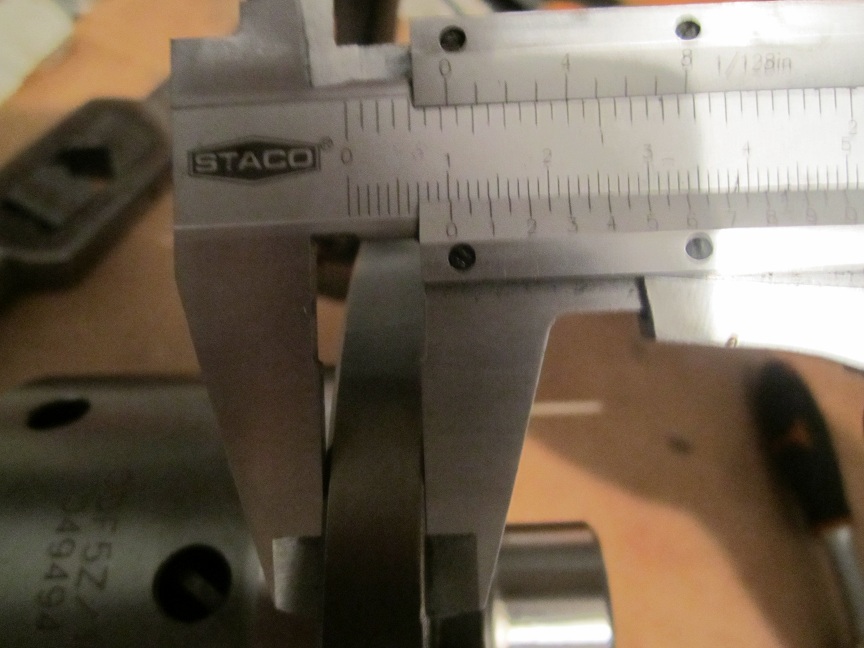

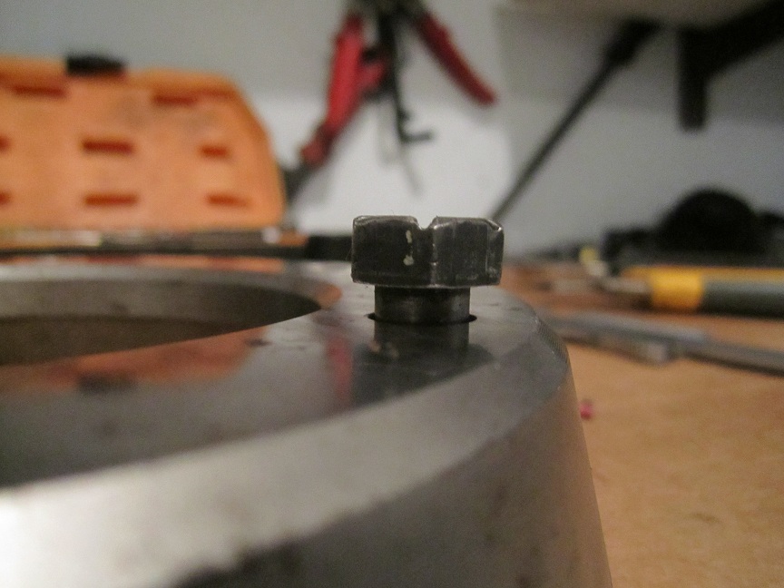

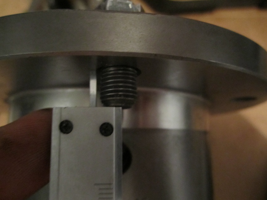

                    Haven't exactly been busy with the builds but checked the CW bolt today.
                    Leaves me 4 mm under the head when bolted down
                    The LSD flange is 10 mm thick so these bolts are not too long. I started thinking if they'd be too short.
                    Measured 9,5 mm of thread for the cw. That beeing the width of the bolt I reckon it is enough. If the general rule of thumb

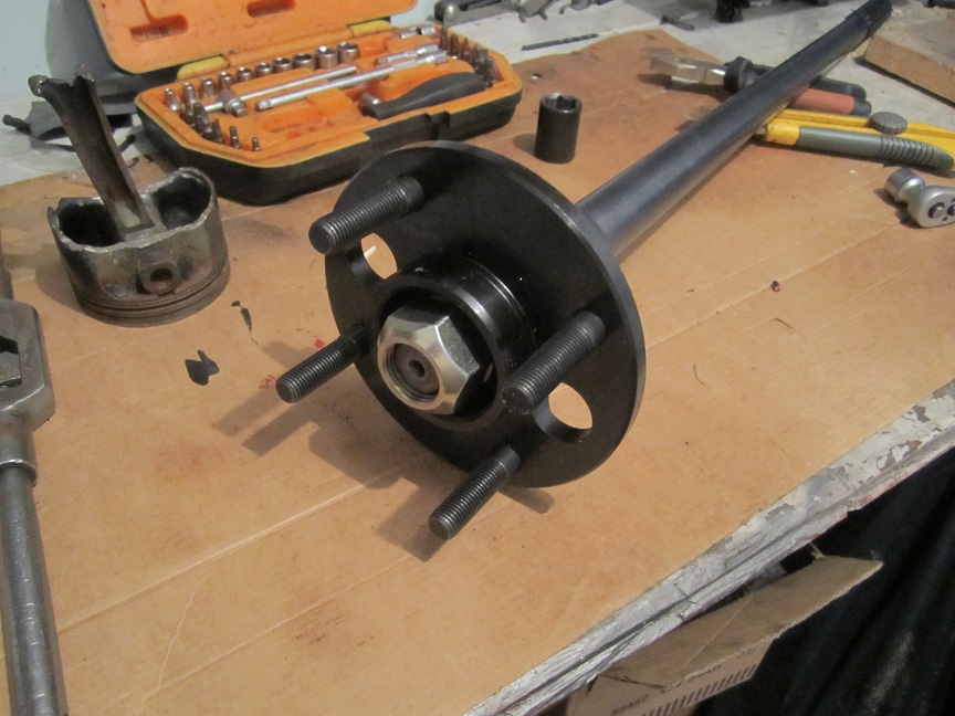

                    And punched in the studs to the flanges. 1/2 shaft flanges I was surprised to see quife has not splined the stud holes. Was a tight fit though.

                      Look at the size of the chamfer on the end of the bolt - in fact you've probably only got 8mm of thread engagement... But if we're starting to get that picky, then you could argue the holes in the diff are too big anyway, and the bolt should have a longer shoulder (snug fit in the hole) etc. If I were you, i wouldn't worry, use those bolts - history says they'll be OK (if threadlocked properly)

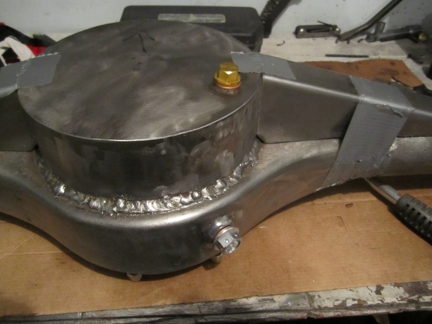

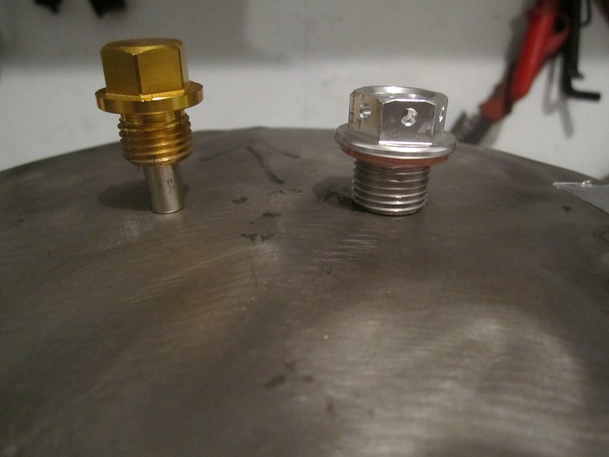

                          While back made a quick decission to weld on a oil drain plug from what I could find fromme garage. I ended up with a 9/16 BSF thread and had to make me own magnetic drain plug since none was available off the shelf.
                          However I ordered a magnetic plug for the filler plug. Only then I realised how utterly weak the DIY plug was. So picky as I am I re tapped the drain plug hole and ordered me a new plug.
                          Wanted to show you fellas these I thinks their brilliant.
                          Alloy so weight next to nothing, costs practically nothing and still have very strong magnets.

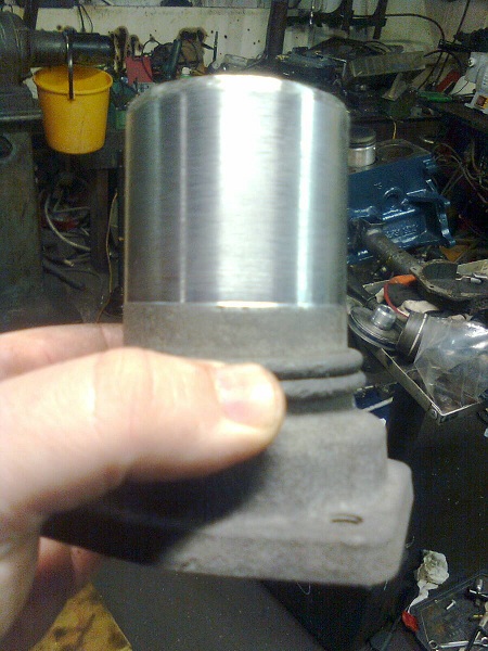

                              Nice job, that is what I was thinking of, a nice press fit over a long length and the weld for some additional strength
