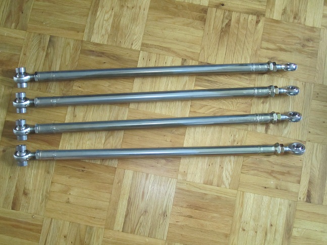

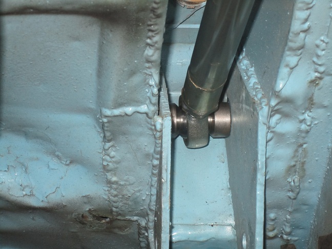

    You can always check the free movement of the axle with dampers and springs removed, put the car on jackstands, support the rear from the center pumpkin in different heights and rock one end of the axle up-and-down, you should feel if there is any significant bind. If there is, something will develop fatique cracks and fail.

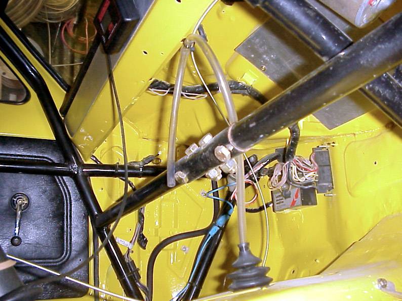

    My own 3-link+phb full uniball setup articulates through all suspension travel without any resistance, maybe you could consider using this system - just add one bracket to the rear axle on top of the pumpkin and do a little modification to the propshaft tunnel "under rear seat" to make the body-side attachment point to the single upper link.

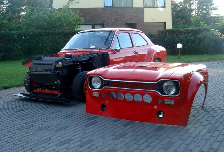

      What else than Mk1
        WOW!! That looks agressive! Simply awesome! Whats the engine in it?

          My car has never competed but is more like opentrack-type hobby car, now it has also full FIA cage etc. Engine is boring compared to yours - 2.0 Zetec silvertop, stock internals, motorbike ITB, Megasquirt, homemade 4-1 headers.

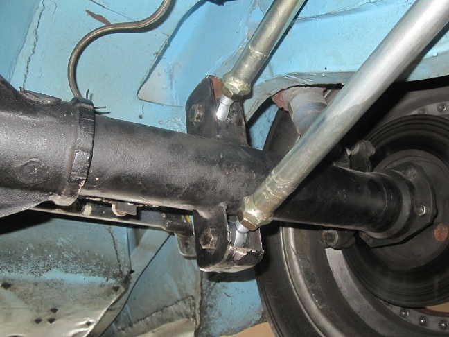

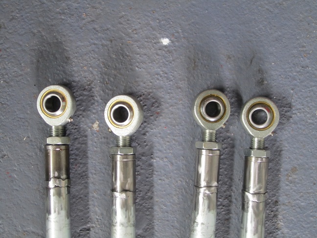

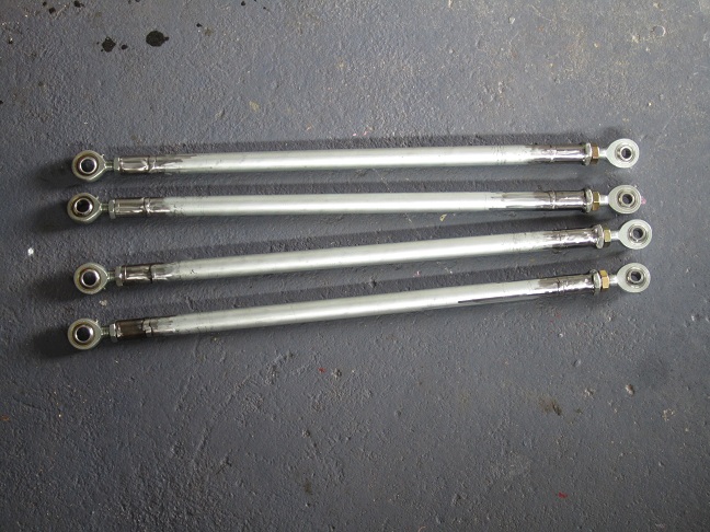

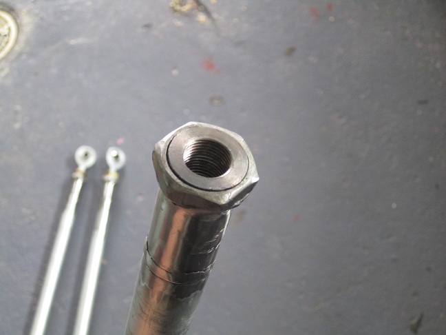

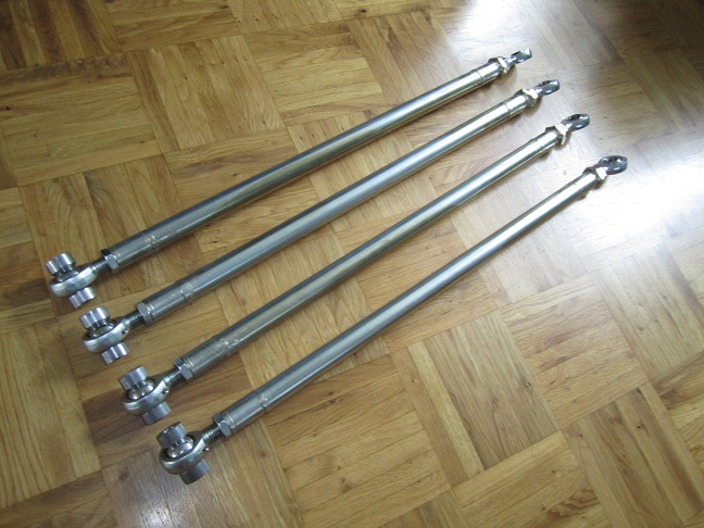

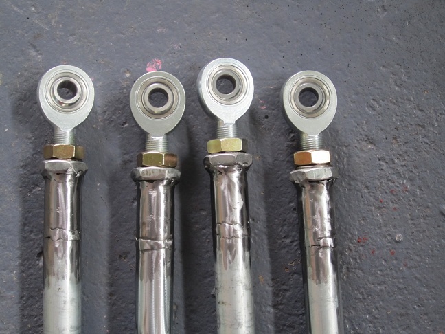

            Did some welding and grinding yesterday. The new adjustable 4 link bars are now done. Only painting or plating left to do.
            Not the prettyest but functional and strong.
              Now zinc plated and ready to go in.
                Very nice
                  Thanks Dave !
                  They're in now and surprisingly with no issues yet. knock wood. Still not sure how to open ot tighten the front locking nut....
