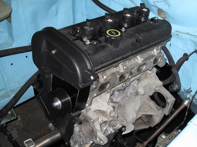

                          Got the bottom end back today from the machine shop. Now re ballanced for the new flywheel.
                          Hopefully I can take the time this weekend to build it up.

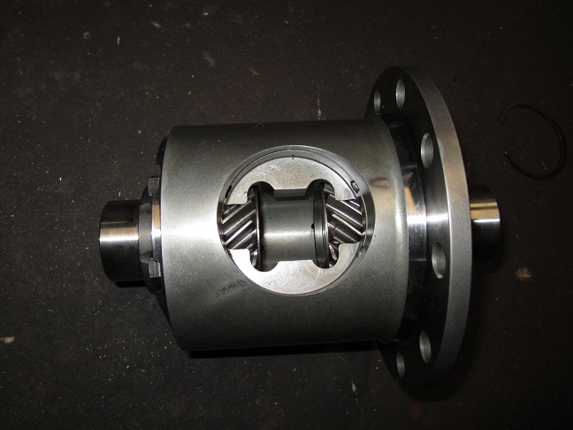

                          Also got the new LSD today

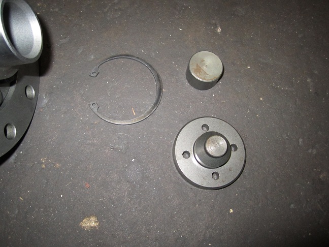

                          It has some bits for the regular C clip axle but since mine is modified for the 9 inch housing ends I will leave them out. I see no use for them.

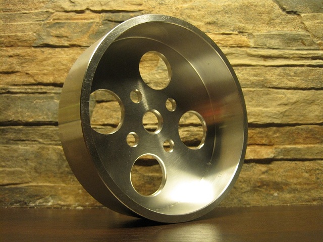

                              Some bling. The water pump pulley is finished and fresh from the lathe.
                              Mui bien.
                              And its even lighter than the original item
                                This is the diff to have, currently.
