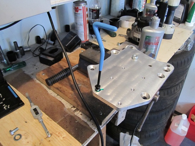

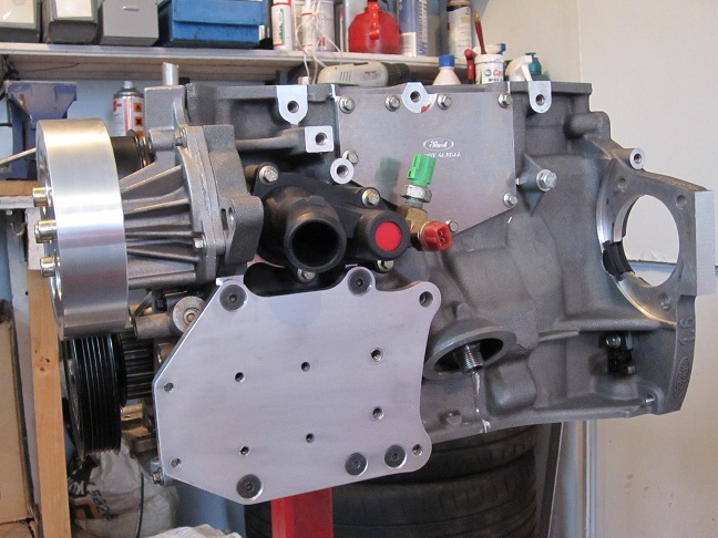

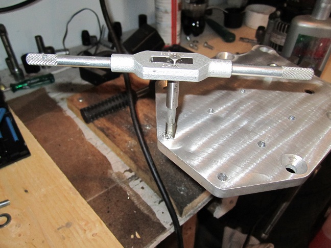

    Treated the backplate today with all new Helicoil threads.
    I just love these coils. I bet theres no news here but few pics of the process.

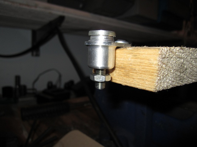

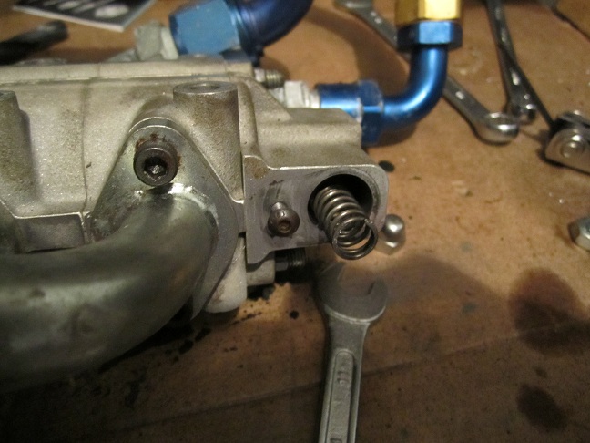

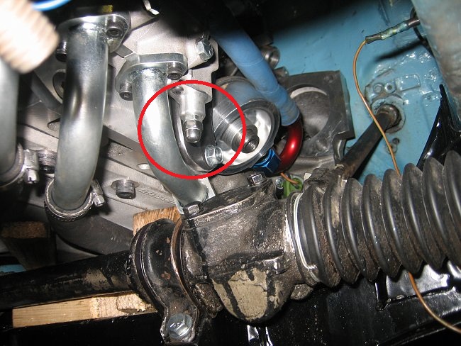

    Next is the oil pump. It developed a drop of oil in the the tip of this domed nut. And no oil leaks above the pump so I assume its the pump itself thats leaking. Any ideas on what this bolt is and what could be leaking? Would be nice to know before I open it up.

      looks like pressure relief valve adjuster under it to me
        So an O ring or more lilely a copper ring leaking?
          • 25239
          if its like my pace pump, the nut under the dome wil be a nyloc over a stud with a screwdriver slot in it
            You were right Graham.
            Under the domen nut there was the pressure adjuster shaft and a locking nut. Non nylock though.
            Took the relief valve out and it was sealed with an O ring to the bore in the body of the pump.
            So I gather the two most likely place to leak would be the O ring, which looked fine though, or the adjuster shaft itself. The shaft would not want to screw out so I cant really know untill I try it with the new O ring. If it still leaks I think I'll need to re investigate or renew the relief valve.
              I got some advice from Mr. Rossin at Titans. He told that it is pretty common and olny normal that the oil creeps along the threads on the PRV adjusting bolt. And that a little loctite would be the solution.
              I prefer a non curing thread sealant. If some should somehow end up in the oil flow its unlikely to cause any issues since its not tough.
              So hopefully even this minor detail is soon sorted.

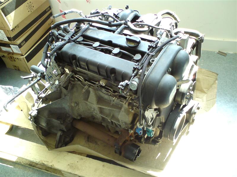

                My engine turned up yesterday - not quite as shiny as yours...

                  Your engine has some nice magic solenoids in the head though....
                  Someone really took his time removing than right side drive shaft.
                  You even got the A/C compressor with engine that is a bargain.

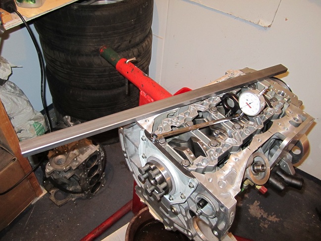

                    I could not resist trying out the new spanner.

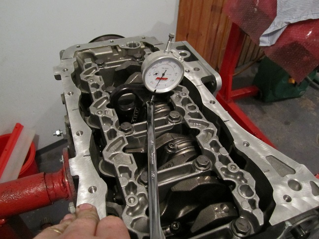

                    I may have d´said earlier that the strech method is a simple traight forward job.
                    I take it back. The main girdle really made it quite tricky. And streching the bolt for 0,0055-0,0060"
                    proved not bee a walk in a park eighter. Even with the new longer HD spanner.
                    But they're all now tightened down.
                    For future engine rebuilds I'll utilise a snapped main girdle I've saved and make 5 separate temporary main caps to hold the crank down while streching the bolts. Should make it alot easier and give more room for the gauge and the spanner.
                    This metal bar was used as an etension for the spanner. I wonder does the Snap On warranry still stand. The last 0,001" was really tight.
                    Would be nice to see wheter the ARP2000 bolt would be as hard to strech as these ARP3,5 bolts

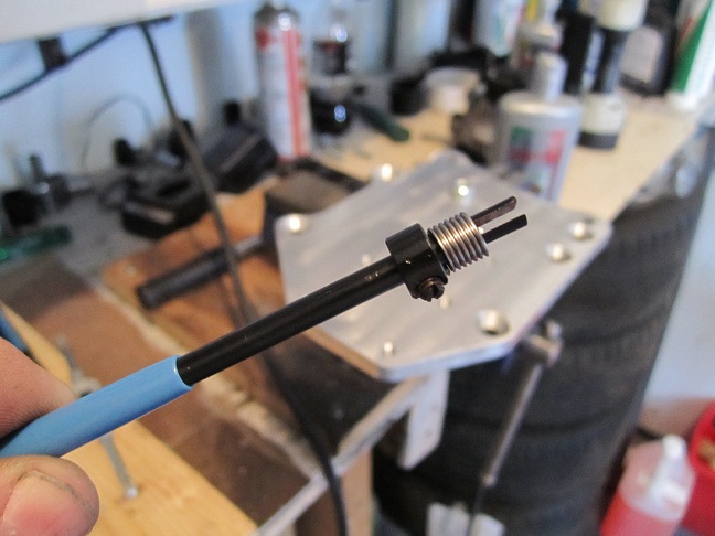

                    Now I need to re install the PRV valve to the oil pump and I can re mount it.
                    Then the oil pan, flywheel and the cluth and the bottom and would be ready for the revised head.
                    Heres the PRV valve. Did not leak oil when left for a day so I guess theres nothing terminally wrong with it.

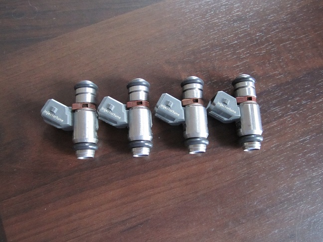

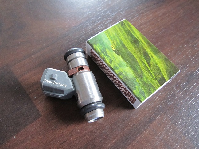

                      The new injectors arrived today.

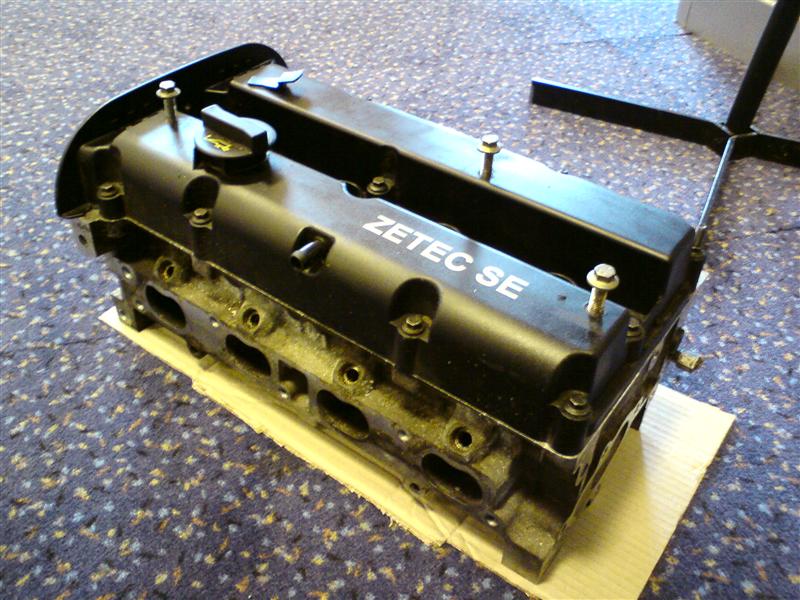

                        If you are serious about wanting a VCT head, then drop me an email - I've bought that head I showed you, off the 'Bay, not got my hands on it yet though.
                        Yeah it's a typical scrappy removal job, pulled the tripod joints apart on both driveshafts, and loads of hoses and wires cut off rather than unplugged. There's plenty of bits to strip off it and sell on though... gearbox, air con, power steering, induction, alternator...
                        I pulled the plugs and turned it over by hand earlier, just to check it wasn't seized. Need to get it back home - it's currently sitting at the office - but it's feckin' heavy for a skinny boy like me, and my main car is an MX-5, so can't exactly pop it in the boot!

                              What cc are the injectors? Can't remember exactly what mine are with the AT Power TBs, but 330cc rings a bell.
                              My head just turned up...

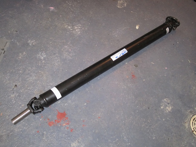

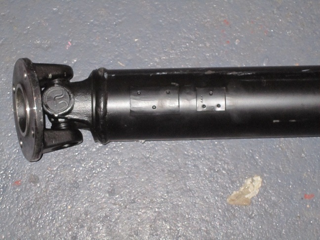

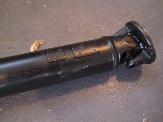

                                Got me a new propeller shaft today. To replace the old too short one that needed a heavy 40mm iron spacer to work right. Good weight saving to get rid of the almost solid metal spacer.
                                Not too sure on the quality though. Seems like a lot of ballancing pads were needed in this one
