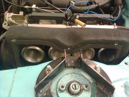

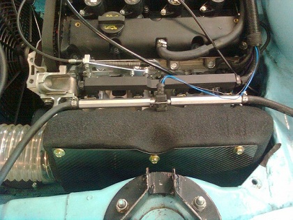

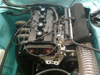

    Anyway here's the pics of the airbox fitted. Turned out nice if you don't mind me saying. And the reduction in the induction noise was dramating.
    So much for the serviseable engine though.

      Great to see that box there , I shudder when I see cars running open trumpets . The whining.. could it be the dry sump? Or the alternator?
