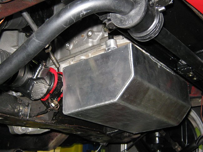

                Originally posted by scott105e
                hello can i see some pics of your sump mate
                Photos attached, hope this assists

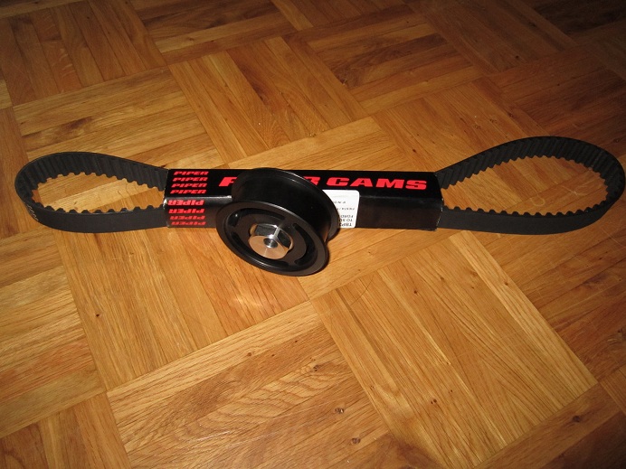

                  iirc on BDA's the belt on a BDA always whinned like hell.
                  I got some confirmation for the BDA's whinig too. So may well be as said earlier, the high spec all alloy engines with fixed tensioners may be prone to whine.
                  I received the new belt and tensioner today. The belt feels no different to the hand than the Ford or Gates item. The only difference is the OE belt has a tiny groove in the tips of its teeth as the Piper and Gates items have plain round teeth.
                  But the tensioner certainly feels more robust and solid than the OE YB tensioner that I used. No slack or movement in the bearing like the Audi and YB pulleys. And does not spin freely like the YB tensioner did.
                  These are going in tomorrow and after that it is what it is.

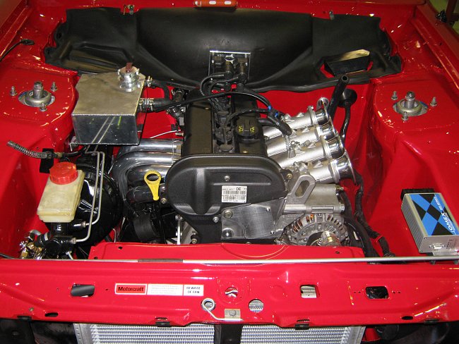

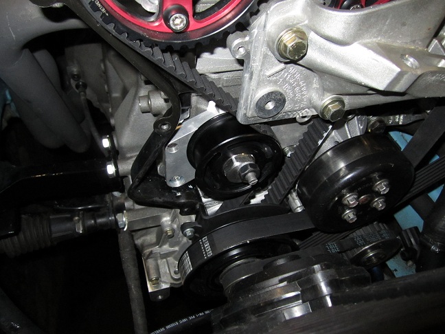

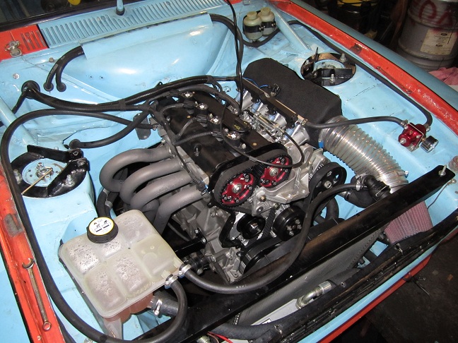

                    All done.
                    The whinig, the sound resembling a broken power steering servo, is deminshed to a slight mechanical sound. I guess that is the sound it is supposed to make
                    Ready for the rollers......again.....I hope now it is time for my luck to turn. I still have plenty of time to make it to the third meeting.
                    Few quite pointless pics. I'll leave the cam belt cover off for the time beeing. I want to keep an eye on the pulley and the belt for a while.
                    Still need to make a new strut brace and change that fule hose from rail to regulator to a longer one.
                    For the evo two I think the engine will be moved 5cm to the left. It's quite crouded on the right side. Not so service friendly.

                          Re: It's a loud boy !!
                          loving that airbox, very neat indeed
                          www.gulfpetrolheads.com
                            #403
                            Thanks. I'm happy with the out come of it too.
                            It's a complete nightmare to install and remove though.
