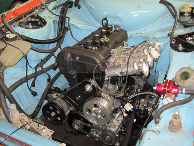

    The 'evo' engine looks great, well done

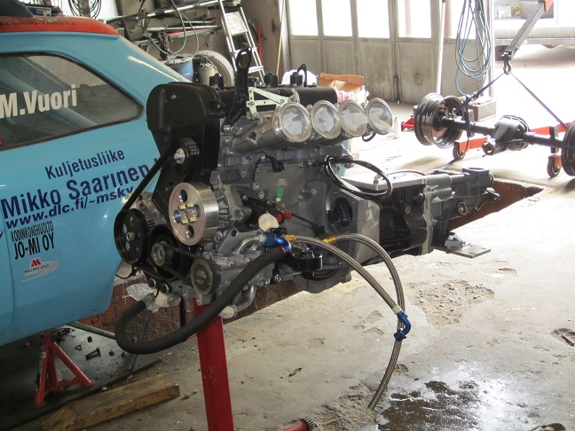

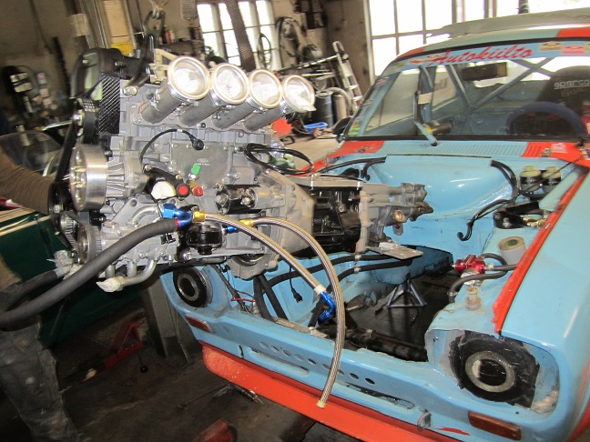

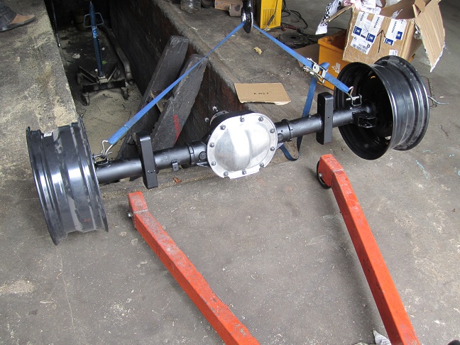

                  The engine is now in as is the rear axle. The new Pico injectors caused no issuea nor did the new alternator position or even the rear axle. What dis however cause some was the new propeller shaft. It is one cm too long. I couldn get it in place if the car would be on its wheels but it still would not have any movent inwards
                  Need to get it shortened.
                  Oh why is the start of every season such a mess and chaos. Three weeks and counting. Once I get the new manifold all done I still need to make it to the rollers in time.
                  And as if the schedule wasn't giving me enough grief a sudden family chrisis struck. The missus got laid off work
                  This really puts a strain on the racing budget and calls for some re prioritizeing of things. The start of the season is very questionable now...I'll still try and make the car ready in time even if I were not to enter the race.
                  Axle after a new coat of rattle can matt black
                  Very chuffed about the new alternaror position.

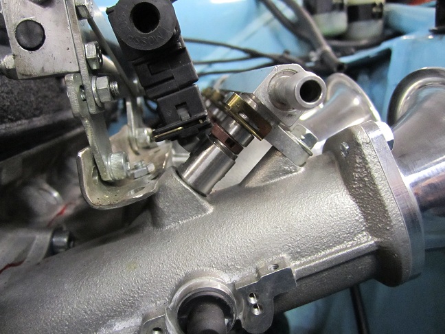

                  The new injectors are brilliant. So tiny and deffo will not get in the way of any airfilter.

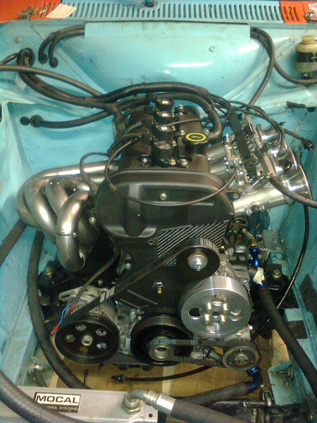

                        But to ballance things up i got one more thing on my list. I test fitted the new manifold and the collector sat quite near to the floor. Much more so than it did with the surrogate engine I just while making the manifold. I must have had the angle of the surrogate wrong and now the collector sits too high. I'll have to see if I can fit the exhaust pipe to it or do I need to modify the manifold somehow

                          in the above pic , the mani looks like a professionally built one , by a specialist! So I really hope you don't have to modify it...

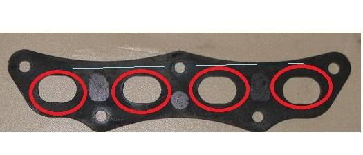

                            Would it be wise to weld the pipes to the flange in different heights.Since the pipes have larger bore than the ports in the flange I could move the flange position a bit.Tilt the manifold back a bit. The no 1 pipe highest and no 4 lowest. Not trying to center the pipe to the hole in the flange? This would propably do it but would this have some effect in the flow?
                              I remember reading in the excellent Modern Engine Tuning book by A G Bell , that it is best to have the pipes larger than the head , and IIRC, they found differences in the power by adjusting them higher and lower . ?I'll dig it out tonight and copy the text for you .
