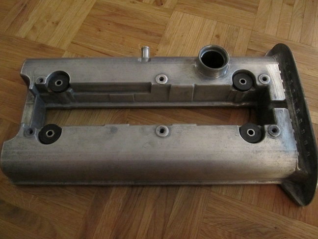

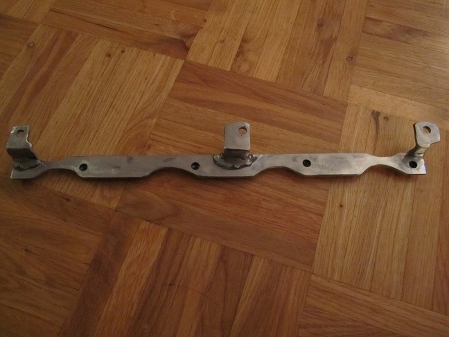

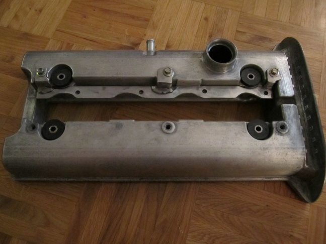

    Instead I spent the afternoon making another bracket as long as I still had the head with me.
    The early model cam cover seems to fit. So I'll use that for faster and easier removal.
    So I needed a bracket for the coils.

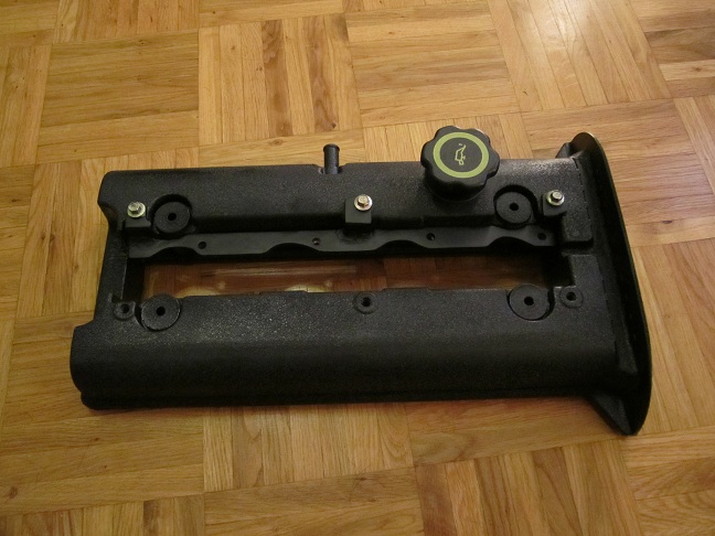

                      Anyway I tinkered at home and got the the cam cover done. I hoped to cut and weld shut the oil filler hole for the dry sump look but since ford claim this cover to be magnesium alloy I chickened out on the welding bit.
                      Wish this cover would have some lettering to polish. I really like the look of the raceline Duratec R cover.
                      But this will do.
