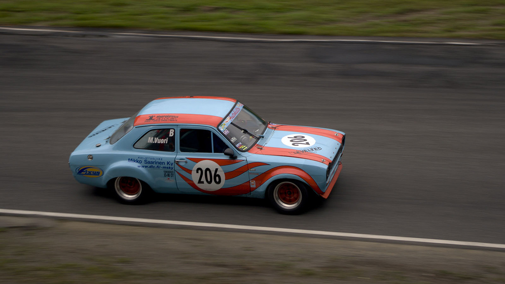

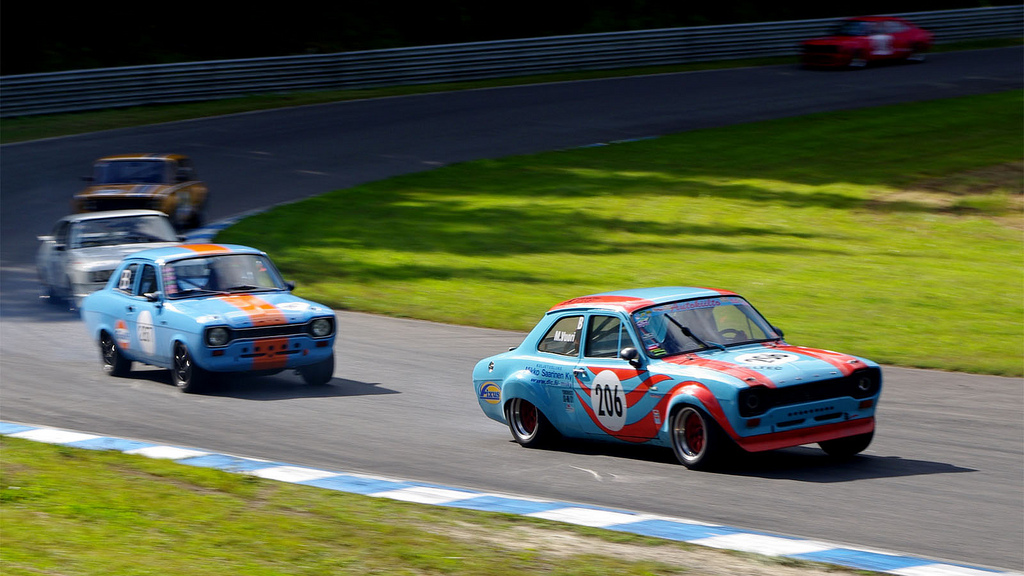

          Just wanted to share these two pictures from the last event.
            Re: I'm ready
            Nice pics
              Re: I'm ready
              Thanks DW.
              The lower shows nicely the suspension at work. May even need to stiffen the dampers a bit.

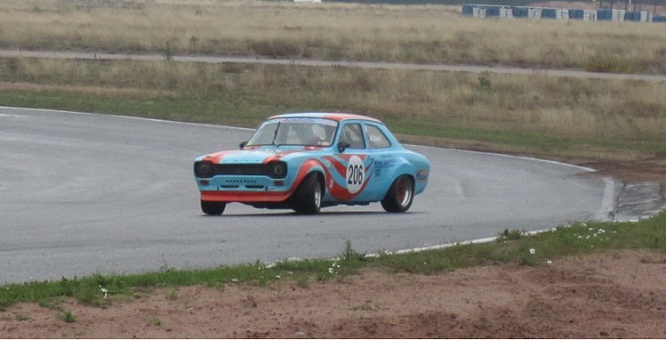

                      Couple videos the missus took
                      The high reving sound from the back ground is an R1 Engined Imp

                        you were struggling foe grip there! That first vid , with the drift on , encapsulates EVERYTHING I love about Mk1 Escorts.. Thank you sir!

                          Yes virtually no grip at all ! But as long as theres even some to be found for the front end I don't mind.
                          Seems to suit well for me and the car.
