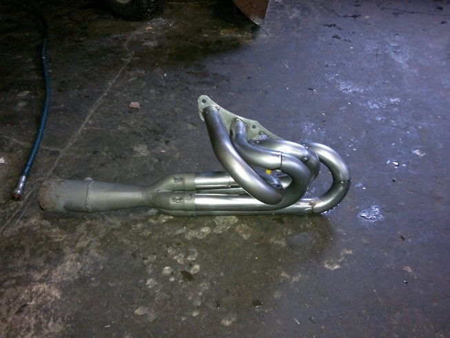

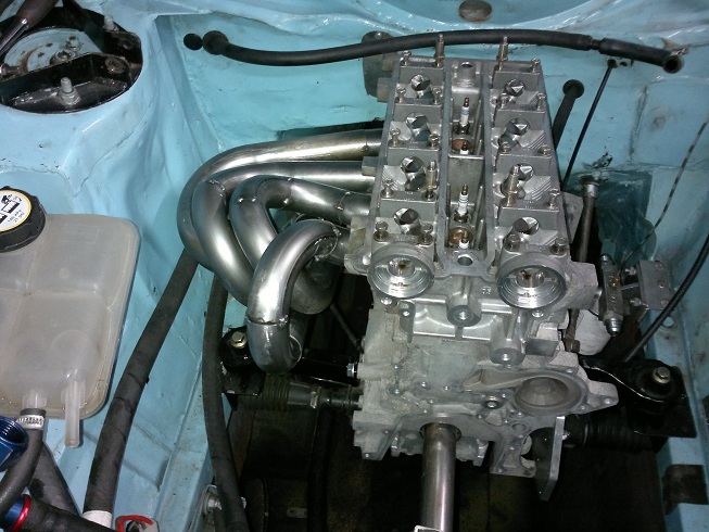

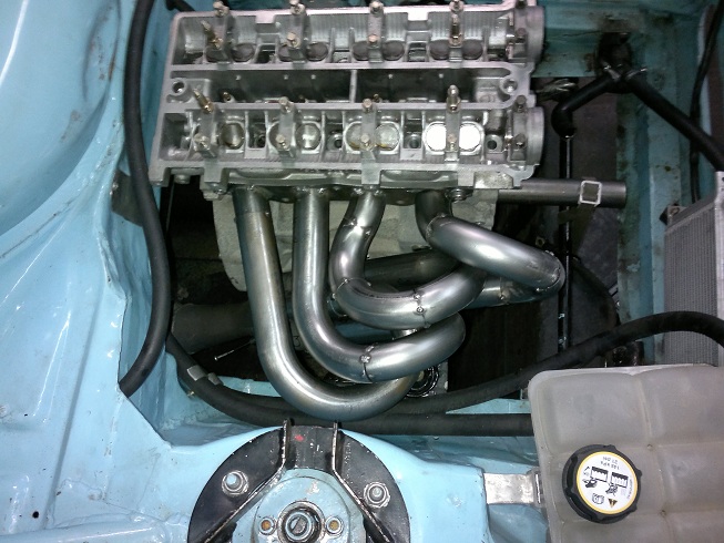

            Hope you don't mind a few (too many) pics. It's just that I'm quite chuffed I got this done. I keep waiting for something to turn up and bite me in the ass but so far it all seems good.

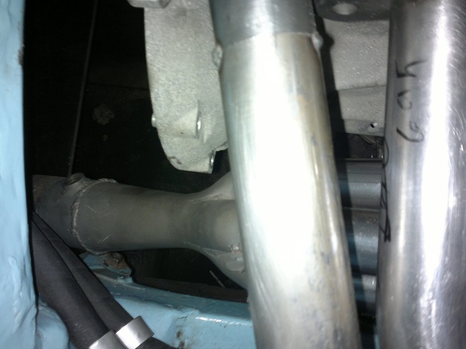

            The collector sits neatly between the chassis rail and the engine block. Tha clutch cable will propably need some heat sleeve.

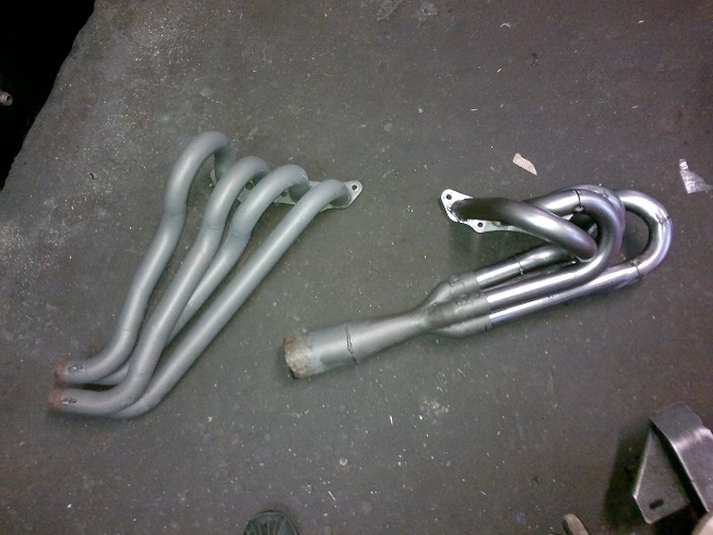

            Evo I and II. Dyno will tell if the evolution has done any good other than raising the collector.
