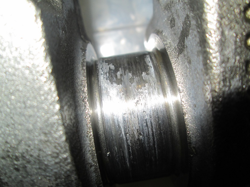

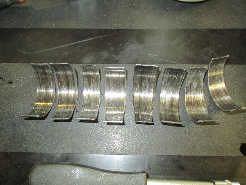

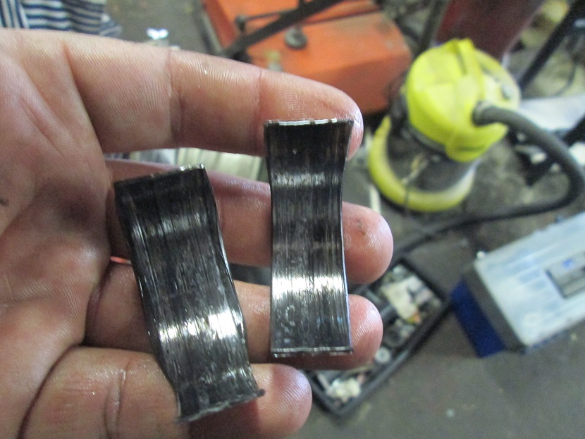

      Oils pressure is gone and I hear a distinctive tapping sound. Most possibly big end bearings, crankshaft and perhaps some con rods need replacing. It suns on all 4 and all the bits are in the block thats the good news.
        Sorry looking bunch of shells

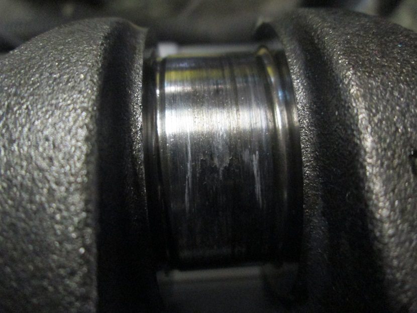

        And the crank is not all that shabby either. Now I'm thinking is there material from the shell on these journal
        or are they all just hidious scrub marks.

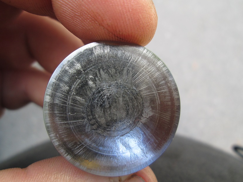

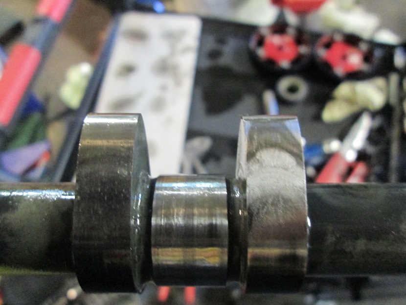

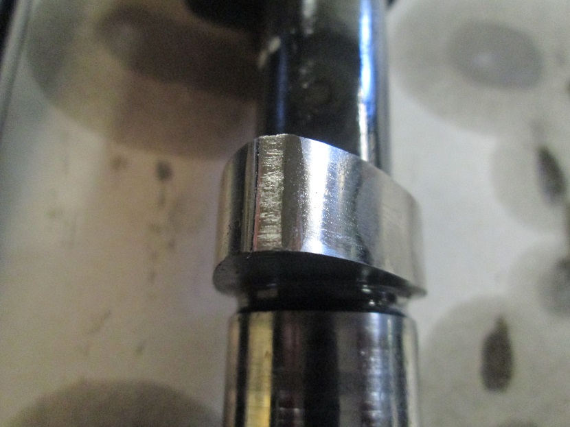

            More sorry looking bits... 7th inlet lobe... throw me a bone here.
            I need a new crank, have it ballanced and key way'ed, new set of cons, have them ballanced, full set of bearings, new tappet and either re grind to the cam or weld and re grind... and 4 weeks time to do it inllcuding engine build... I feel like I have enough on my plate.

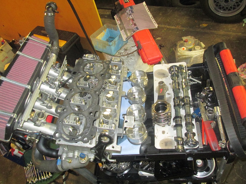

                  situation rep: new crank sorted and key way machined. About to order new shells and rods. As the rods arrive I've booked them and the crank for ballancing and the cam will be welded and re ground next week too. So the assembly may well begin in a fortnight. And I'll spend the rest of my summer leave in the garage pennyless... as usual. I love motorcar racing =)

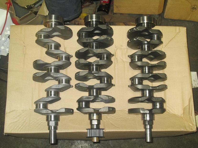

                                "Honey it wont take long now. I'll just sort this lot out and I'll be on my way"
                                The one in the middle was juust right. Now key way'd and waiting some rods and a trip to be ballanced
