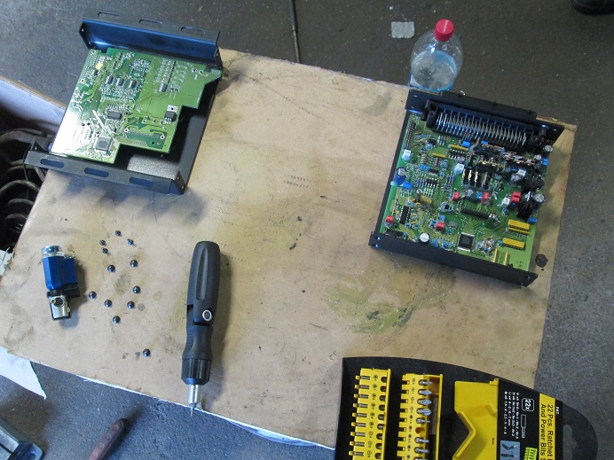

        This is us fixing the ECU last thursday with instructions over the phone. Felt like disarming a bomb or something. You know , cut the red wire and stuff...
          #1339
          Got it! Too bad we're two days late. It wasn't the coils or the plugs. The short circuit in the ECU messed up the base map completely. We loaded our old map but oddly that could not take any load either until we added the opening time of the injectors. Now running rich but it is running and more importantly it now can handle some throttle. I think I'll hook up the new exhaust and visit rollers soon.

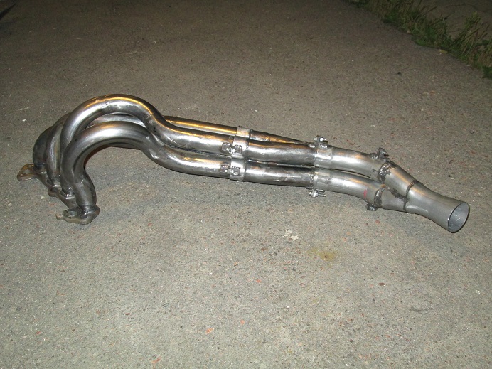

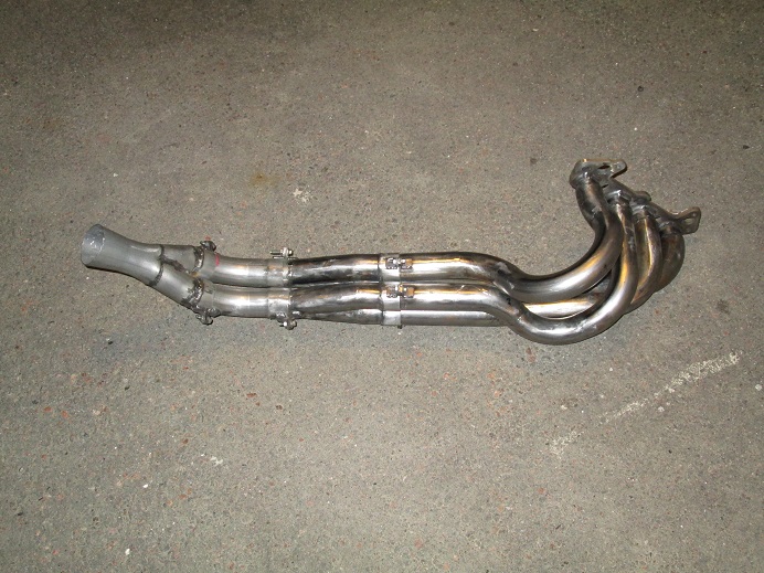

            Picked up the new manifold and welded on the rackets to hold the bits in one piece. The new mani goes quite near the oil lines so I'll propably need to try and re route the lines or insulate them really good. Any suggestions on good insulation material? I'm thinking a sleeve of some sort. If the lines were to melt / puncture the oil would not spill on to the manifold but drain elsevere wthin the sleeve. And I can duct some fresh air feed to the sleeve.
              #1341
              It came out rather heavy so I'll propably need a brace.

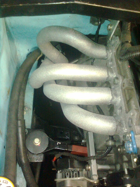

                  Manifold blasted and ready for its DIY ceramic coating.
                  Has a nice disco look to it now.

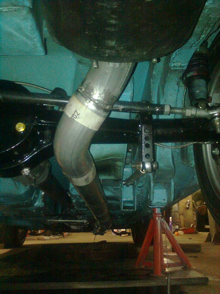

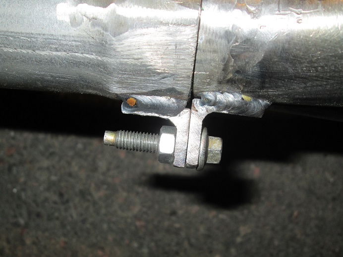

                  The reason its bolted to the engine is that I've been making the new exhaust pipe for the new manifold.
                  Nearly cost me an arm and a leg. It took one tetanus shot four stiches and a black nail to get it done
                  Now only needs three brackets and its done.
                  Leaves me a "healthy" 65mm of ground clearance too

                      I thought I'd double protect the oil lines. With thermotech wrap, and a sock on top of that. And the ceramic coating on the manifold will help to some extent. But still I will need to try and get more clearance between the oil lies and the manifold.
