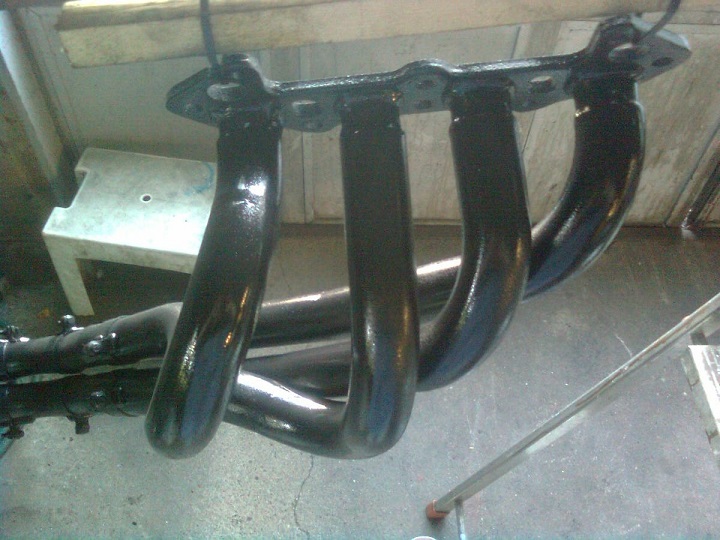

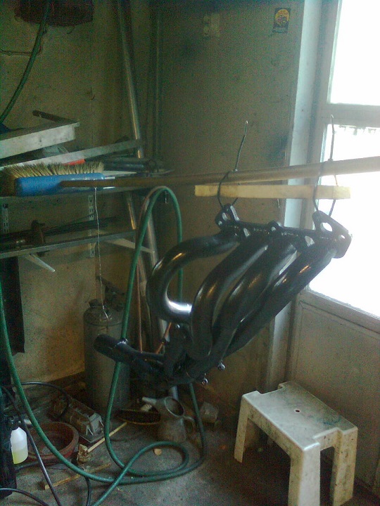

    Thought I'd stick in the new manifold on while I'm at it to see how it performs. So I needed to spray on the coating 24h before installing.
    The coating was very thin and left the media blasted surface quite grainy. Propably blasted with too coarse media for this coating. Nevertheless It does it job protects against corrosion and even more so acts as a heat insulation. Looks almost like cast plastic when dry.

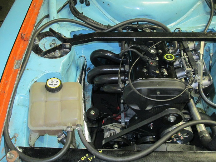

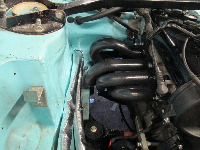

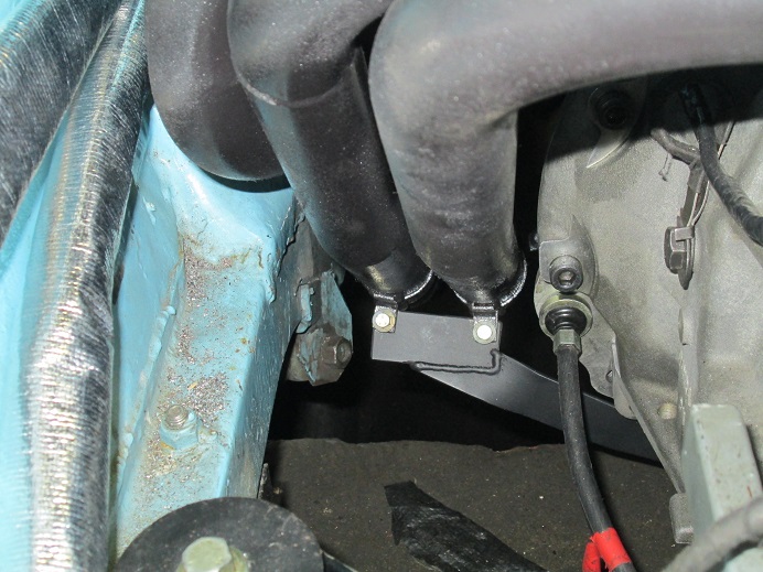

            Manifold and the rest of the system installed for good today. Made an additional bracket for the manifold for added support, installed new fuel lines and re routed the oil lines. Busy day but I'm very happy with the outcome.
              Got the official test chart. Maximum flow cc/min was 288cc worst and 342cc "best". Dynamic test showed 27cc's in worst and 39,6cc's in the best.
              The car now seems to hesitate when starting to move and stalls easily. But soon picks it self up and can now take load. Only the new mani seems to leak from the overlap joints and may throw the lambda off so I need to take it out and seal the joints.
                Sealed the manifold , dropped the fuel pressure to 3bar and re calibrated the throttle body. Now the car acts nicely. The TPS had trouble noticing the tiniest openings of the butterflys. Hence the hesitation and stalling when calmly lifting of the clutch. After re calibration I feel the car is ready for rollers. The maps are obviously off but now it moves and can deal with load. I'm booked for thursday evening. And hopefully on friday morning I'll be off to the season Finals.

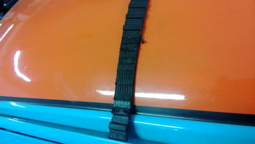

                          Yeah, if the dry sump belts could just stop snapping. That would be great.
                          • RWD fords rule
                            • 3579
                            Have you space to fit a wider set of pulleys and a decent strong dry sump drive belt, honestly I think that the usual dry sump belts are just waiting to fail, they are the flimsiest things I have ever seen & they keep the engine together, the only thing I would trust those little belts to drive is a sowing machine lol!
                            Good work with the manifold, I was expecting more mid range with the relatively small pipe diameters and long primary lengths you chose, great that the top end is the same as before, very best of luck with it

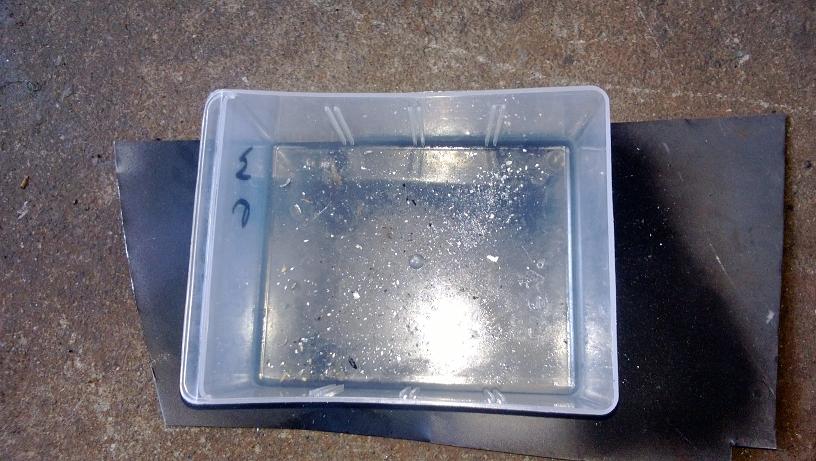

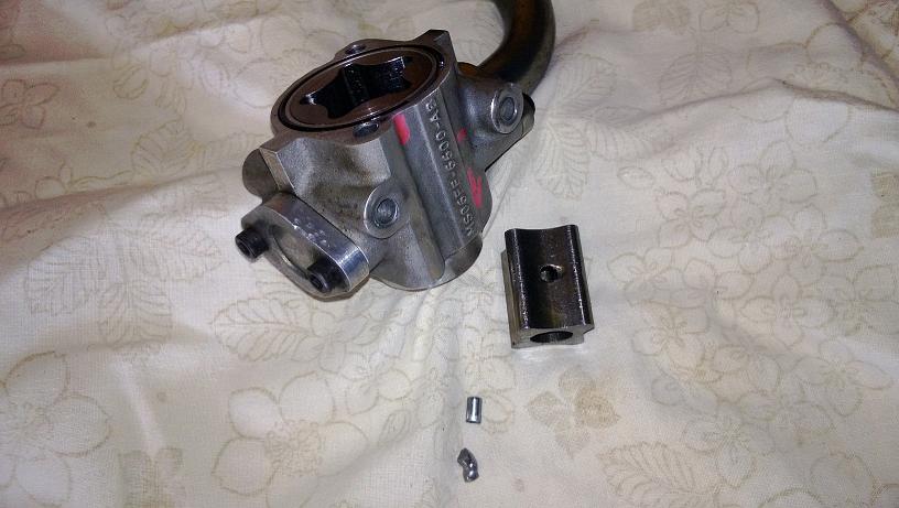

                              There's your problem.
                              Which resulted in this.
                              And in turn to this. Some colors in the oil
                              NOTE TO SELF: Do not reuse the locking pin on the main axle.
                              • Group4_Mark2
                                • 1782
                                That is a seriously messed up looking belt and locking pin.
