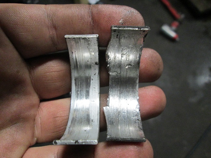

          I took off the sump yesterday. It looks like I got of easy. New big end shells and a polish to the journals is needed. And the new pump naturally.

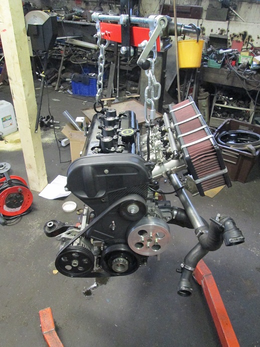

            Engine out again

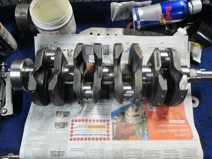

            Mains look good

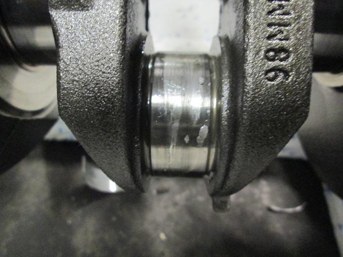

            Crank looks decent too except this no.3 journal. We shall see if this polishes out

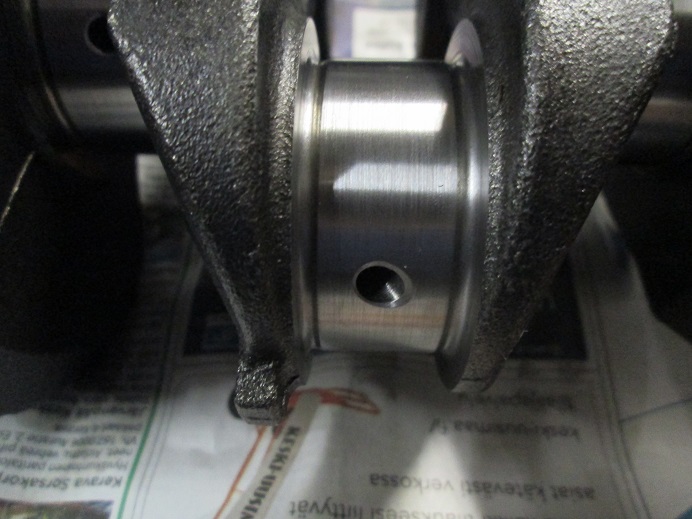

              Now how nice is that. Polished out perfectly and is as straight as an arrow. And the good fellas of the machine shop tear dropped the galleries too.
