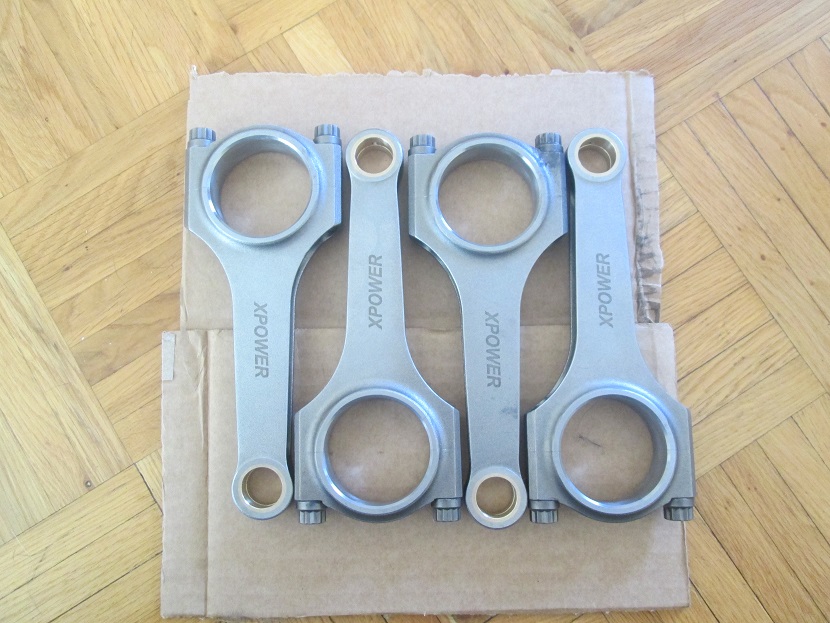

    New cons arrived. Nothing special but looking good.The only obvious improvement is the use of proper size 3/8 bolts. I've always been a bit worried about the 5/16 I had on the previous rods.

      No holding you back now Markus!

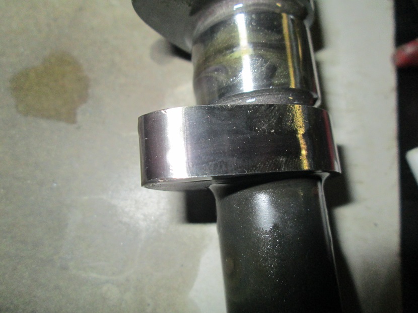

        Today was re assembly day. Two minor hickups. The new rods with the bigger 3/8" bolts were fauling the main ladder. Only minimally though and could be avoided by adjusting the ladder but I chose to take few swings with the file. The other one was the repaired cam. I got a new shim with the fix but I could get no valveclearance. So I now need to get me a new shim and try again tomorrow.
        The fixed cam.

          I've never seen a repaired cam before , have you seen it to be a success?
            Yes. On few Pintos. Theres two ways of repairing a cam. Slightly worn lobe can be regrind but youd end up with a smaller basic circle and need to adjust valve clearances. This may also need re hardening and straightening. More worn lobes need to be filled back up and grind to the correct profile. Usually they need to shave a bit off the basic circle too as the filled metal tends to pull back a bit and the step needs to be evend out. Mine had the latter treatment. The fellar even said the fixed lobe to be harder than the original. The trick of the trade is to do it right so that the filled metal will not come of.

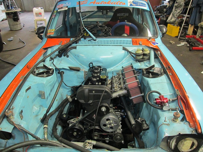

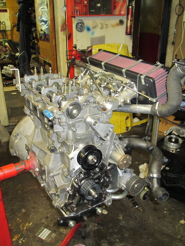

                  A long day in grease pit. Now the valve clearance is set and the engine is fully assembled, timed and sitting in the bay. Still need to hook everything up tomorrow.

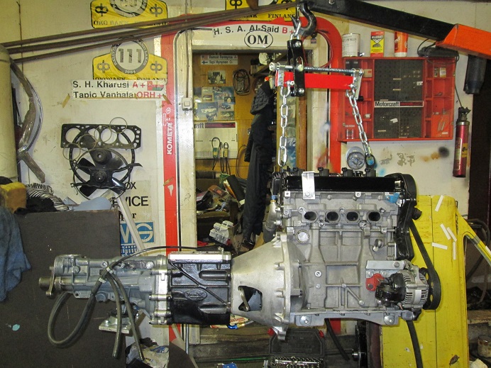

                  Since this was a solo act I bought me this engine tilting device. That was brilliant. A lot of help for 24€

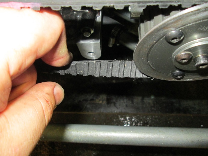

                  Ari the belt does not seem too tight. A bit girly compared to yours though but then again im running a baby block engine.

                    I would consider making a guard for the dry sump belt, just to stop stones and other crap from getting in there, too often I have heard of dry sump belts being pulled off by a stone or similar, makes no sense to me how dry sump kits do not come with a belt guard or at the very least a strong drive belt that is the same strength + size as a timing belt

                      And I've really given thought to protecting the belt but I'm R E A L L Y carefull when it comes protecting/covering something up. If I do it I need to plan it out so that the shiled it self will not cause issues. It has happened to me before... Thing is if something gets in the cover it will never come out but jump around untill it surely snaps the belt. I'm thinking a alloy sheet from the spoiler to the x member... ... should prevent pebles and debree getting into the bay.
                        Yes I believe this is what saves rallycars from loosing dry sump pump belts, the sump guard stops a lot of crap getting in there

                                Engine is now alla hooked up and waiting for some lubricants prior to start up. I also checked the rear axle oil. I had approx a tee spoon of metal flakes in the drain plug
