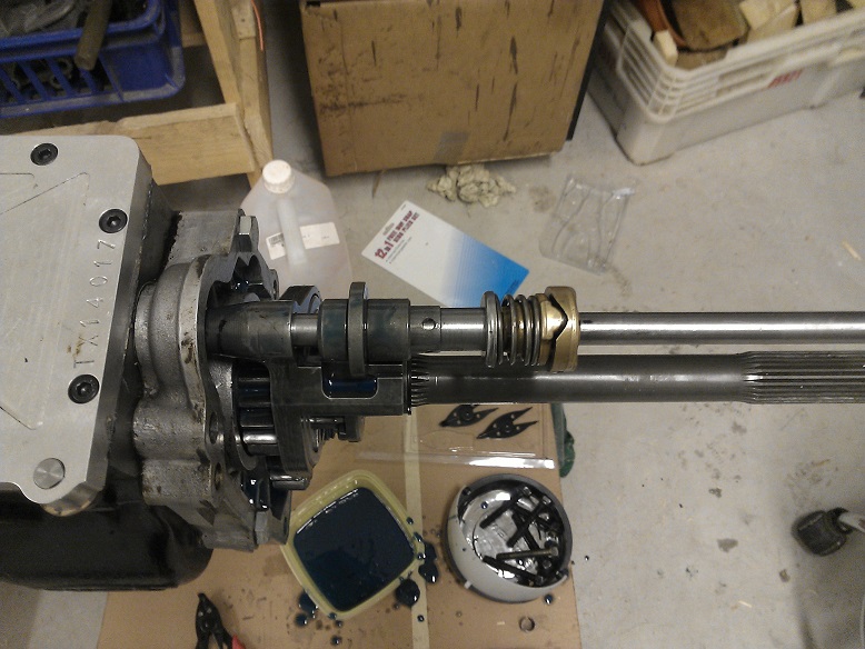

            The SL72 was declared ready but I decided to go back to it. I had a vision the other night and just could not leave it at that.

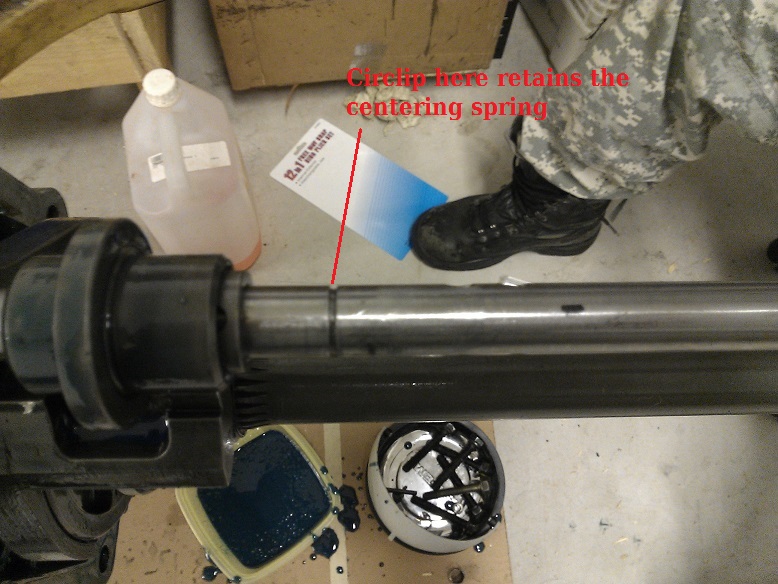

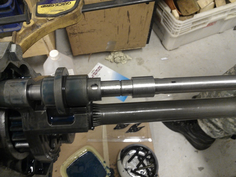

            The original failure in the gearbox was the centering spring retaining circlip jumping off its groove. That lost gears 4 and 3 while downshifting. And the loose bearing balls damaged the fifth gears. In my vision I saw a permanent solution eliminating the possibility of this happening again.
            So yesterday evening I took the tail casing off and removed the centering spring device.

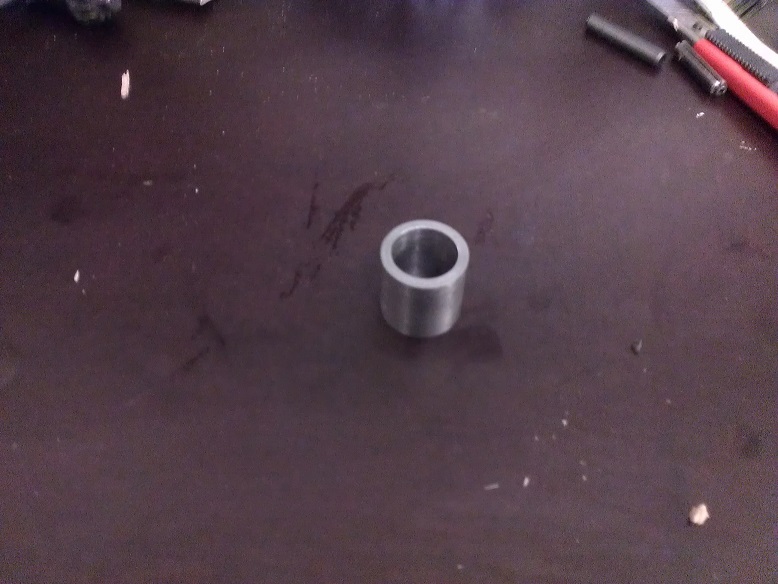

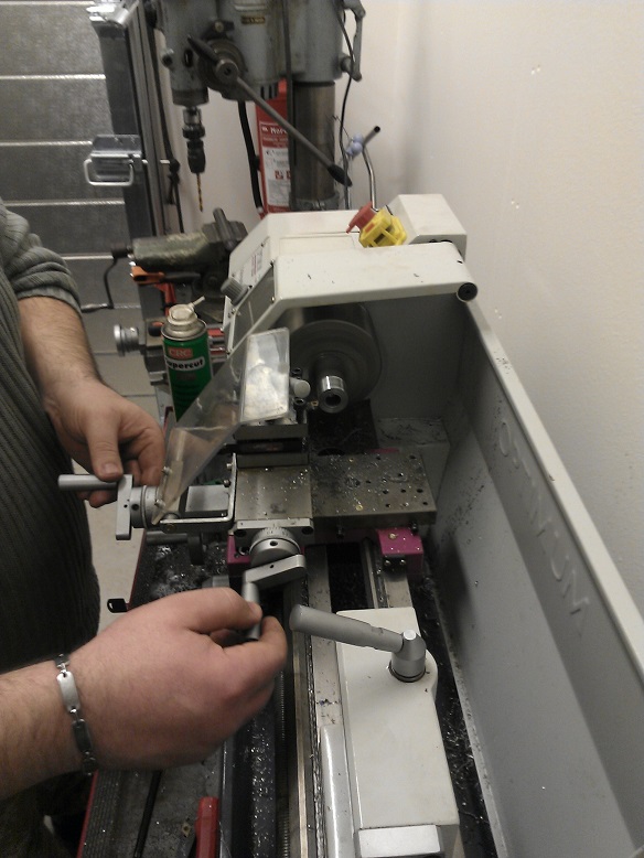

            A mate next door made me a spacer for the shif rail.
            Even I had a go at the mini lathe
            The spacer slides onto the shift rail and stops at the 5th gear selector block witch in turn is retaind by two roll pins.
            The centering spring re assembled. With no circlip. So the circlip will never let me down again.
            So, what do you think a propper cause for a world wide patent eh ?

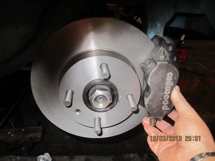

                        Started work on the rear brakes today.

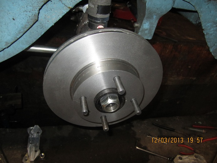

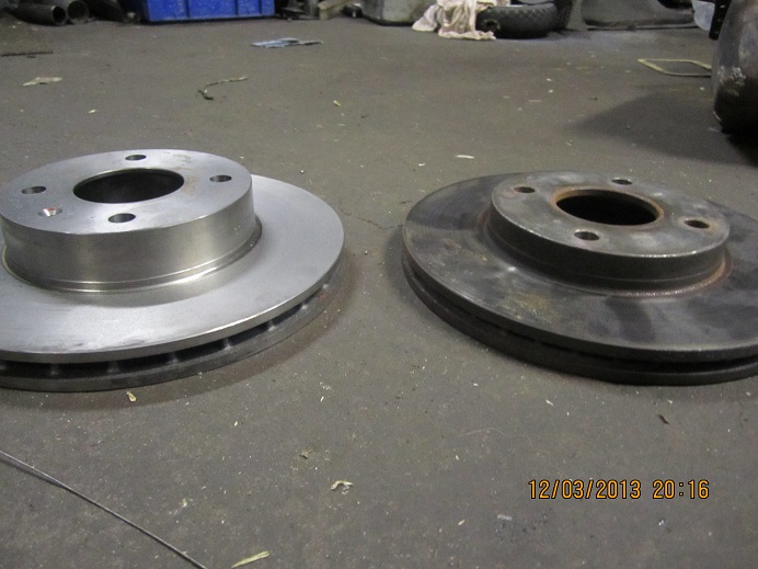

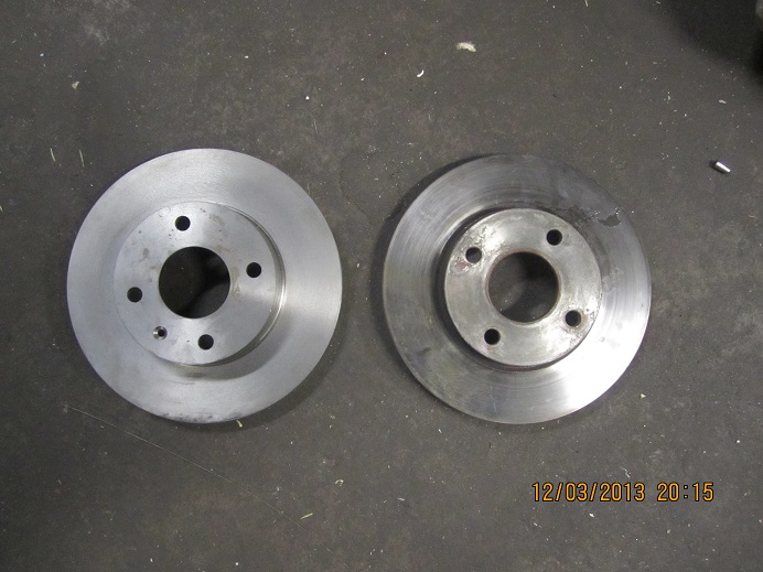

                        The nachine shop did a nice job with the flanges and the RST discs. They ground 1mm off both sides of the disc plus 2mm off from the wheel mounting face. Also the flanges were skimmed down to take the discs.

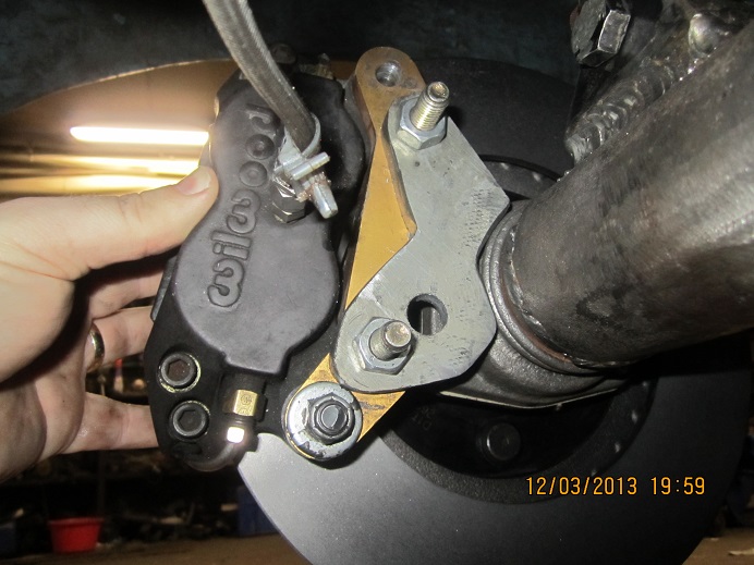

                        This new set up has few minor benefits over the old one. I have 11mm's more caliper to wheel clearance which has been a real issue so far. I now have a smarter caliper mount resulting in faster and easier removal. Skimming of the discs reduced my rear track by 4mm's and I shed 600g's of wight per disc. Thats a total of 1,2kg off the unsprung weight. The std Escort RS turbo disc weighted in at 5,4 kgs the shaved down ones are 4,6 kg's a pop. The Focus mk1 discs are 5,2 kg's each.
                        The adapter is alloy and the bracket is 10 mm steell. Has a true home made look about it as it was manufactured with a cut off disc and an angle grinder Still need to grind some more before welding them on.
                          The brackets did add .3 kg's each so I'm left with an added .600 kg lighter set up than I did last year. Not much but a nice added bonus to all the other minor / secondary improvements.
                            The aforementioned caliper to wheel clearance has been so close I actually had to grind down the Wilwood text to clear the wheel
