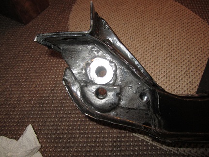

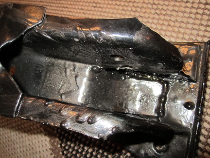

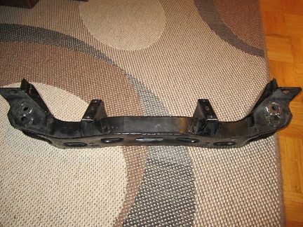

                      Havent got whole lot done lately. Mostly planning. But managed to take some time and modify the x-member.
                      This helps me put the TCA's to the correct angle and maybe even lower the front end a bit. Whitch is pure poison for the steering geometry
                      Nothing new or scientific here. Raised the xmember roof and drilled a new hole for the TCA. Some 25mm higher thn the oe hole.

                        I did that subframe mod (Raising inner pickup points) and it made a noticable improvement to the front end

                          Dont just raise the pick up point move it out, widens the track and or offers more camber opportunity. 25 out 25 up

                            Thanks mate! I hope it will make a difference in my car too.
                              JP
                              Yeah I thought of tht but wanted to keep the pick up point similar in relation to the steering racks pivot point. I believe this helps achieve the neutral behaviour during cornering. If the two arms move in similar way the wheel should not turn more or turn less during cornering. Given that the angles of the two rms are similar.
                              Widening the track is no biggie with adjustable TCA's.
