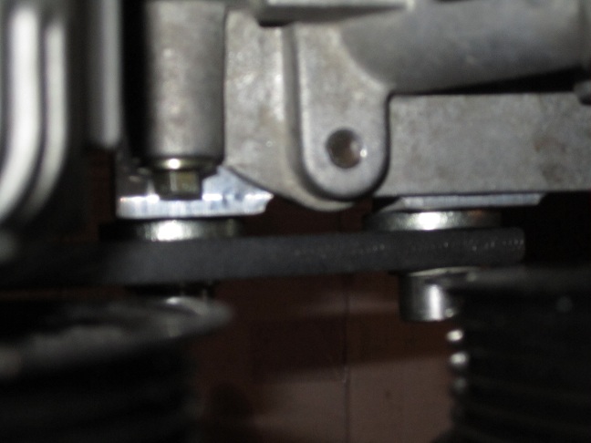

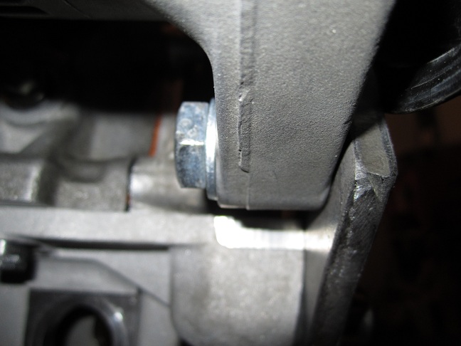

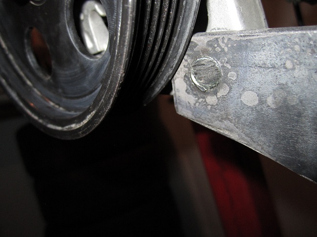

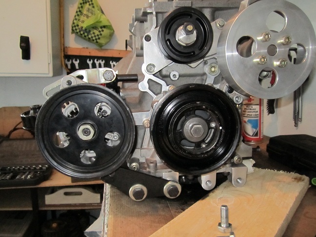

Today I have mostly wrestled with the g*d damn alternator placing issues.
I noticed the bracket I'd done earlier would not work. The alternator belt would faul to the bolt head holding the alternator
The behemoth pulley made it pretty difficult to make a strong enough bracket and to avoid the belt scrubbing to the bolt head.
But after some serous head scratching I think I finally solved this alternator re-positioning issue.

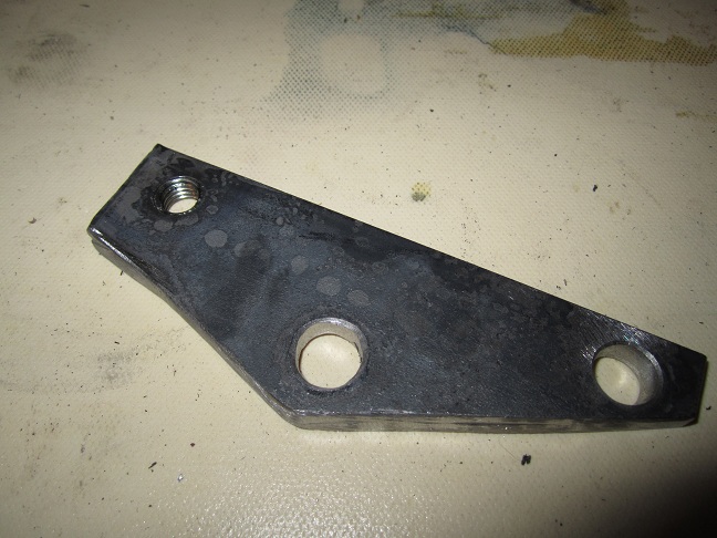

8mm flat iron. It's as thik as I can use here.

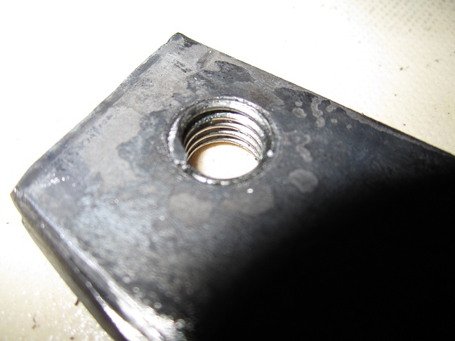

Inserted a Helicoil thread fot the alternator
Bolted the alternator to its bracket from the behing. No bolt head for the belt to rub into.
The pulley is quite close to the bracket.
Then some spacers to get the alignement right
And there you go. The down side to this new position is the belt wrap on the crank pulley. I believe the belt will cower approx third or so of the pulleys circle so hope it will not slip.
Still need to do the adjustmet bar.
And that's all I have to say about the alternator..."Failure is always an option." - Adam SavageComment

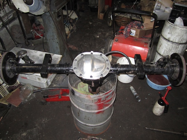

The Truetrac lsd is now fitted. No pics of the actual process. The work was done by my old man. A long retired mechanic who now passes time building up Historic racing cars. He really has an eye for setting up CWP. Which I lack.
Now it needs to be bent and painted before re installing it.
Heres the axle. A Mustang -94 7.5" rear end. Shortend to english lenght and fitted with billet Ford 9" housing ends and custom made drive shafts to take the Atlas GP1 flanges and the 9" wheel bearings. Fitted with Richmond 5,13:1 CWP
It was somewhat justified with the very torquey Pinto but now feels a bit of an overkill. Works like a treat though and gives very nice feel to the rear brakes due to big enough wheel bearings. No soft pedal at first push at all.

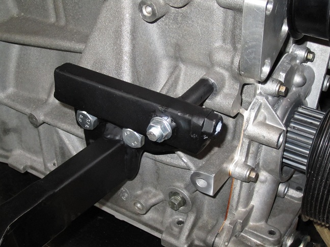

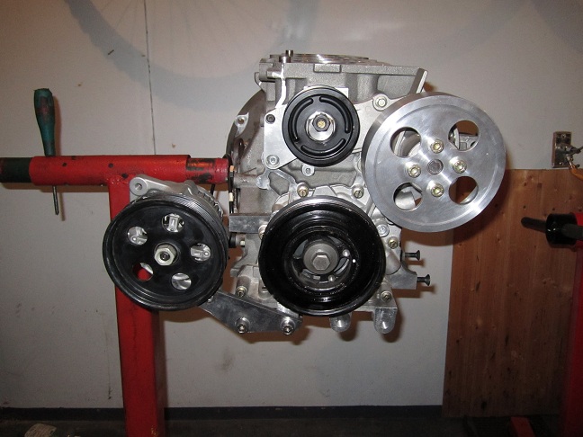

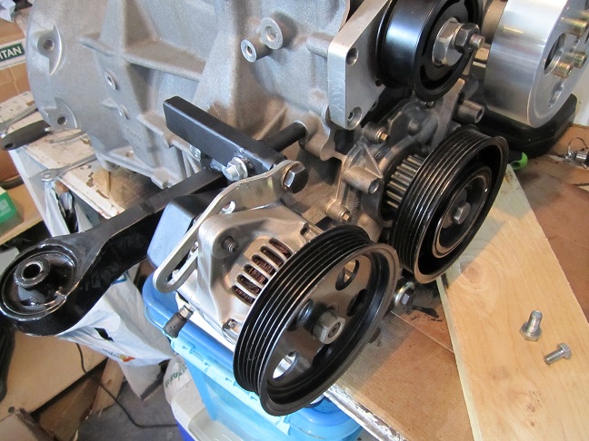

Finished the Alternator brackets today. Atleast its now sorted and Im happy with it. It sits MUCH lower now and on a more favourable side of the engine. And makes for a easier removal of the aux belt. And gives more room to work on the throttle body side.

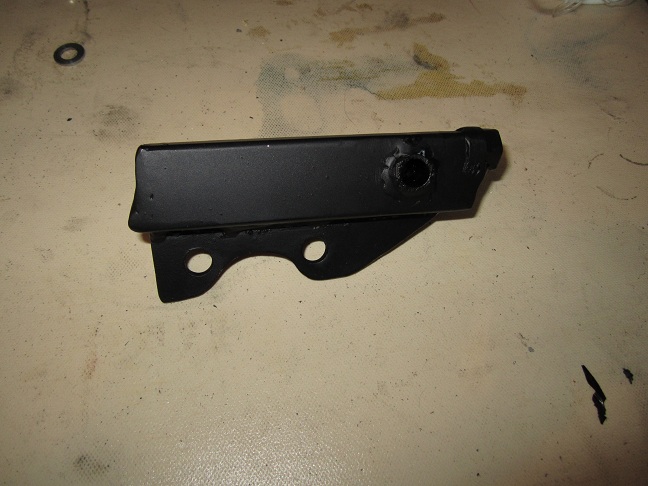

The upper bracket. HAd some hard time figuring out how to make a sturdy mounting point for the tensioner bar.
Here mounted on the block
And fitted with the alternator. It sure feels solid enough and if this won't hold then I guess ot'll come off....
I reckon it has a nice travel too for easy belt install.

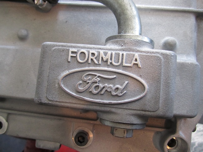

As I said I have too too much time (when the missus is not keeping me busy) so I decided to copycat some of the nice rocker covers I've seen here. Only this is the oil sump so no one will bee watching it. Except the scruteneers.
