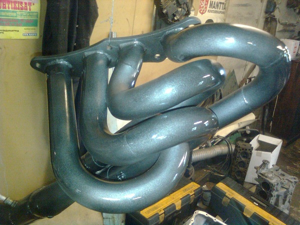

    The manifold is now modified and needs to be taken back to the welder to be finished. Then its only a matter of manufacturinc the adaptor pipe between the new manifold and old exhaust pipe so that I could easily try both manifolds on the rollers.

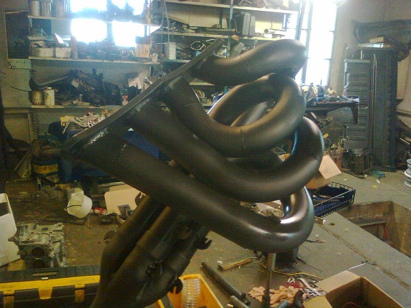

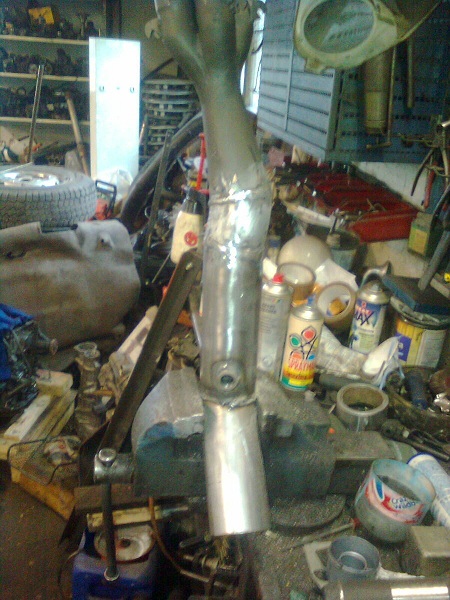

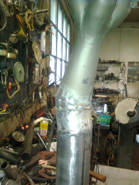

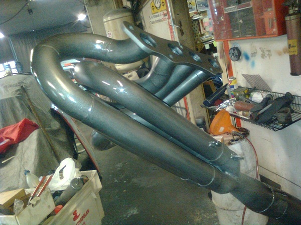

                          Today was the final chapter in making the new manifold. And all did not end well. The manfold had some fitting issues which I hoped would be cured when welding the pipes to the manifold. Well they didn't. In the matter od´f fact after welding the manifold did not sit in the bay at all. The collector was scrubbing the floor badly so no hope of fitting the rest of the exhaust system.
                          I had to shorten the straight 3"bit of the collector (well part of the exhaus pipe really) and make a hidious kink to the ehaust to steer clear from the co drivers floor. At this point I'm happy I've chose an 3" exhaus so hopefully the kink in a big bore exhaust would not mess the flow too much. Not happy with it but thats the only way I can make it fit. The only way I can get to the rollers in time...to the grid in time...Not happy with it.
                          On a bright side I've got me a finished manifold now and as the pant drys I can fit it and move on with the build .
                          So hopefully tomorrow I can start the engne up.Just need to make the grounding wire and pour in the fluids.

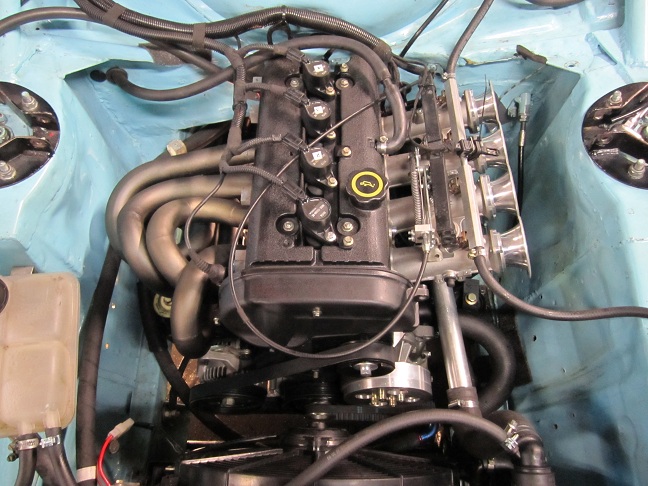

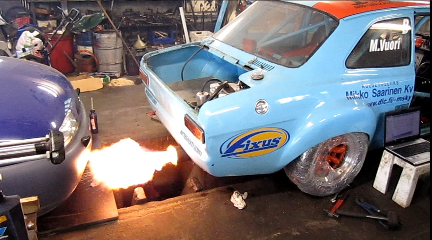

                            Shes alive. Fired right up and ran super smooth.
                            Todays issues were mainly with oil leaks. I did the new remote oil filter hoses all wrong they fittings were all leaking. Had to remove the hoses and re do the fttings.
                            The other leak was from the new cam cover. I thought it sealed nice. It turned out it did seal ok but the oil was leaking trought the cam cover bolt holes that are meant for the cover that is supposed to be used with this head. The holes were neatly inside the new cover but I had no idea they were clean trough the head. So had to plug 5 more m6 holes to stop the oil leaking.
                            I believe the engine is pretty much ready for the rollers. Which I postponed to 1st of may due to some work related issues.
                            Popped a little flame too.

                                I don't think the owner of that Fiesta is going to be too happy
                                Glad you got it running OK, good luck on the rollers
