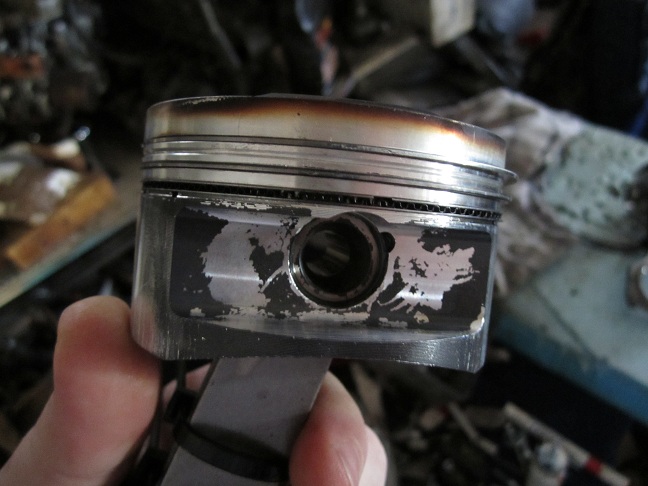

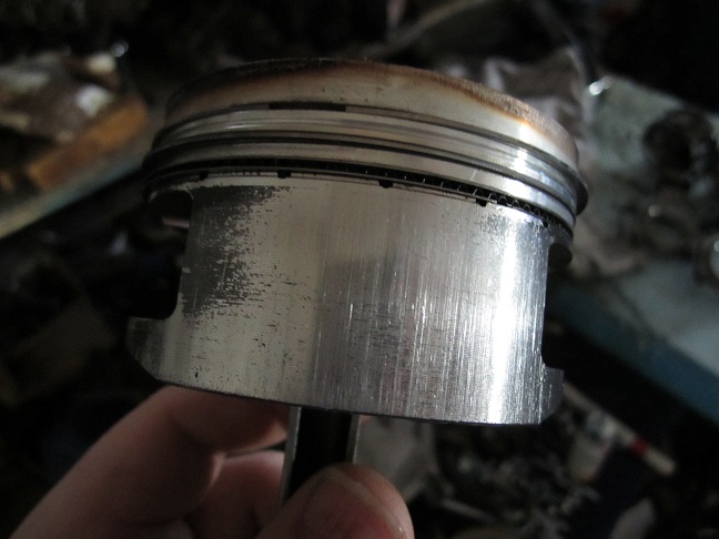

        Dismanteled the bottom end to see the state of the shells and see what caused the marks in the cylinder walls.
        Well the high end teflon coating is all but gone from the piston skirts. And there are similar marks in the pistons. So I believe it's piston slap that is causing these gazes.
        Propapbly due to having the wrist pin in the middle of the piston.
        Is there a way to avoid these markings? Or do I just need to live with it.
        Obviously the teflon did not do the trick. Would imroving the bore lubrication work?

          No obvious reason what caused them was not found. But talking to some people convinced me its not due to oil starvation.
          Some say they could've been caused in the original start up due to engine beeing cold some say overheating... I say I don't know. It has not overheated that I know of. So we'll see. The machine shop fella said it could even be the teflon coating that chipped away that did it. So no drastic changes are done to the bottom end. Even the bearings are good to go.

          Here are the pistons after only two dyno sessions and one race weekend. You can chip the coating with a nail.

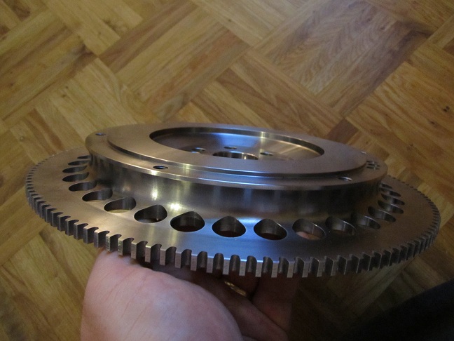

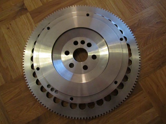

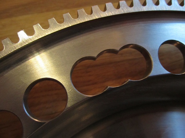

          Another new thing is a lighter flywheel. The old one was 4,5kg's and this one is 3,3kg's so so hopefully I'll see more revs at the end of the main straights. Also I'll need to order a new prop shaft. I needed to use a 40mm thick mild steel spacer and it is rather heavy.
          Replacing that with the correct lenght prop I reckon I'll save a good 0,5-1 kg there. So propably 2 kgs off the power train weight.

              the piston just looks to me like its just picked up grit from honing
                You posted the fifth hudreth post on my thread.
                May well be. The slight similar markings in the big end and main bearings suggest the same. Hopefully I've seen the last of this kind of markins.

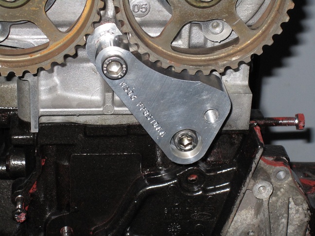

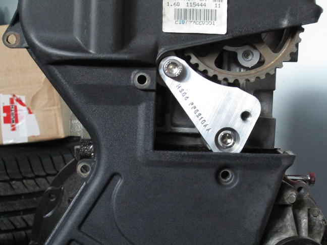

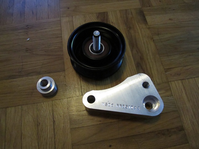

                    Did some tinkering today. I really enjoy doing little things like this while waiting for the bigger parts to arrive. As I am changing the alternators position I need to install an idler pulley in the face of the engine.
                    This means I need to get rid of the engines original engine mount.
                    M-sport to rescue.
                    Offering the bracket to an "customer" engine

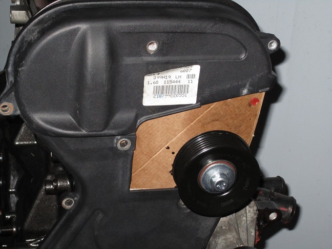

                    Now with the belt cover on

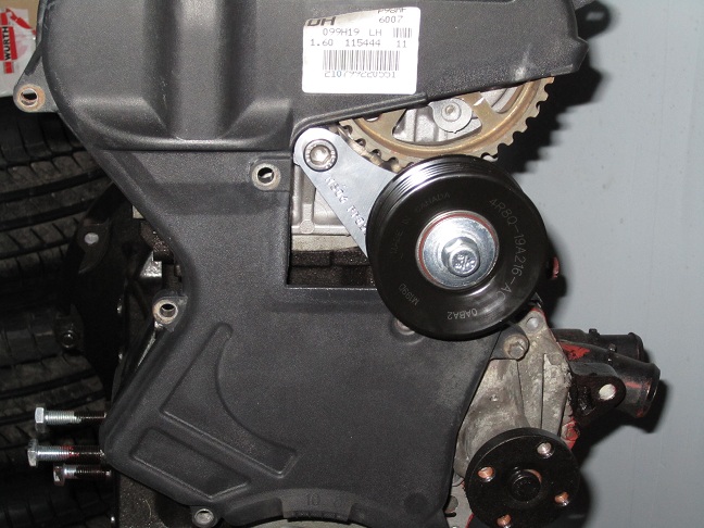

                    And with the pulley
                    Seems to work fine, only now I have a huge gap for debree and stones to violate my cam belt

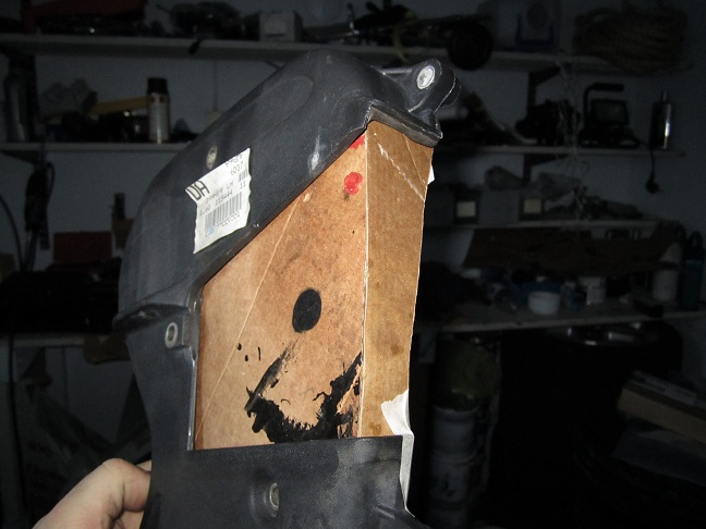

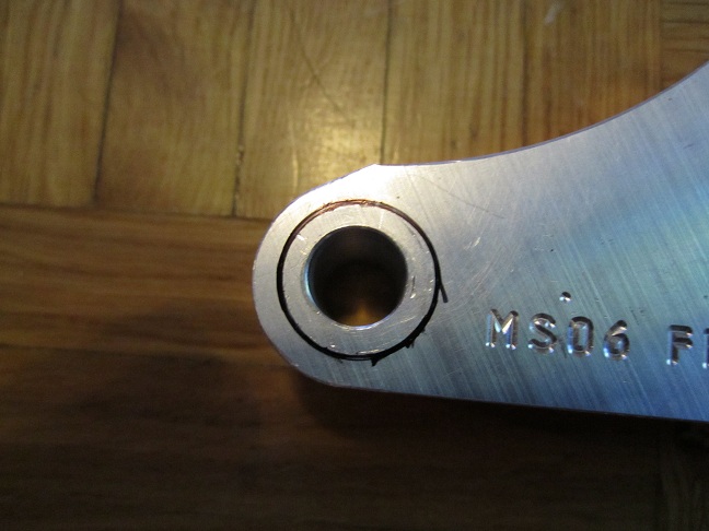

                    I need to modify the Bracket a bit. Deed to mill the upper bolt hole partially bigger to get the bolt head flush with the bracket. Do you think it can be done or are the walls too thin?
                    Once the bolt is flush with the bracket its quite straight forward to fill in the gaps.
                    Just need to replace the cardboard with a carbon sheet left from the airbox project to get the nice look I value so much

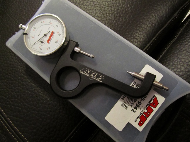

                    Tomorrow I should get my ARP bolts and the bolt strech gauge. As I pick them up I'll drop the bottom end parts for re-ballancing due to new lighter flywheel.
                      Picked up the ARP 3.5 con rod bolt today. Also got my bolt strech gauge, or a measurement gauge as my daughter called it, today. While I was on a move I dropped of the bottom end parts to be re-ballanced with the new flywheel.
