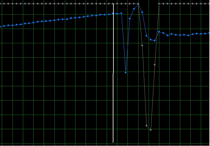

            Back to the paddock for some serious head scratching. I read the datalogger to see what was going on during the missed beats. I found this
            Grey line is throttle blue is RPM
            the rpm dropped massively alltough the throttle was wide open then in a heart beat the revs were back up. Something was messing up the RPM signal.The sudden dive of the throttle line is due to a gear change. This beeing an Zetec SE I figured the engine had developed too much end float which started something at the 8000rpm mark to mess the signal. Lifted the car on jack stands and DTI'd the crank. 0,3mm of end float. No where near to cause any disturbance to the signal. I was clueless. It could not be a dodgy wire or a dodgy sensor since it only did it at 8000rpm mark.
