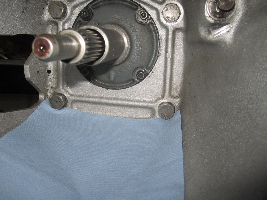

    I bought my box new and it has leaked since day one. It wasn't rebuilt by Tran-X. I've only tried to have the leaks fixed by some local "specialists". Now having battled it my self it seems to hold its liquire. Had to try three times to get it right though. This SL 72 design is somewhat odd or something has gone wrong when it was assembled. But no point complaining now that the warranty is long gone and the manufacturer is out of business. Anyway now its fixed for the season and I'll know more when I dsmantle the box after the season.

      Look how dry it is. Not a drop (and yes there is oil in the box)
      No leakage here eighter just dry dry dry...

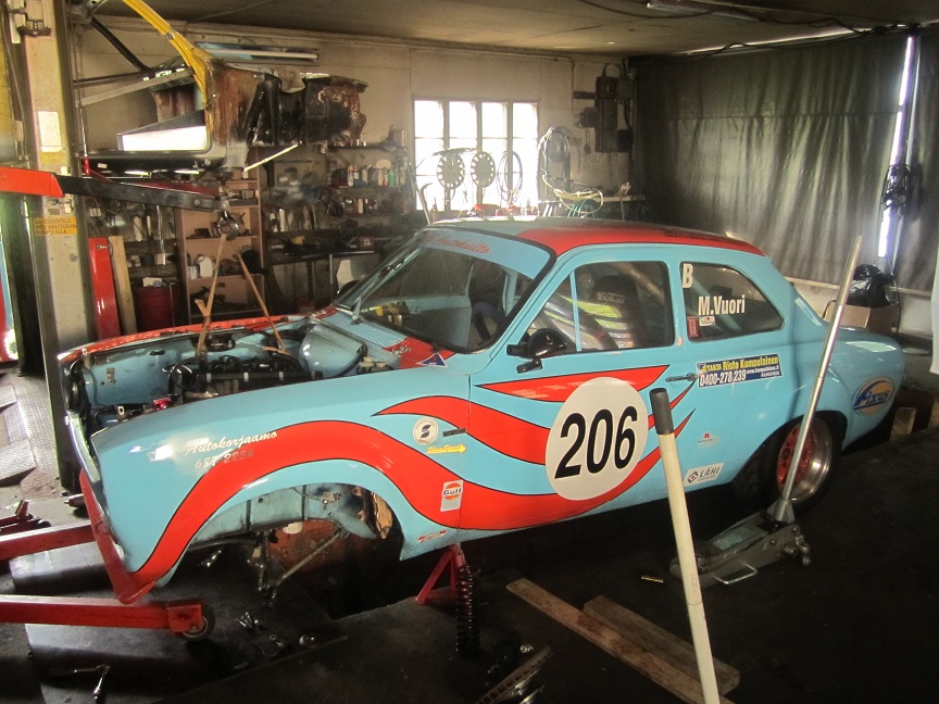

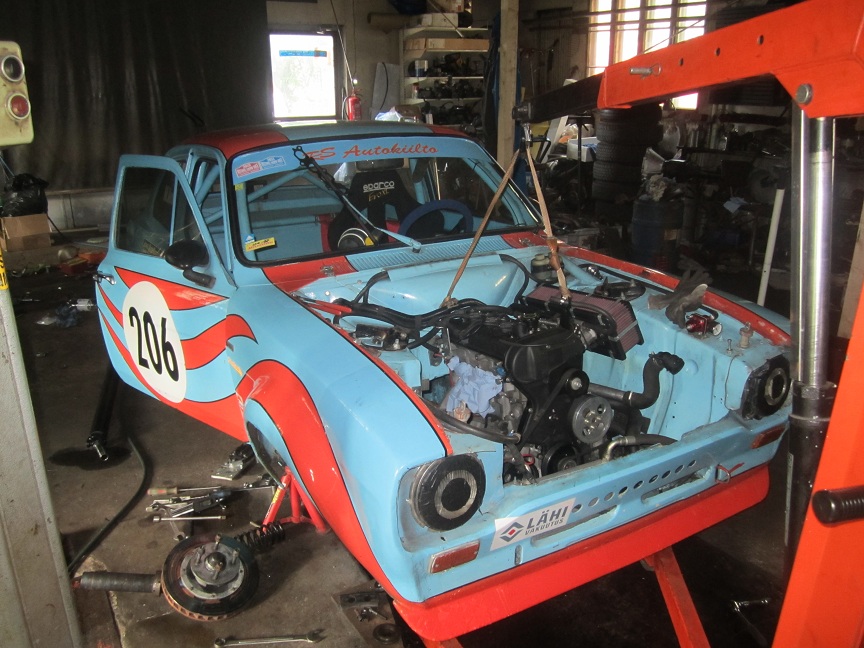

      Engine needs to be suspended in order to get the box out
      This little thing dropped to the floor once I undid the engine mount bolt.

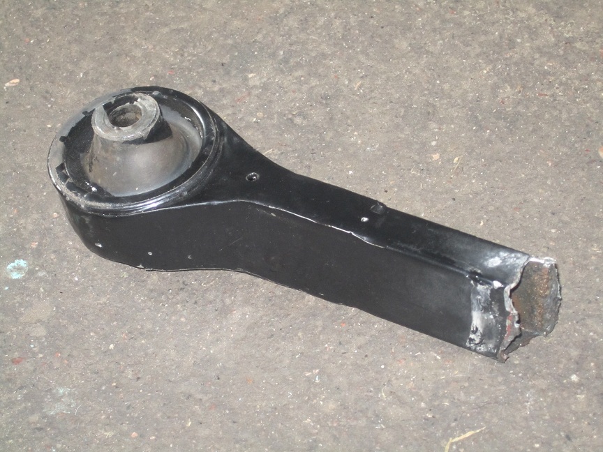

        Good news on the box
        Materials used for the engine mount look a bit to thin, was the plate gussetted to the box section either?
          #964
          Yes and no.
          I'm pretty sure the next version will be thicker and gusseted. I believ I got off lucky. Only a tiny mark in the sump. It could have been A LOT worse.
            #965
            Yes and no.

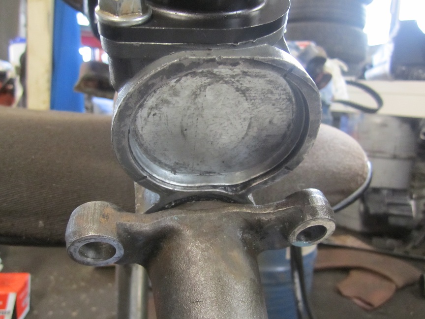

            Well that was not the case. The reasion for the failure was my poor welding. The other weld on the long side had no penetration at all and the other could not take the strain. We simply re welded the engine mount propperly this time. No thicker tubing, no gussets, oozing with confidence that it will hold.

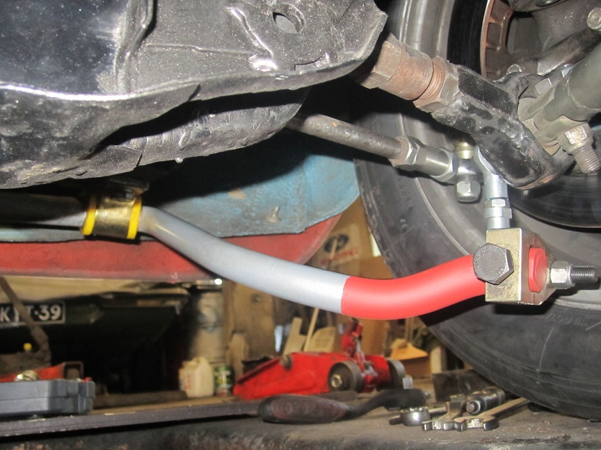

            The new ARB was an inch narrower than the one I had so it could't just slip above the TCA's like the old one did but needed to be installed below. Whitch is not ideal since the drop links I have require alot of room. The installation isn't all done yet but i gathered the concept will work and only requires some minimal grinding and cutting work.

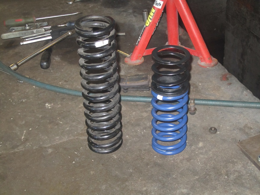

            New set of front springs
            Sneak peak of the new arb.
            The nose sat somewhat two centimeters higher whith the new springs and strangely enough felt softer than before. It got me thinking have I been bottoming out my front shocks all these years with virtually no inward suspension at all. Remains to be seen when I drop the nose to its usual height.
            Would be strange to suffer from excess body roll with solid bottomed out front end. As I said strange. Or maybe the new spings need to be compressed for a while I dont know. Time will tell. Hopefully more tomorrow.

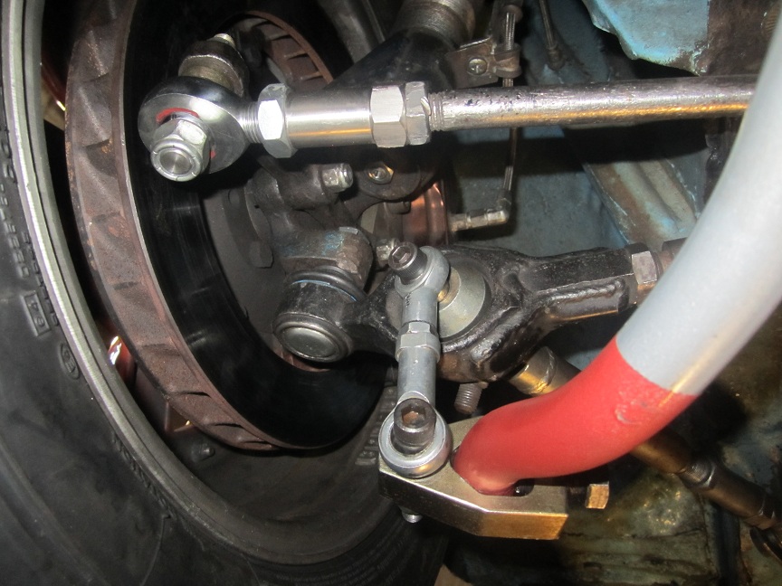

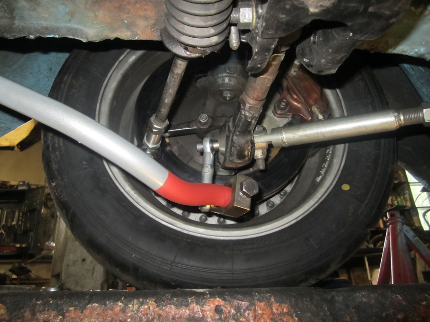

                OK Front suspension mods all done now. And looks ok to me. It seems firm yet has some flex. For some ODD reason the previous set up was on softer springs but still felt nearly rock hard and even so had body roll issues. Quite eager to find out how this feels.
                So as usual I took some pics if someone is interrested in similar mods.

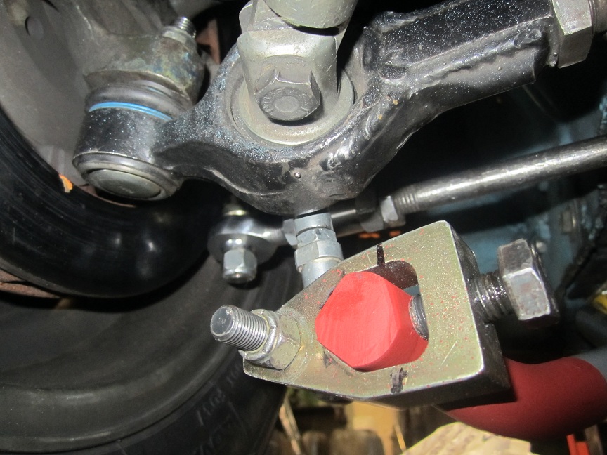

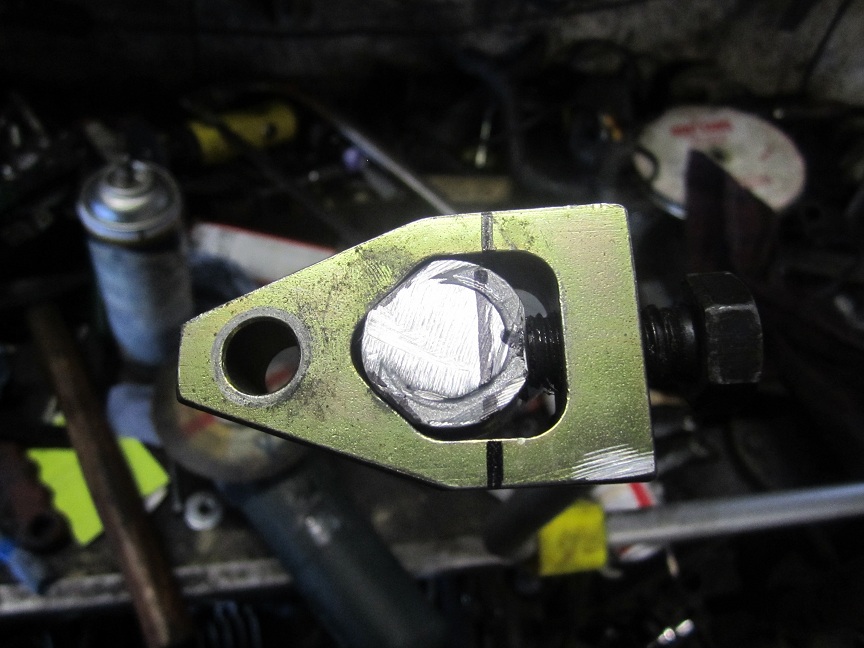

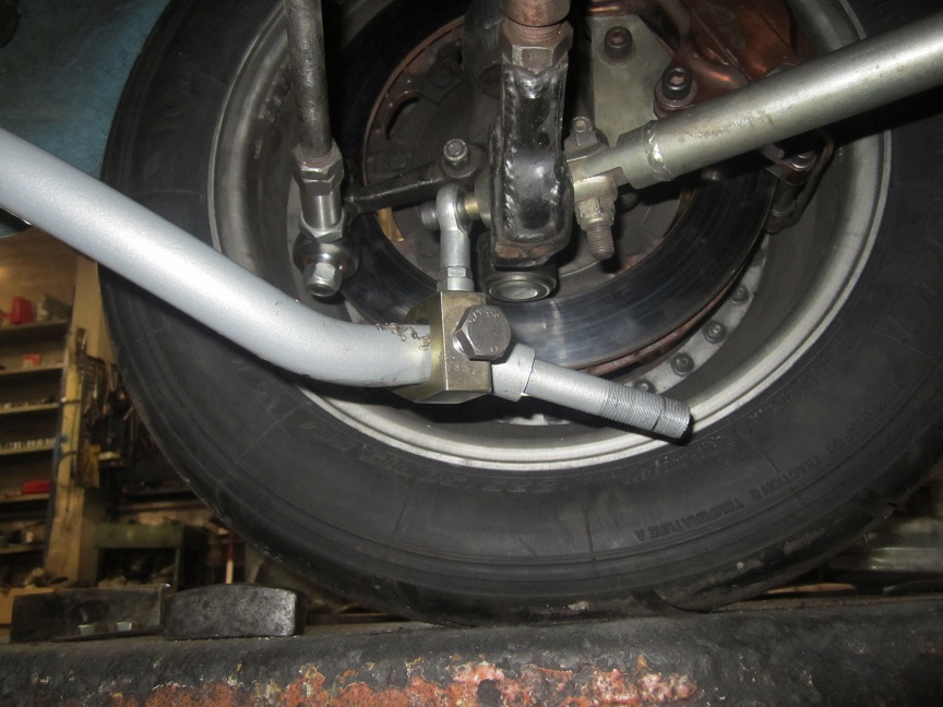

                I used the Burtons drop link kit. The drop link bracket had a trianglular hole in it. So to make sure the bracket will not rotate on the sway bar rather than push down on it I made three flat spots to match.
                See? Will not slip.

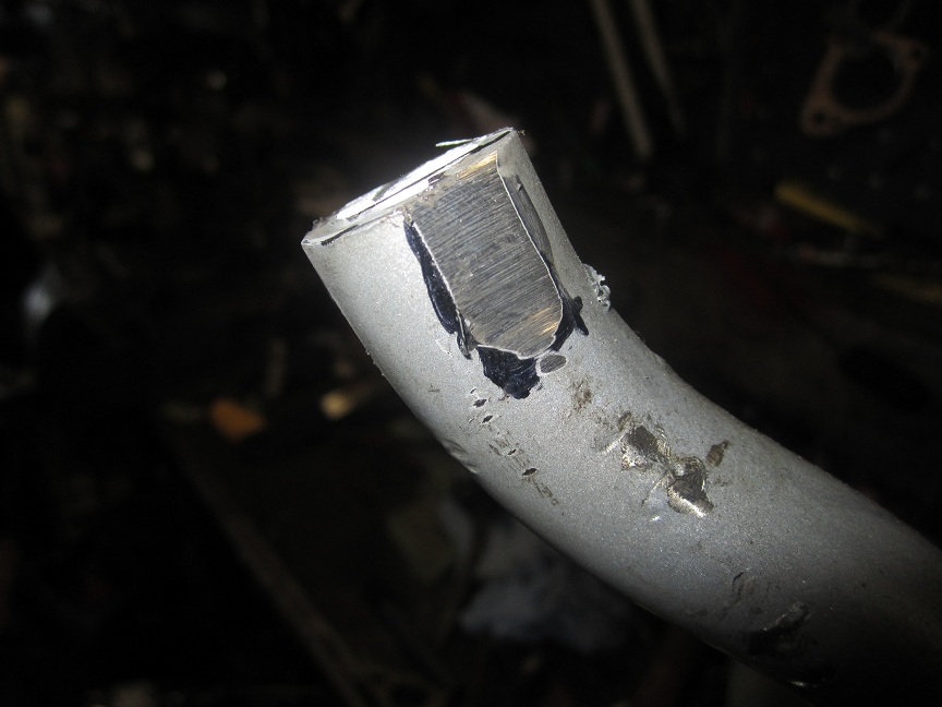

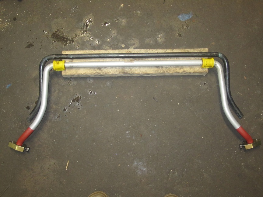

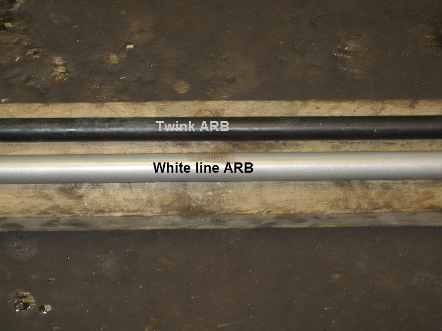

                Comparing the old and new
                The Whiteline one was narrower. Whicth makes it a bit lighter but as said earlier will not slip above the TCA's
                ARB connecting rods were bit of a compromise. In a perfect world they could have been shorter but for now I only had female uball rod ends at hand.
