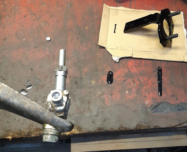

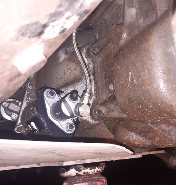

                Onto the hydraulic clutch conversion - I should have done this years ago, but have managed with a cable coming through the bulkhead about 2 inches nearer the tunnel than standard (with a bracket on the clutch pedal to match) and that meant the cable was routed between the block and the exhaust manifold, and I would fit a new clutch cable whenever it started to get stiff. The last cable wasn't that old and didn't actually break, but the outer section had pulled through the top plastic section.

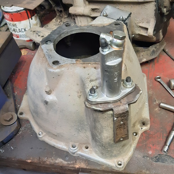

                I decided to use an external slave cylinder from a landrover and had a good look at Dan Stone's Mk2 which has a similar set up. The slave cylinder was going to be fitted on the passenger side to keep it away from the exhaust. The pedal box end was simple enough as the very old Gartrac pedal box already had the mount for a clutch master cylinder. I used a 0.625" Girling cylinder from my spares and welded a bit of 10mm metal strip to the top of the clutch pedal to line up with it.

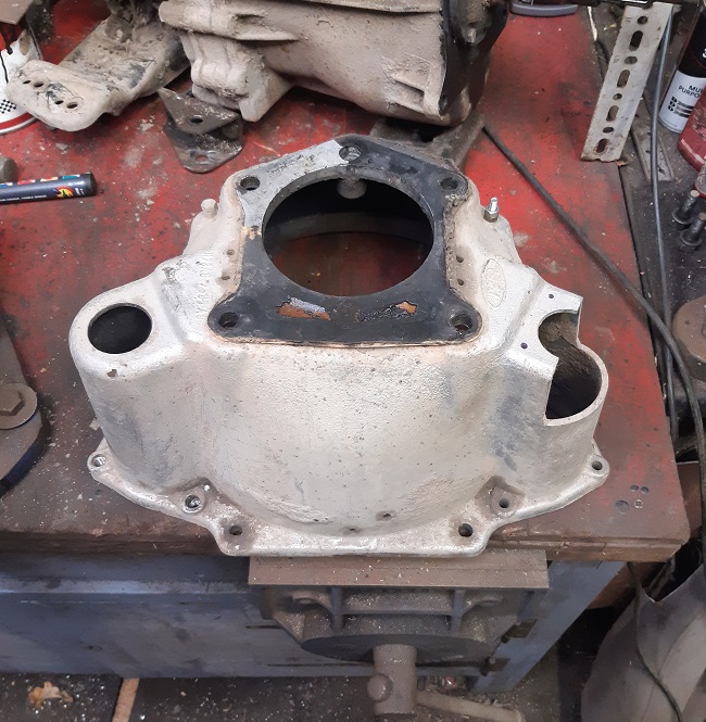

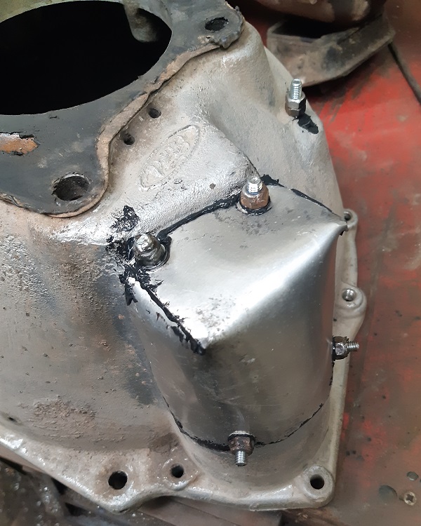

                Ally bellhousing - I cut one side a few years ago to make fitting clutch cables easier but I know mud sometimes gets in there so I covered the hole with some alloy plate.

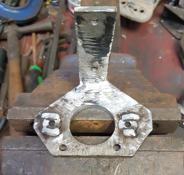

                Bracket made from 6mm plate with countersunk M8 bolts to make studs.
                Mocked up on the bench
                M10 Clevis bolted to a std clutch release arm and a 5/16 UNF rose joint on a cut down bolt to make the push rod for the slave cylinder. Everything was lockwired before putting it together

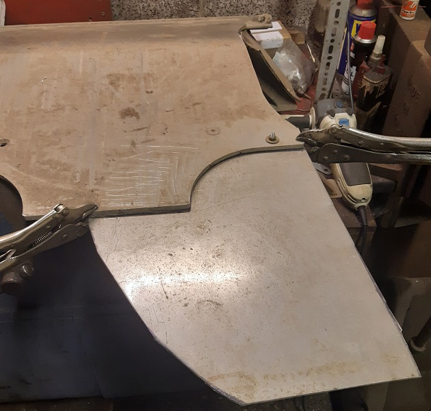

                I even made a "sump guard extension" from some 4mm ally sheet - the front was attached to the sump guard with M10 countersunk bolts, and the rear was bolted through the passenger footwell

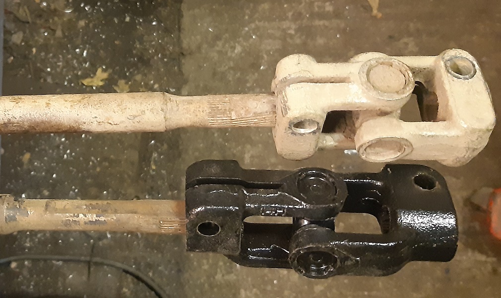

                My other job for the winter was to swap the steering column as the splines had twisted at some point during the last few events - I spotted it before the Bustard but didn't have time to change it.
                Unfortunately the only spare I had was the shorter version of a Mk2 column, so I bought a long Gp4 steering coupling which is supposed to make up the difference.
                The silly thing is that the shorter type of columns are 30mm shorter, but the longer Gp4 coupling is only 20mm longer And I have a lowered rack mount!
                Anyway, I got it fitted with the steering wheel 10mm closer to the dashboard, and moved the stalks down the column by 10mm too.
                If anyone has a spare "long" steering column, then I'd be interested in it.
                I tried the hydraulic clutch on a Test Day at Smeatharpe Airfield in January - the pedal is definitely lighter than with a cable but it needed a bit more bleeding and some adjustment at both ends. I've also made a pedal stop by welding a nut underneath the clutch pedal (a couple of inches from the bottom) and fitted a bolt and locknut so I can stop the pedal going too far and possibly damaging something. I'm going to drive her around a bit more then I'll be happy it's set up ok
