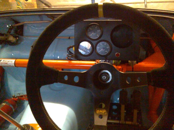

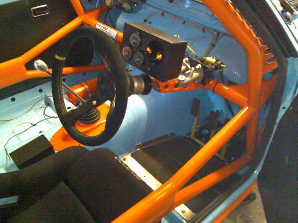

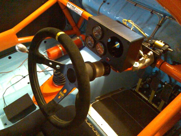

            One or two updates this weekend, I've been making my dash panel to hold all the main gauges and warning lights and Andy has been busy making the all new wiring loom (pics to follow once its layed in the car again). Loom is nearly complete, just some plugs and a bit more loom tape. Then Andy can start on the stand alone ecu loom which we have the diagrams to already
            Anyways, back to the dash... well its somewhat lighter than the origional metal escort dashboard that was cut out It is mounted off of the big 3/4" rosejoint for the steering column.
            All I have to do is fit the oil light to one side and a shift light next to the ignition one. Oh and buy an 80mm Elliot revcounter in the week.
            As you can see all gauges will be perfectly visible through the wheel
            Black box behind gear lever is for all of the switches, relays, fuses and start button;
            Big thanks to Andy for making up the loom double quick today

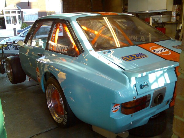

                            Little update from the painters though, should be collecting this as soon as the stripes are finished
                            • Jon
                              TS Supporter/snapper
                              • 1567
                              That looks good....

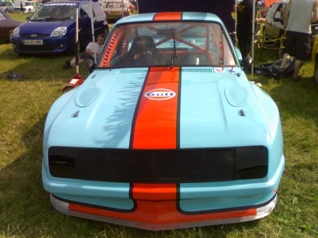

                                Heres two pics i took on my phone at the retro cars show. i thought you might like
