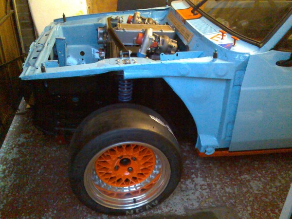

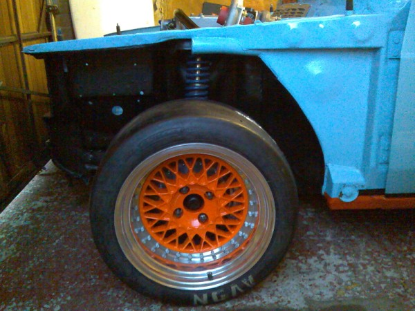

                        Couple of phone pics today,
                        got my brakes all on and the 16's clear them nicely , just a pity you cant see the brakes through the BBS centres

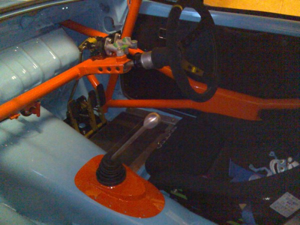

                        Put the gear stick surround back in the car, and yes we are trying to save the blue paint for other things
